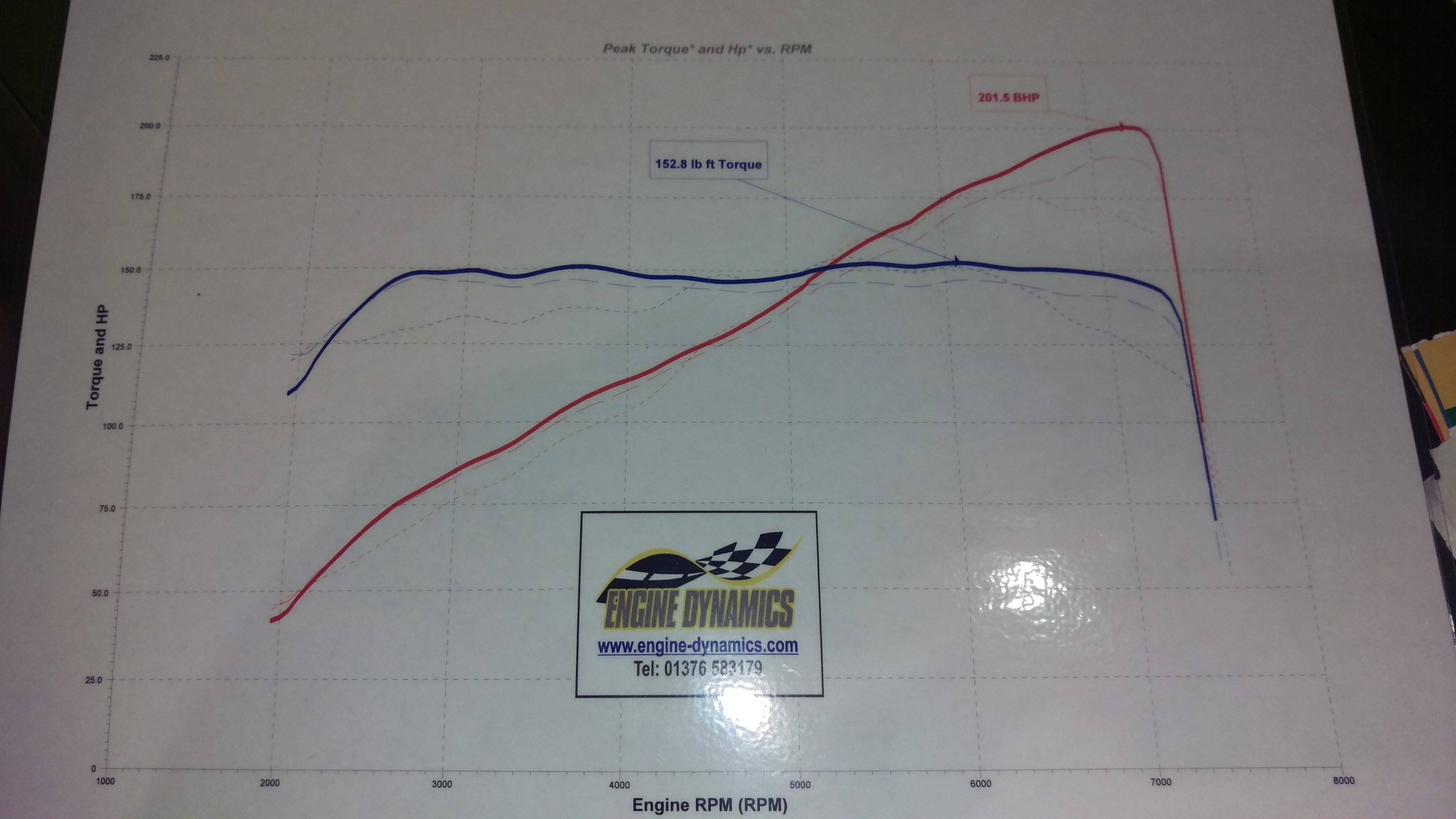

For reference, my 182 is making 201.5bhp with the following: SM Inlet, 197 cams, ramair filter, RS192 exhaust, de-restricted CAT, Engine Dynamics custom remap.
The dyno graph shows 3 lines with basic supporting mods; Lowest run at 179bhp with supporting mods and rstuner map, middle run at 190bhp with previous + SM Inlet, Best run at 201.5bhp with previous and 197 cams.
Was pretty pleased with the outcome! Especially considering Andy at Engine Dynamics said it had originally been a little down on power with the mods and rstuner.

Great result, Engine dynamics rollers seem to be quite accurate aswell from my experience, no wild torque figures or anything. I knew this setup could crack 200 bhp, it did a long time ago on the 197 cams + RS2 inlet. Seems the RS2 / SM inlets dont seem to want to cooperate with 438 cams a bit like how ITB's never really liked the 438 cams either hence why 421's were a big trend with ITB's as they made the power.
I bet if you stuck arp rod bolts and raised the limiter to 8k rpm you could almost see 210 bhp on that setup.

@Aydon182 I think you're right, and it would really benefit from the extra 500rpm, but engine longevity would be a worry at 8k rpm for me. Its on 102k miles at the moment. Should it go bang, then yes, I'll definitely be uprating bits!

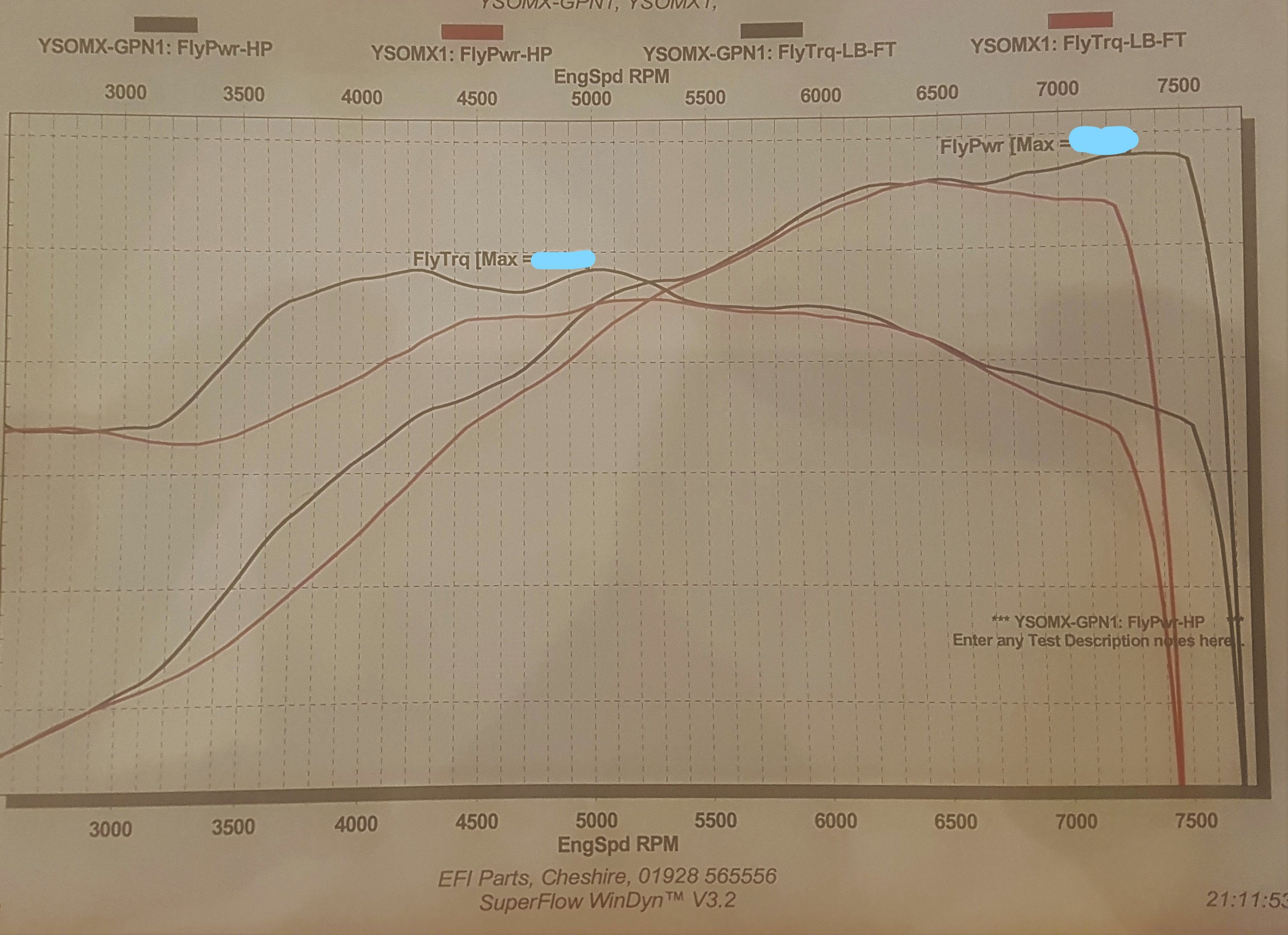

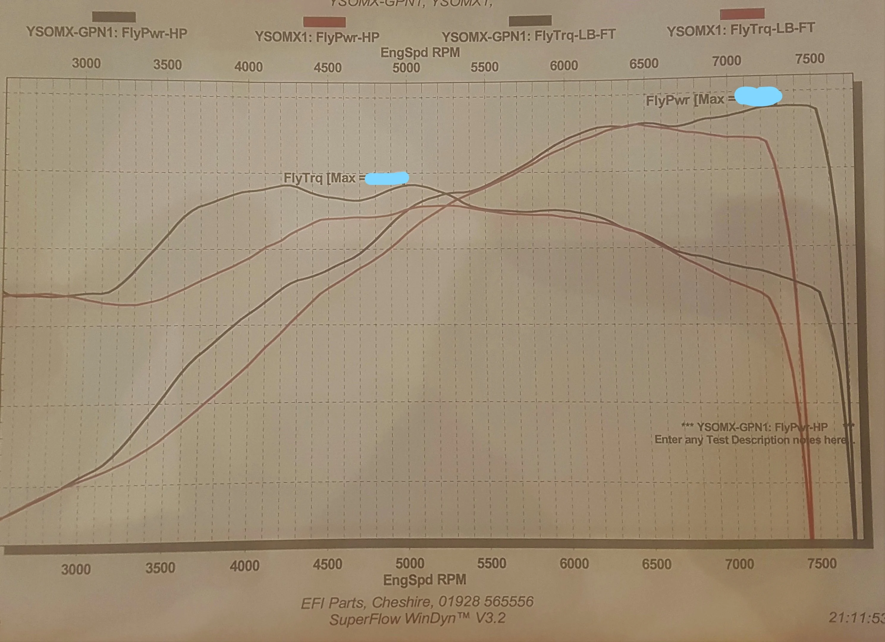

don't know if you've seen the thread but just had a 172 on normal inlets done on group n timing, before and after graph speaks for itself.
