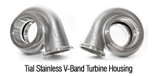

Yes a custum one, like those but with V-Band fixing, I take a Tial turbine housing :
For the turbo I've make my choice, it 's gonna be a GT2871R with A/R 86 for a better response, I d'ont want to big.
