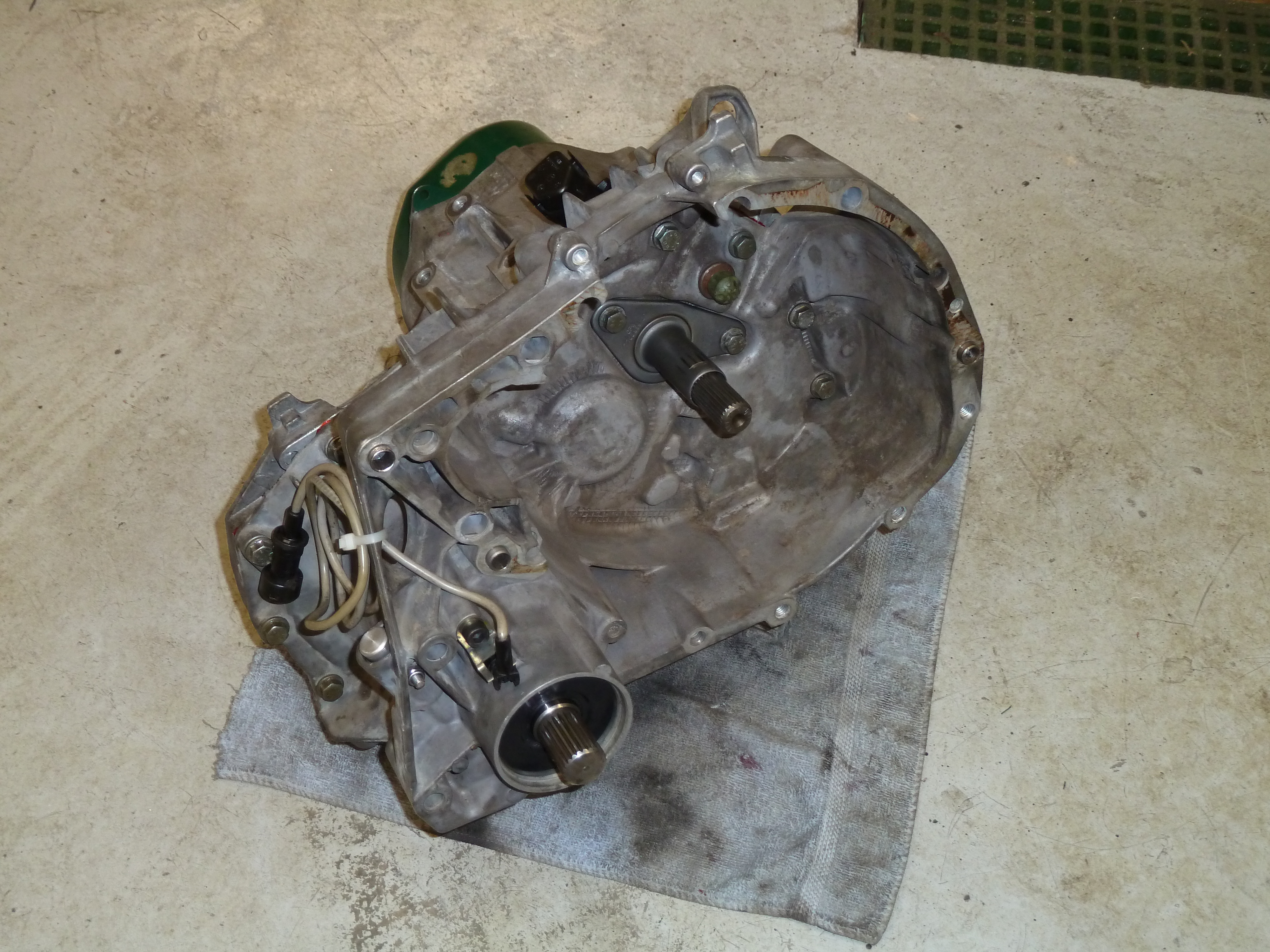

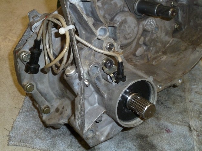

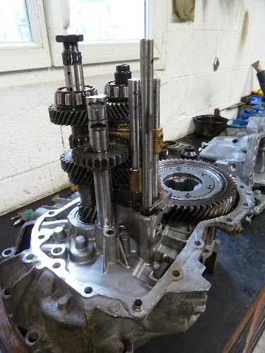

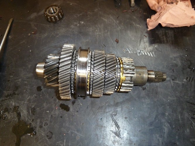

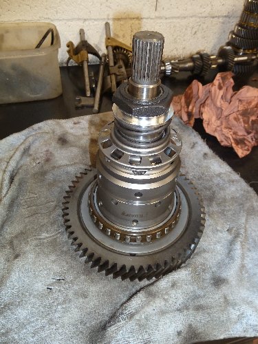

And Escort Cosworth differential rebuilt with shorter gear.
Front : Quaife, 3.92, 4mm plate & 6mm stud.
Rear : 3.92 with alloy mount.
With the 3.92, fixit gear box, high rev and 18" it give's me
73,3km/h
111,4km/h
165,9km/h
220,6km/h
283,2km/h
