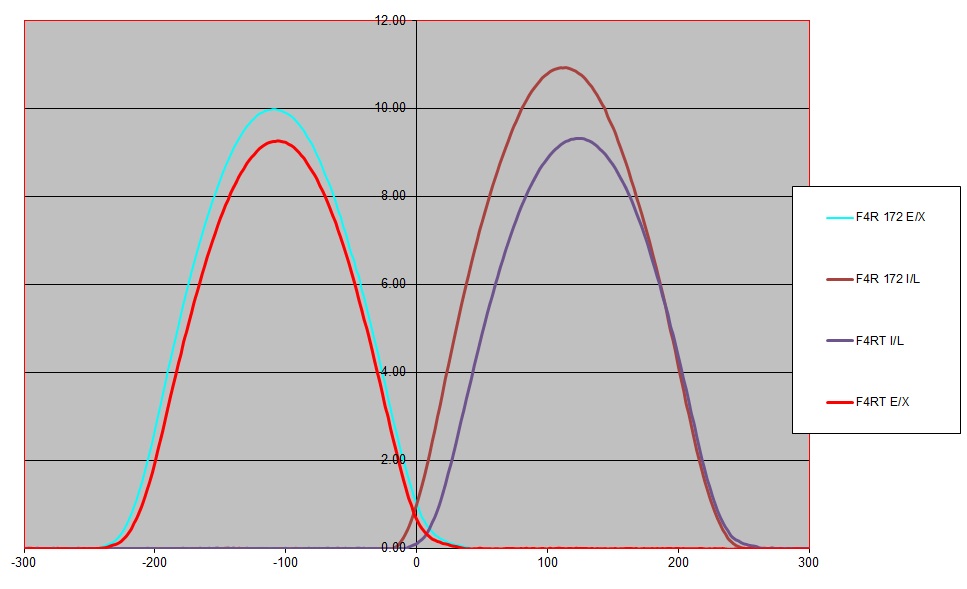

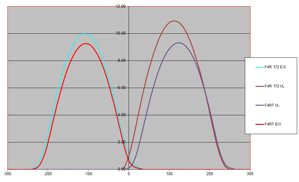

it's all about the cams, SR20DET and F4RT have mild cams with almost no overlap so can live with the backpressure of a small turbine. The F4R has what is more like a race cam to a turbo engine so you have to size the turbo to suit, if you get it right it'll piss all over an SR20, get it wrong and it's a dog (relatively).

you're mostly looking at 256/264/272 degree cams on the SR for aftermarket, and the lift is still less than an F4R stock cam. What's an SR20DET stock inlet cam? 9mm lift? and aftermarket is roughly in the 10 to 10.5mm region?
Exactly, hence why they spool well as there still quite restrictive compared to a stock F4R. The general rule is the milder the cams the better low down torque and response, wilder cams for a better top end. Obviously which ever you choose you sacrifice the other end of the rev range.
We do similar on the vauxhall turbo engines, fit the cams from the N/A variant instead as the factory ones are so mild, works well.

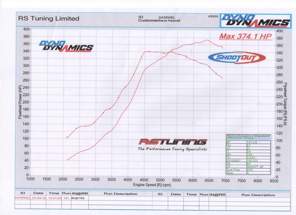

Well done Josh+Ktec, 399bhp is a pretty respectable number from a 2871r, how much boost you squeezing through it to hit that? looking at the graph on ktecs blog you can see how much better the spool up is on your lump compared to a low comp (8.5:1) F4R on OE cams. Torque is a lot better as well. Seen's as you have your head ported I can only guess that the milder cams of the F4RT are helping a lot.

Thanks, obviously when I said it was laggy that was in comparison to a GT28RS that I ran. In places below 4500rpm the 28rs was up by 30bhp and 30lb/ft. If you review both my GT2871R dyno run and Ktecs graph of a customers car running a 2871, you'll find there almost a mirror image of one another. I admit I did suffer at the top end of the rev range due to the logg maifold and looking at the figures Josh has pulled you can see that a tubular manifold will flow much better at the top end. As I'm keen to learn new things feel free to post the graphs up of any F4R engines that you've done running a GT2871R so we can compare, plus it'll show both myself and Ktec how it should be done :rasp: The truth is thats just how that turbo performs on an F4R running stock cams........ It would be nice to see how well there Blue clio spools on a tubular with the Tial turbine housing though.
Heres a link to Josh's graph on Ktecs blog http://www.k-tecracing.com/news.asp (its dated 19th Dec 2011 for anyone looking for it in the future :)) further more Ktecs customers car running a GT2871R is on the same link but dated (5th Sep 2011) and for those interested heres my GT2871R graph
