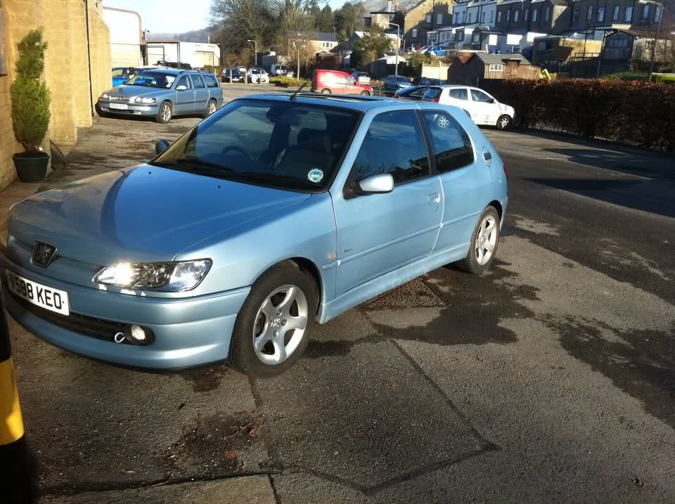

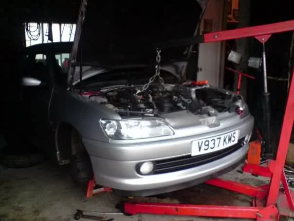

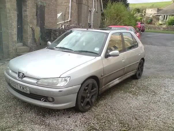

My first 306 was a 5 door hdi glx spec, bought it for £200 2 years ago with a knackered engine but tax+ test. Got it remapped for 100 quid in Bradford, homemade decat and straight through exhaust made 130bhp on rollers.
I ended up doing a fair bit to this car. New engine in, leathers, gti6 suspension, black cyclones, fitted a laguna splitter and painted the masks in the front lights. Learnt a lot about cars on this one.

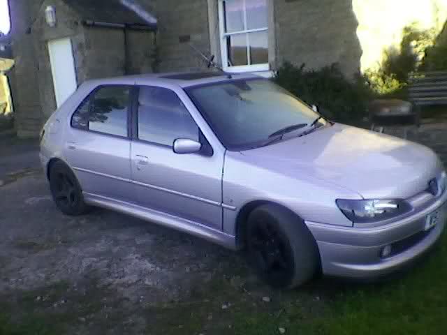

Sold it looking like this. (Not my pic)

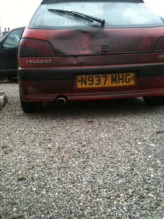

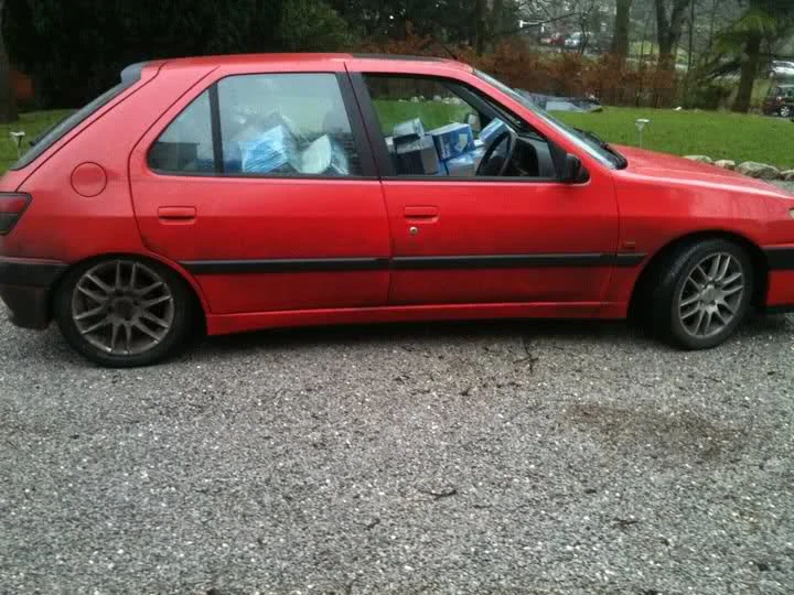

2nd 306 was a Dturbo S 5 door that was owned by a family friend for years and I always wanted it, he smashed the boot in before I got it so I bought it with tax and test for next to nothing. Turned the pump up a lot! Wound it round 2 full turns :) Homemade decat and plenty of smoke meant it was a fun car.
This is when it was filled with magazines.
The constantly black boot and dent.

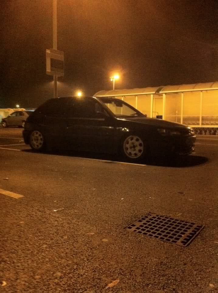

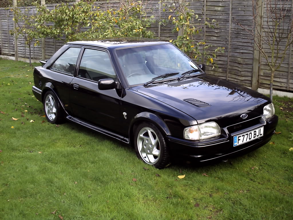

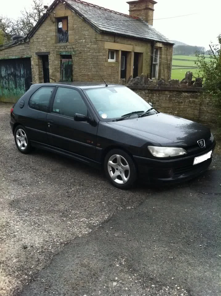

My 4th 306 was a Black 3 door Dturbo, I got this off a friend who had abused it so I gave it some love. Lowered it on Avo suspension off ebay £31!! Put my 205 speedlines on it, fitted full phase 1 gti6 leathers which were near mint and gave it a compound. It had the rear quarter painted before and I hated the fact it had seen paint. Sold it for what I paid for it basically. Had a lot of fun in it though because it was turned up and had a straight through exhaust system on it.

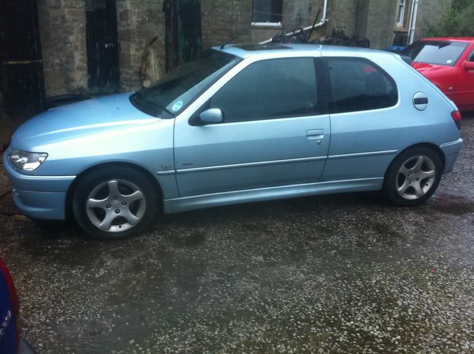

The latest 306 is a Gti 6 :) I got it on good friday, which was certainly a good day (even though it doesnt run). It cost me just over scrap value, its a 1997 phase 2 has FSH 80k miles and is near mint. Only 1 10p sized dent which I am going to get sorted. Its completely standard. The reason it was so cheap was because of a minor engine issue ;)

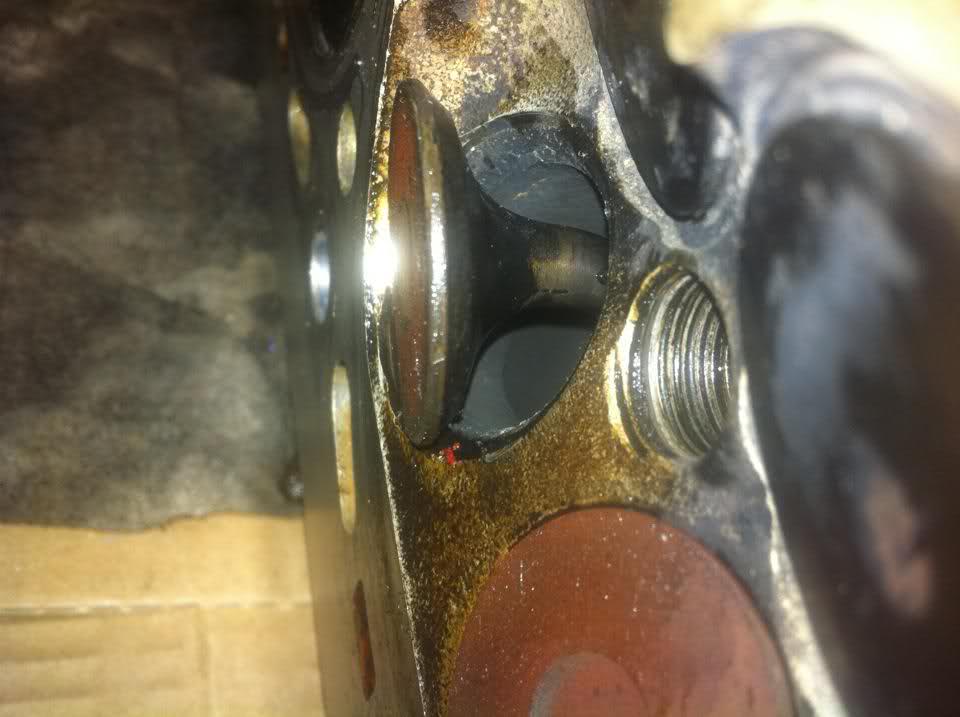

As soon as I woke up saturday I set about seeing what was wrong with it, I was told it had no compression on cylinder 2...
Did some checks to confirm and got the head off to find this beauty.
I text the previous owner and asked if it had any trouble before as 6 engines seem to be made of cheese. He replied and said that the cambelt snapped at idle 6 years ago. A few valves were bent, they were replaced and new gasket, water pump and cambelt kit were fitted.
Now I have done a lot of reading about 6 engines and talked to a few engines builders and they recommend checking the valves on a laithe with a dti gauge because if they are 0.001 mm out they will sound tappy and eventually snap.
This car has covered 20k in the last 6 years so it hasnt really done much but I think one of the valves was ever so slightly bent and has eventually given up.
I am sending the head off tomorrow to be dipped, skimmed, 16 new valves installed and seats cut. It might need a new guide but he said it won't make any difference in price. £310 for the lot, so car stands me at ~£500, needs testing (£30) and taxing (~£120) and will be on the road!

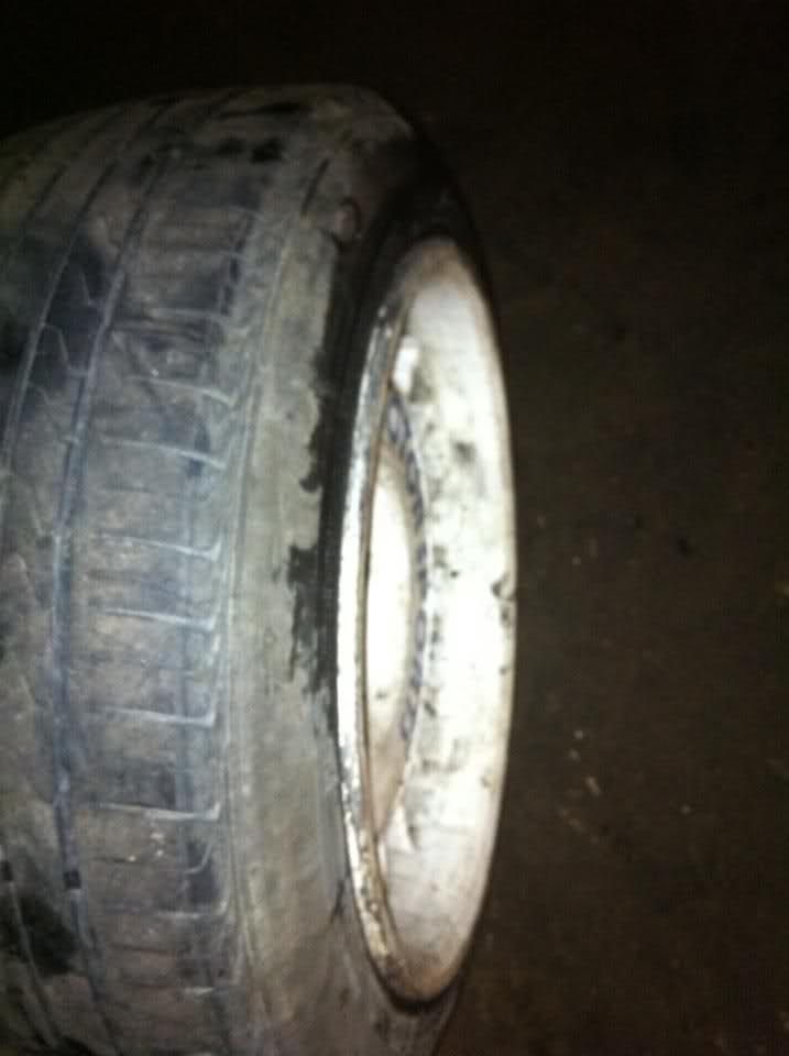

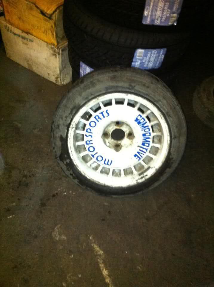

Been a lazy c-unt and still having access to a car I still haven't refitted the head. Its going on this weekend. I have however got some new wheels. They aren't in the best of condition but I think they will look awesome when they have been refurbed.
For all the haters, I have seen an s16 with some 15s that were staggered and it suited it!
Rears are 8x15 ET0 and fronts are 15x7 ET40 The rears just fit, but I need my friend to machine some hubcentric spacers up for the fronts.
Heres a pic of a rear 1 with a 185/55/15 tyre on. I still need to decide what sizes Im going to fit.
I know it won't handle that well but I'm not going to thrash it for the first k.

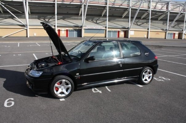

Black looked gorgeous:
Had cat cams, twin tubi decat, full stainless, BMC induction, top and bottom struts and was freshly rebuilt with no tapping :D
