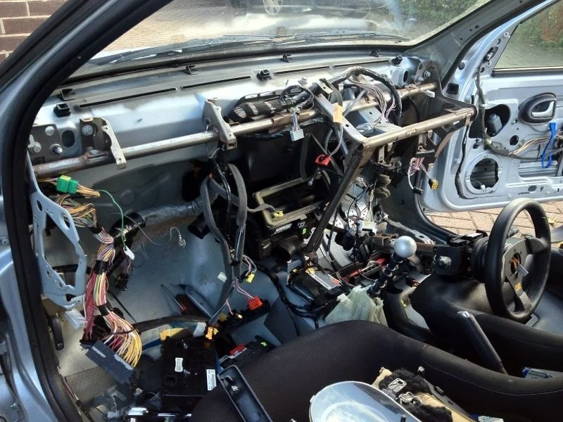

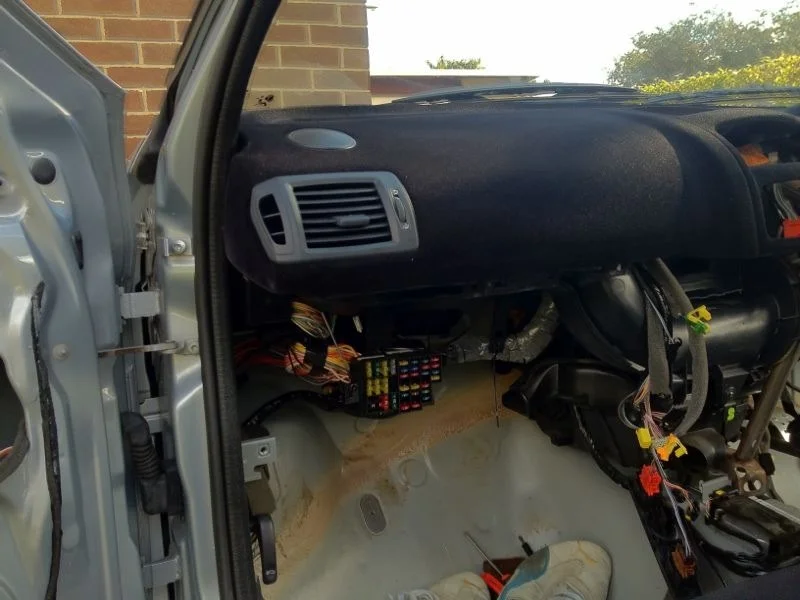

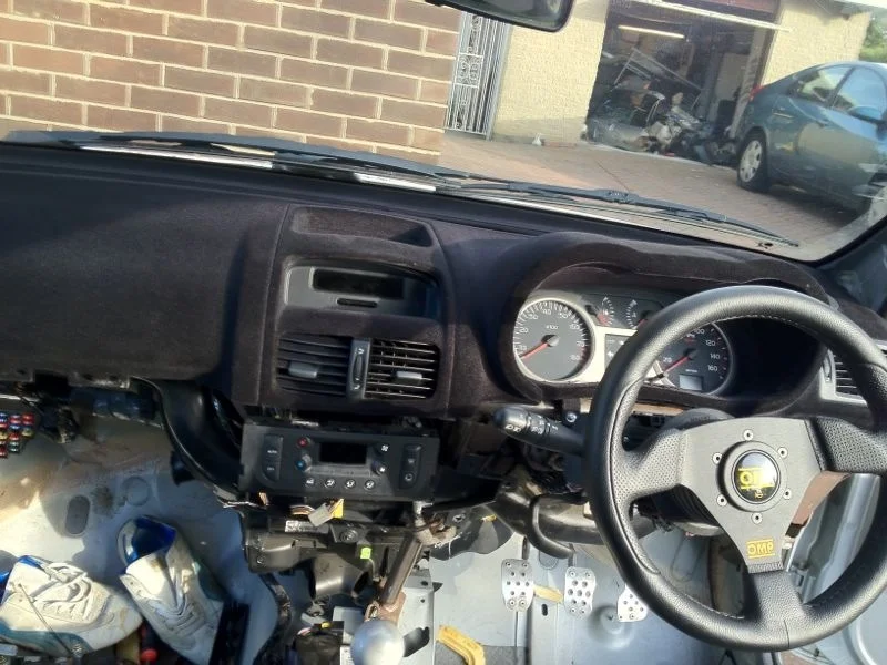

Len, I've got to ask buddy, how is the to half of the dash held in place?
would you mind firing over a picture of your dash setup to me please, if you don't mind.

Kelv these are very poor pictures by brother took last year when he first removed the lower dash. I've since cleared a lot more crap out and removed the rogue wires you see dangling so it's much neater. The leg of the dash bar you see to the right of the blower has also been removed.
The dash top sits really well actually as there's a metal dash bar that supports and the loom can be cable tied to this. The bar can be trimmed down too for some extra weight loss.
