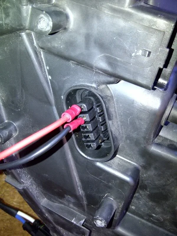

4th step: In order to gain the positive and negative feed to supply power to the ballast i poked around with a multimeter to try and find the original feeds that are triggered when the lights are turned onto 'dipped' soon after looking i found the correct feeds on the left hand side of the conector the oem ballast used and connected the positive and negative wires accordingly, i did this by cutting the original spade adapters on the kit down to a small size that would allow me to pushfit them into the oem plug. this is shown in the picture below:

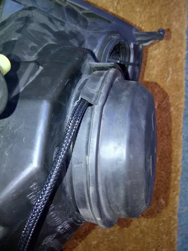

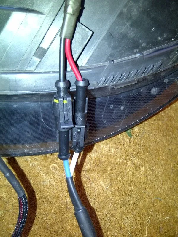

5th step: Once id connected the power end of the ballast, i then proceeded to attach the bulb to the D2s adapter holder at the other end of the kit. Once i'd done this i neatened up the cabling through a small cut in the plastic and the outer rubber so it still stays sealed, this is shown in the picture below.

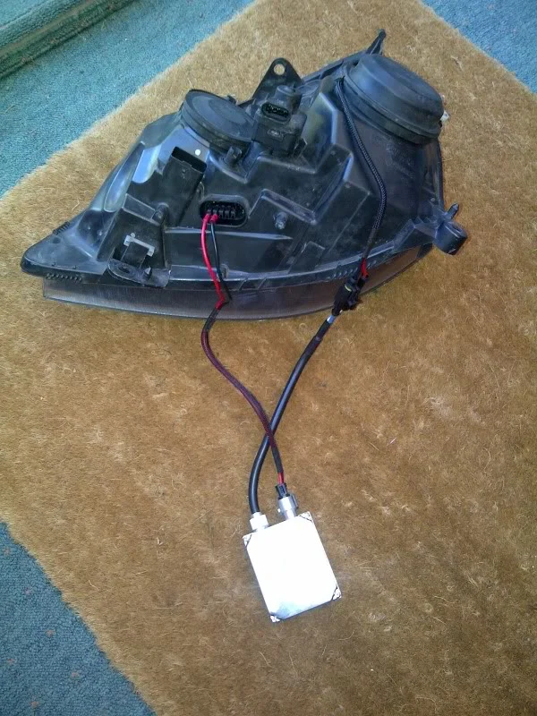

Final step: put the finished unit back into the car and attatch the existing plugs and find somewhere to neatly hide the ballast within the engine bay. This is what the finished unit should look like once wired up: ( i put a small dab of silicone around the positive and negative feeds for the ballasts before putting them back in the car just to seal the wiring)

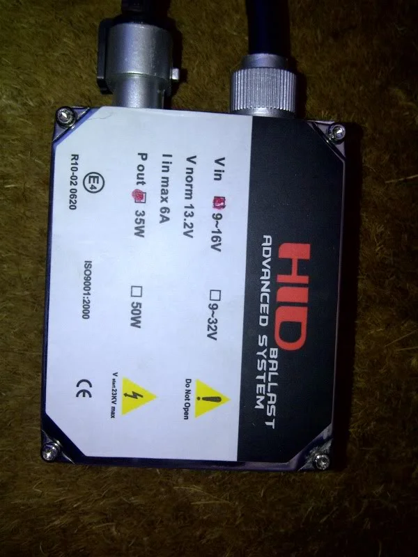

Couple of random pics i took of the kit
Ballast
