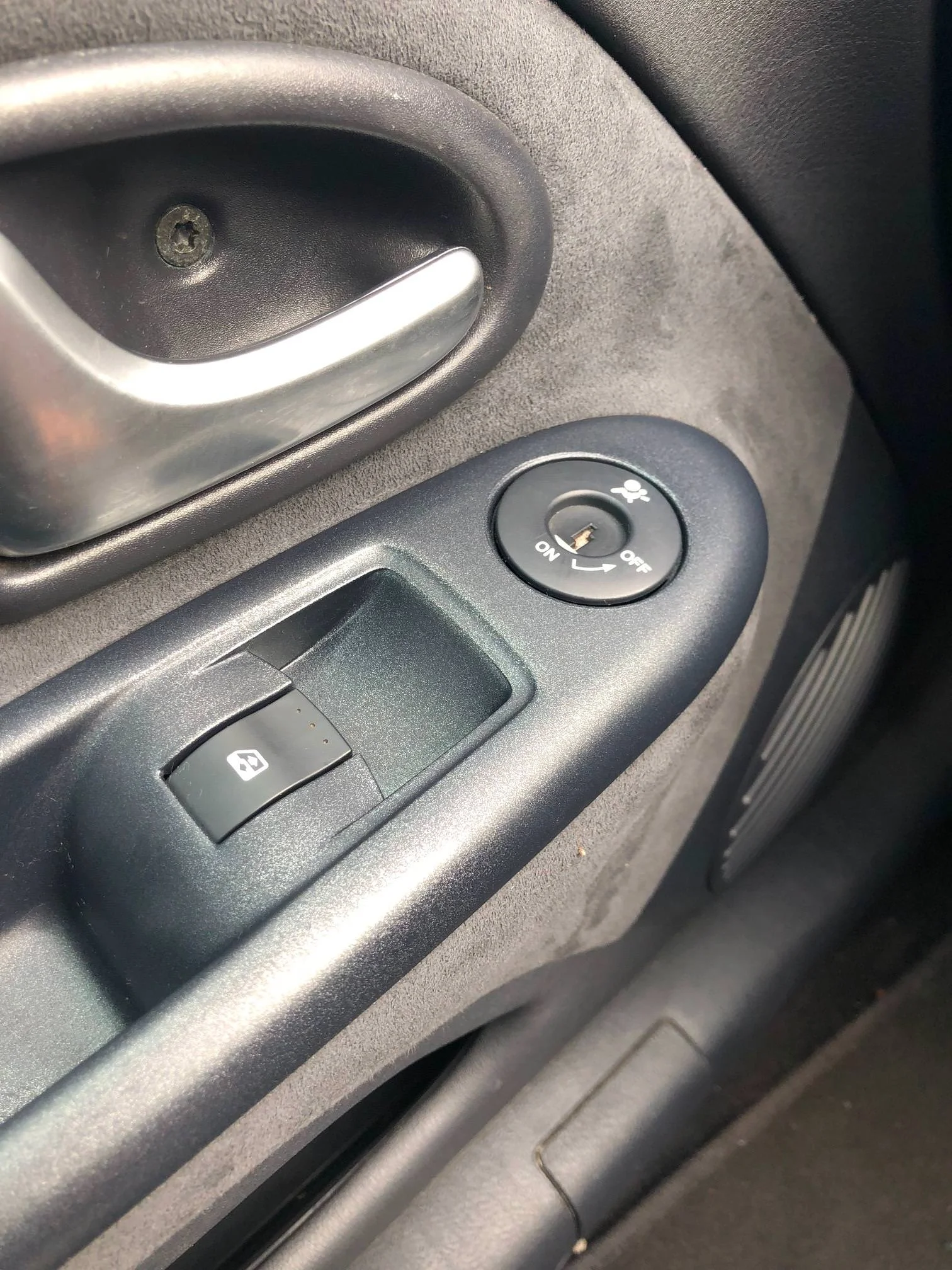

I've only had my 172 a few days, but the interior trim was really getting on my nerves. I've seen a few but mine was by far the worst I've came across.
After searching through the forums for an answer, everyone seemed to either be stripping them completely and respraying them or else replacing them with items from non-sport models.
With nothing to lose, I thought I'd experiment.

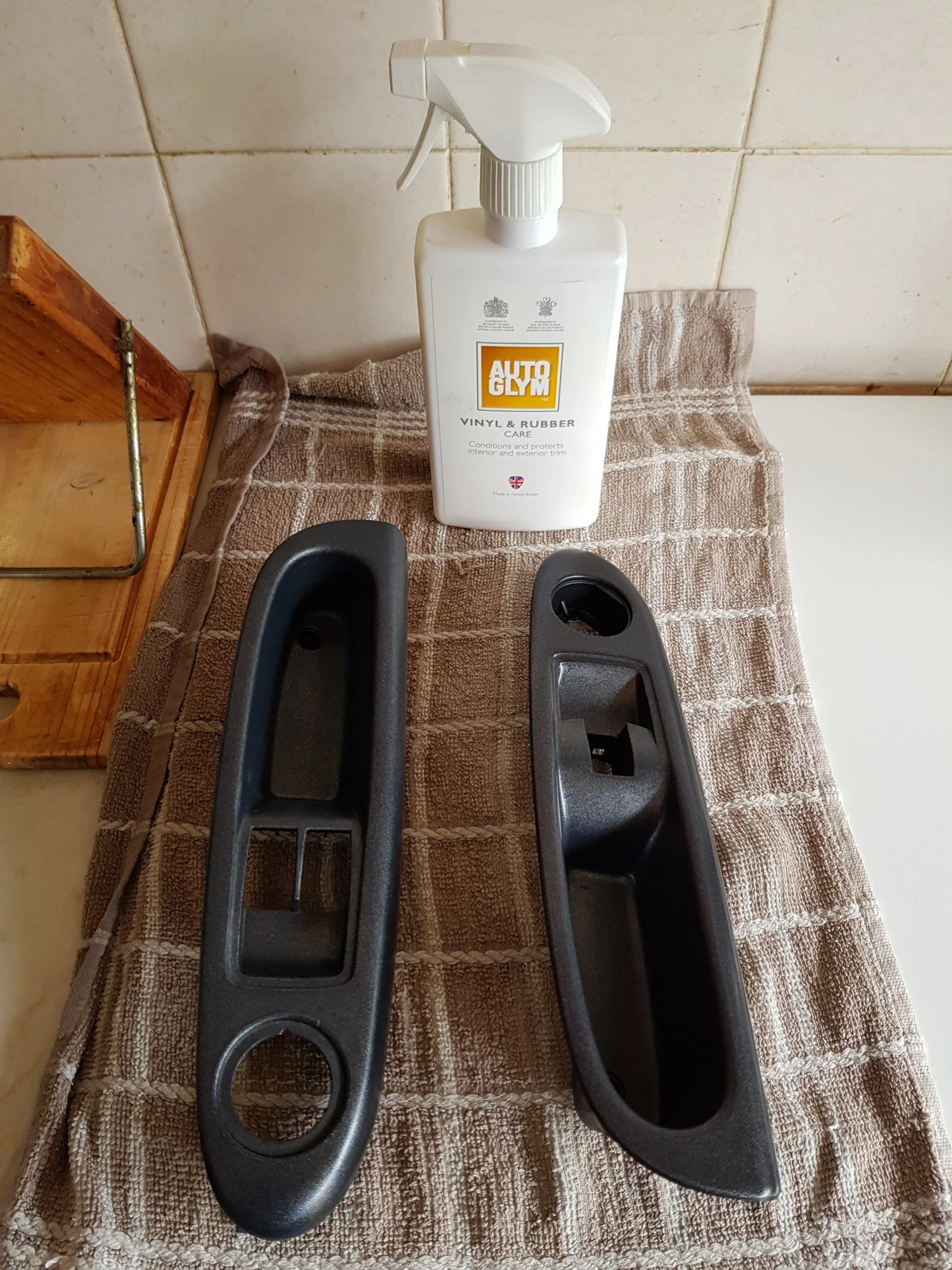

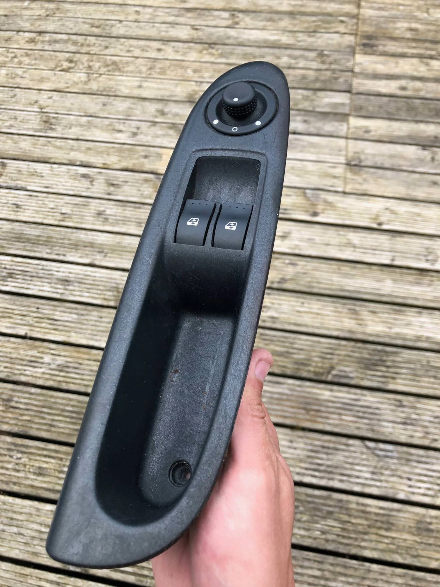

Before:
The Process:

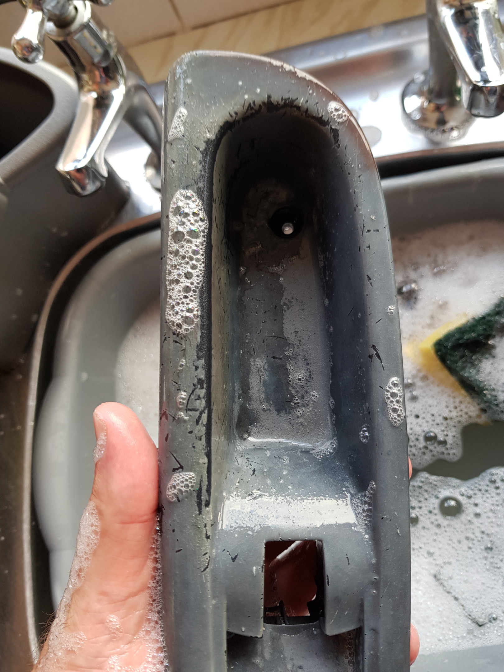

Remove the trim from the car and unclip the switches.

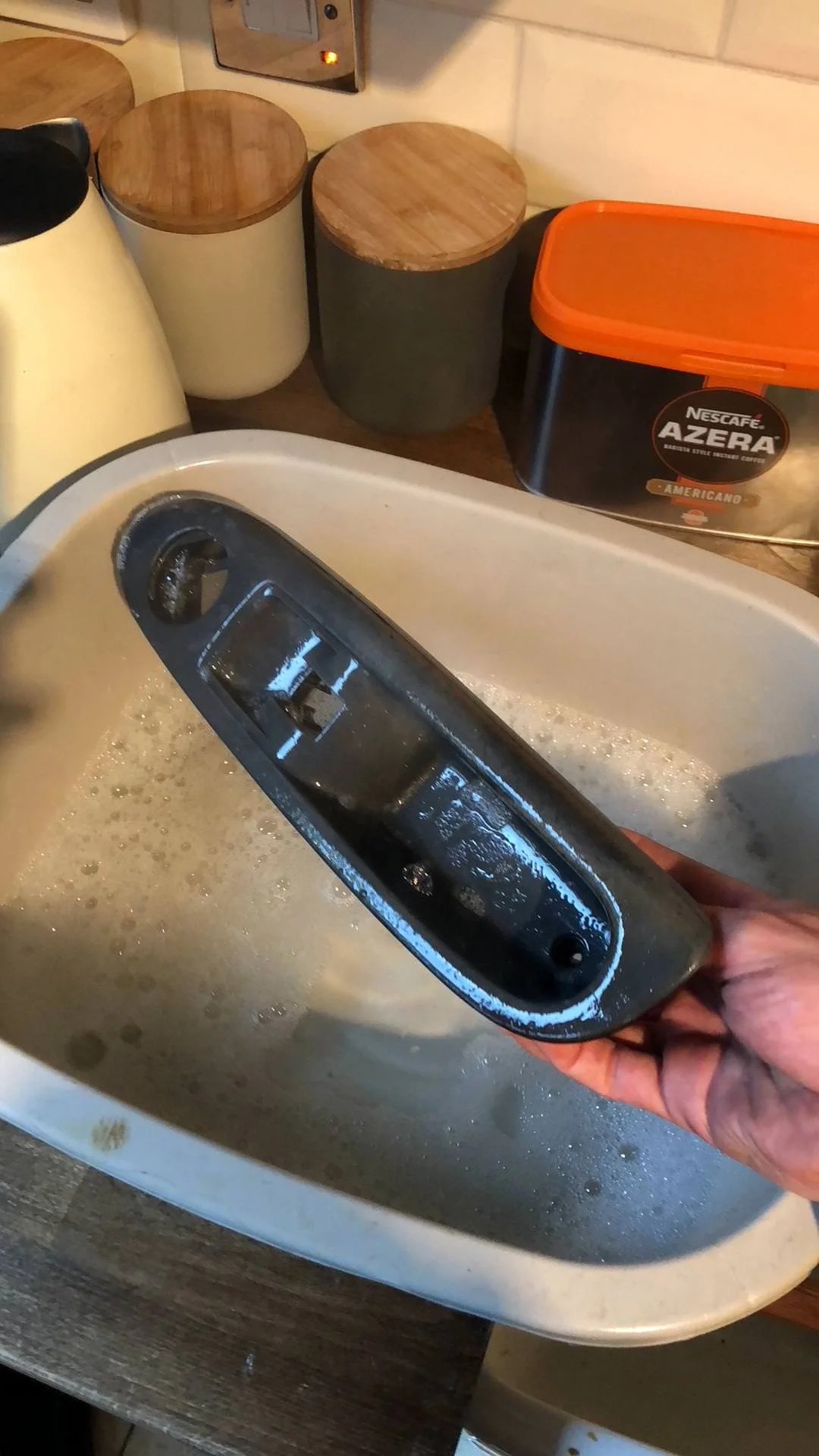

Then soak the trim in hot (not warm) soapy water.
The items used:
Elbow Grease is available for £1 in The Range and the scouring pads (Glitter optional) came from B&M or somewhere like that, I'll have to ask 'the boss'.

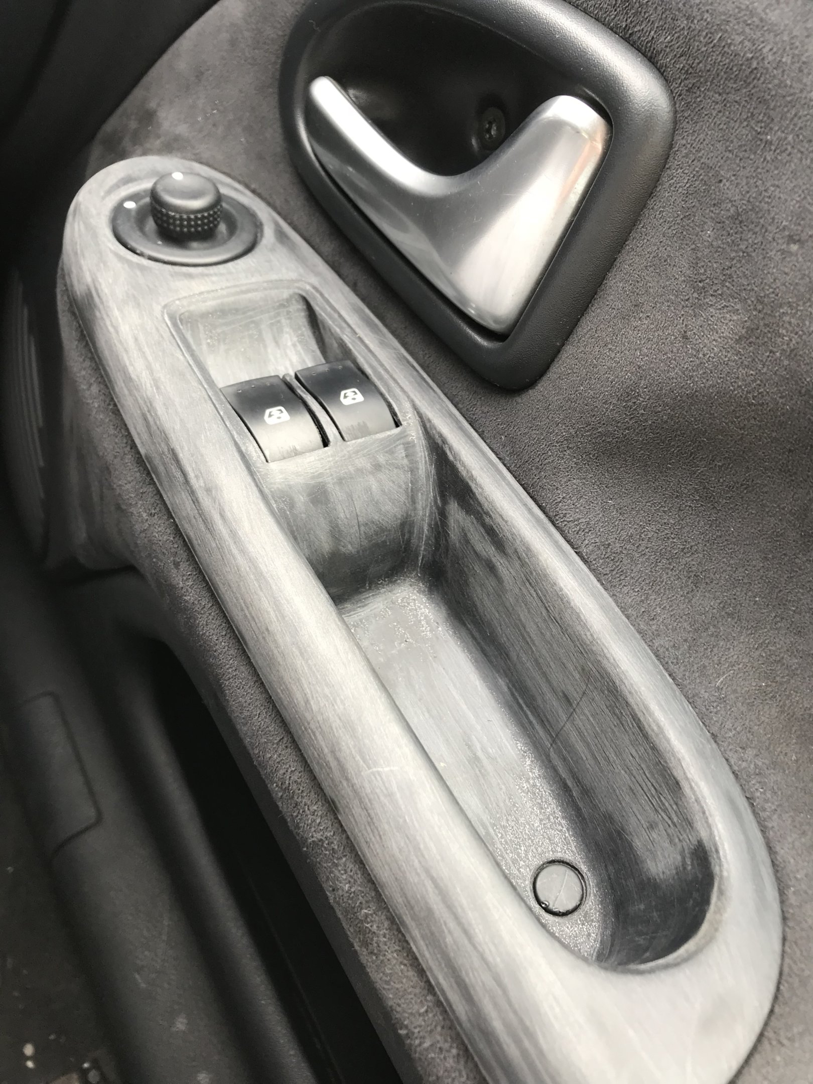

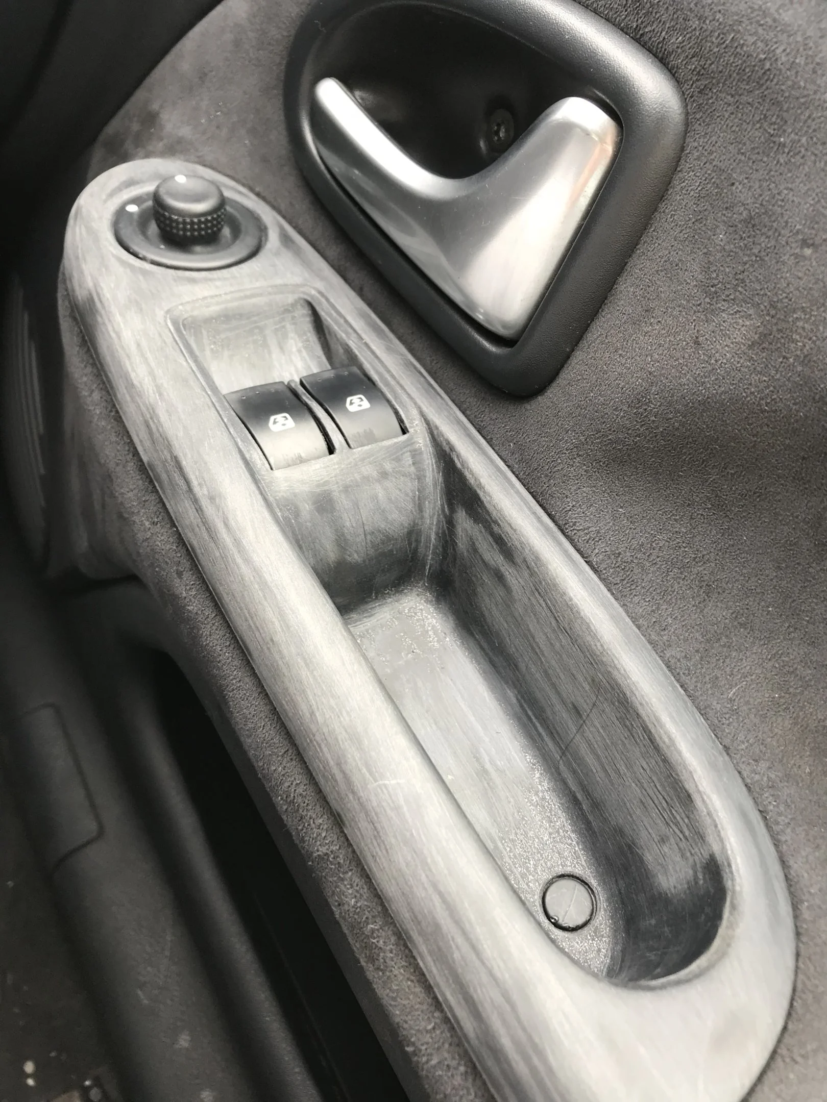

Spray the degreaser on and let it dwell for a couple of minutes before scrubbing with the scourer. Once you start scrubbing, it goes a bit white and scary looking, don't worry and keep scrubbing, it all comes off.
I wasn't expecting to make a guide, so I didn't take pictures of the scrubbing process - I'm sure you can use your imagination. It was surprisingly easy, each piece only took 5-10 minutes to do. Some places were a little awkward to do but just keep scrubbing, rinse occasionally and wipe with a towel and you'll see the parts you have missed.

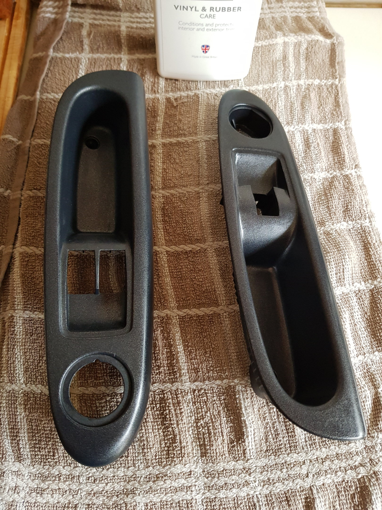

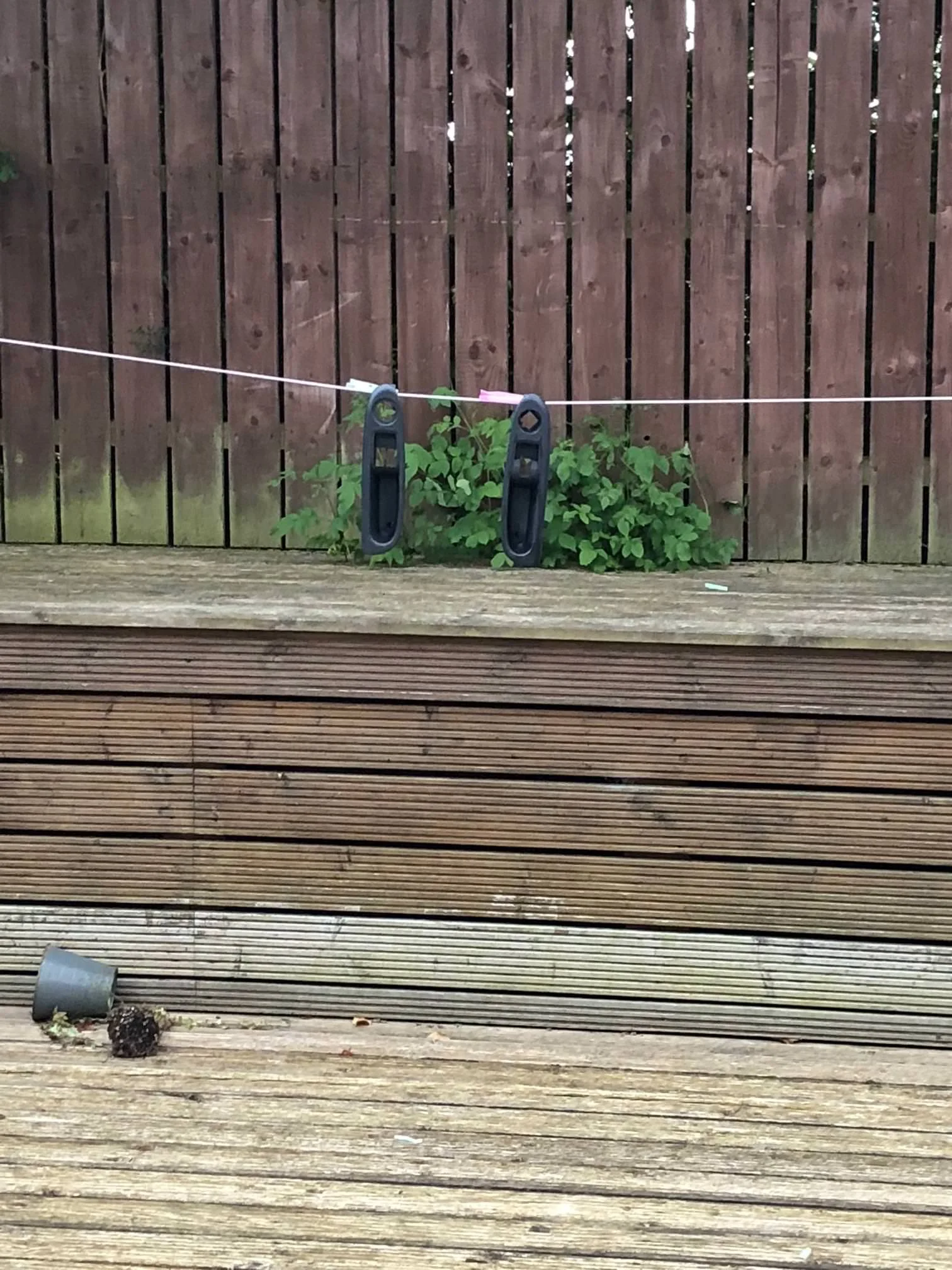

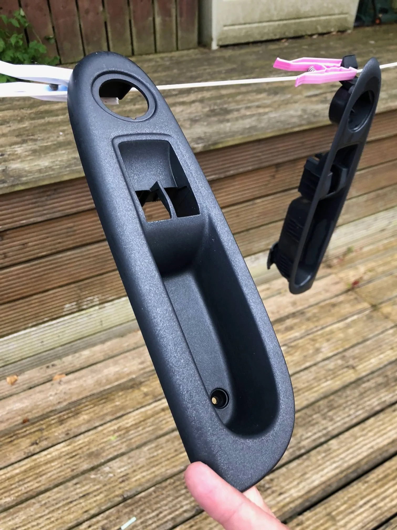

Dry them off (If you don't have any kitchen roll left, improvise, like so):

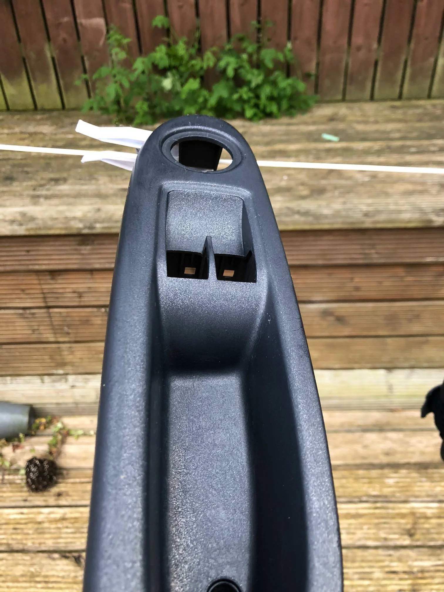

And the dried item:

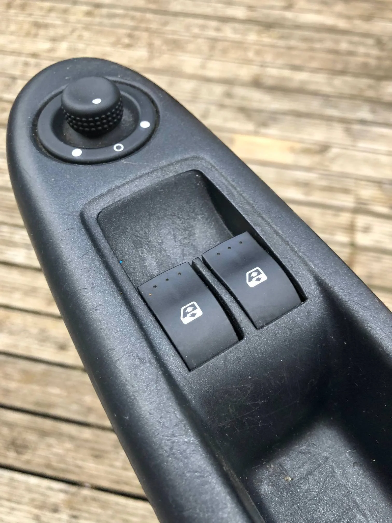

You can see on this one where I had to go over it again as it was still a bit white near the switches.

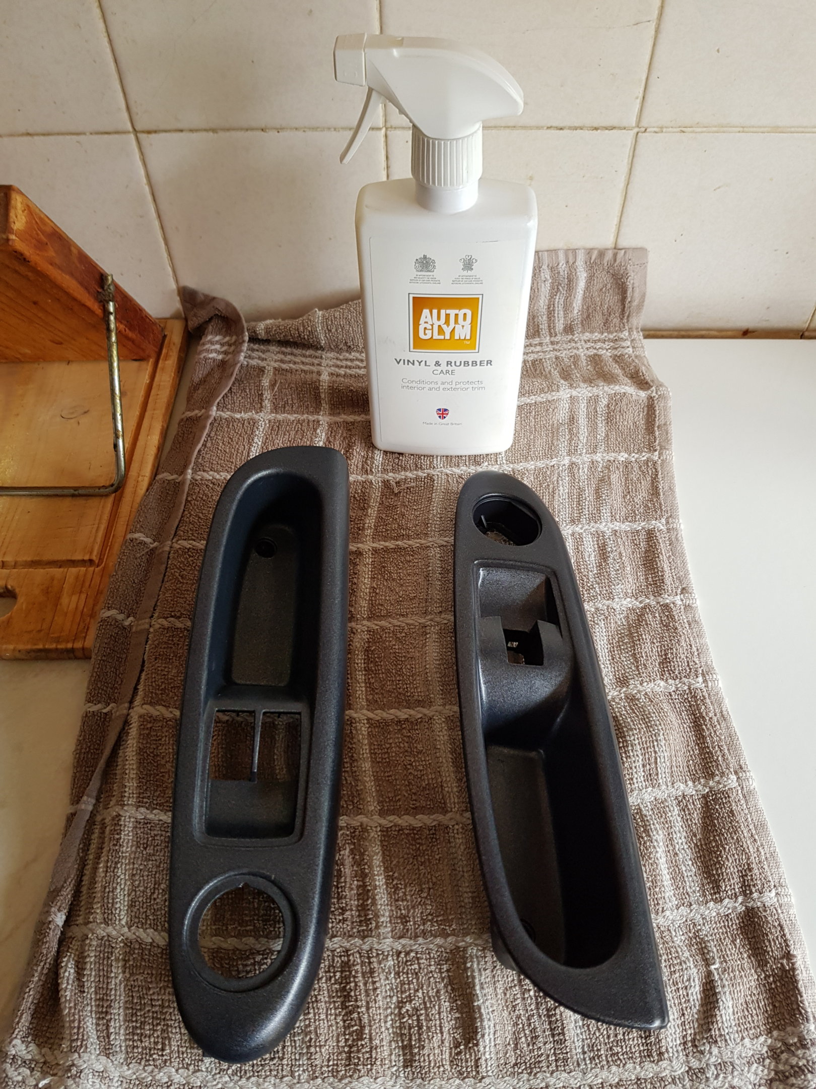

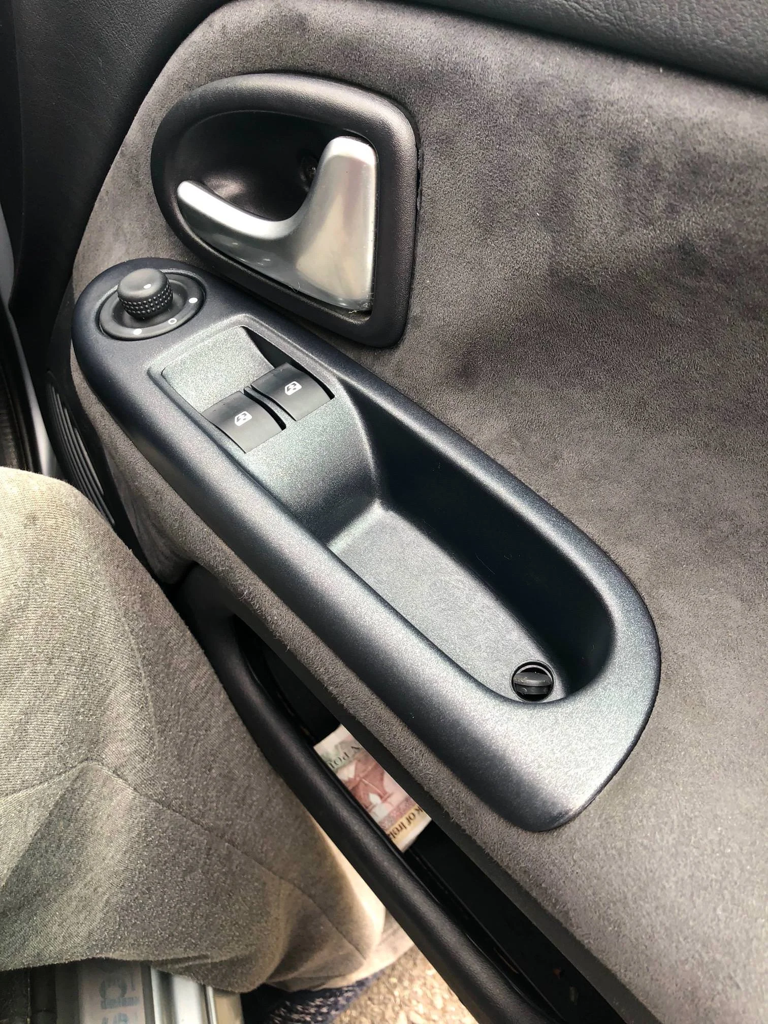

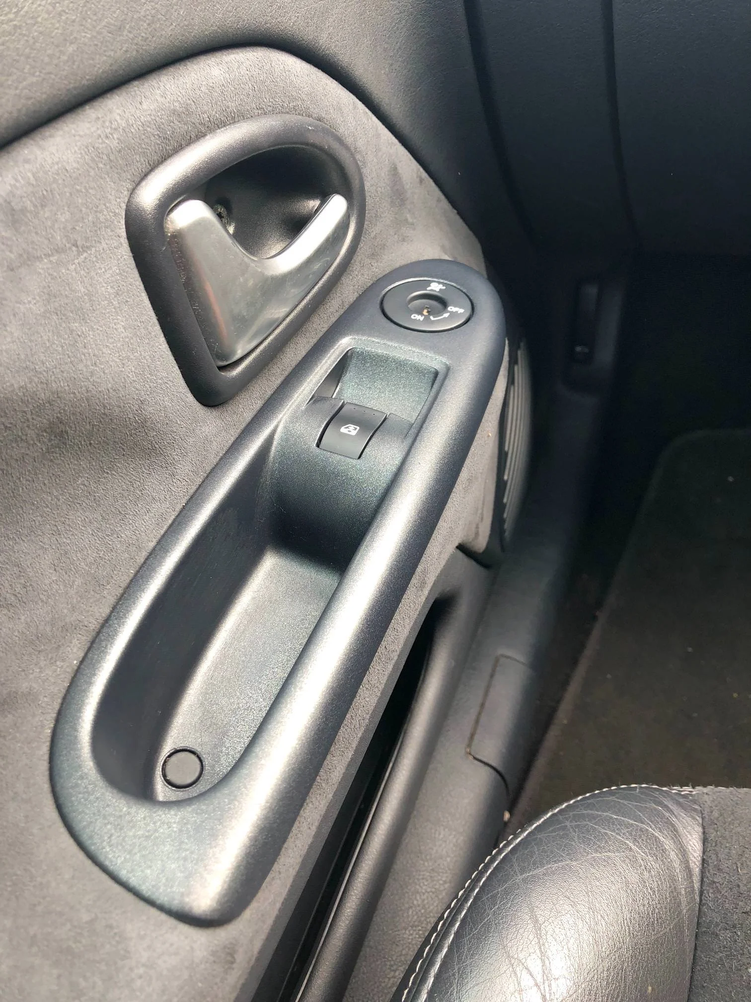

I then gave them a coat of Autoglym Instant Tyre Dressing. This isn't slippy/greasy like most tyre shines/cockpit shine sprays.

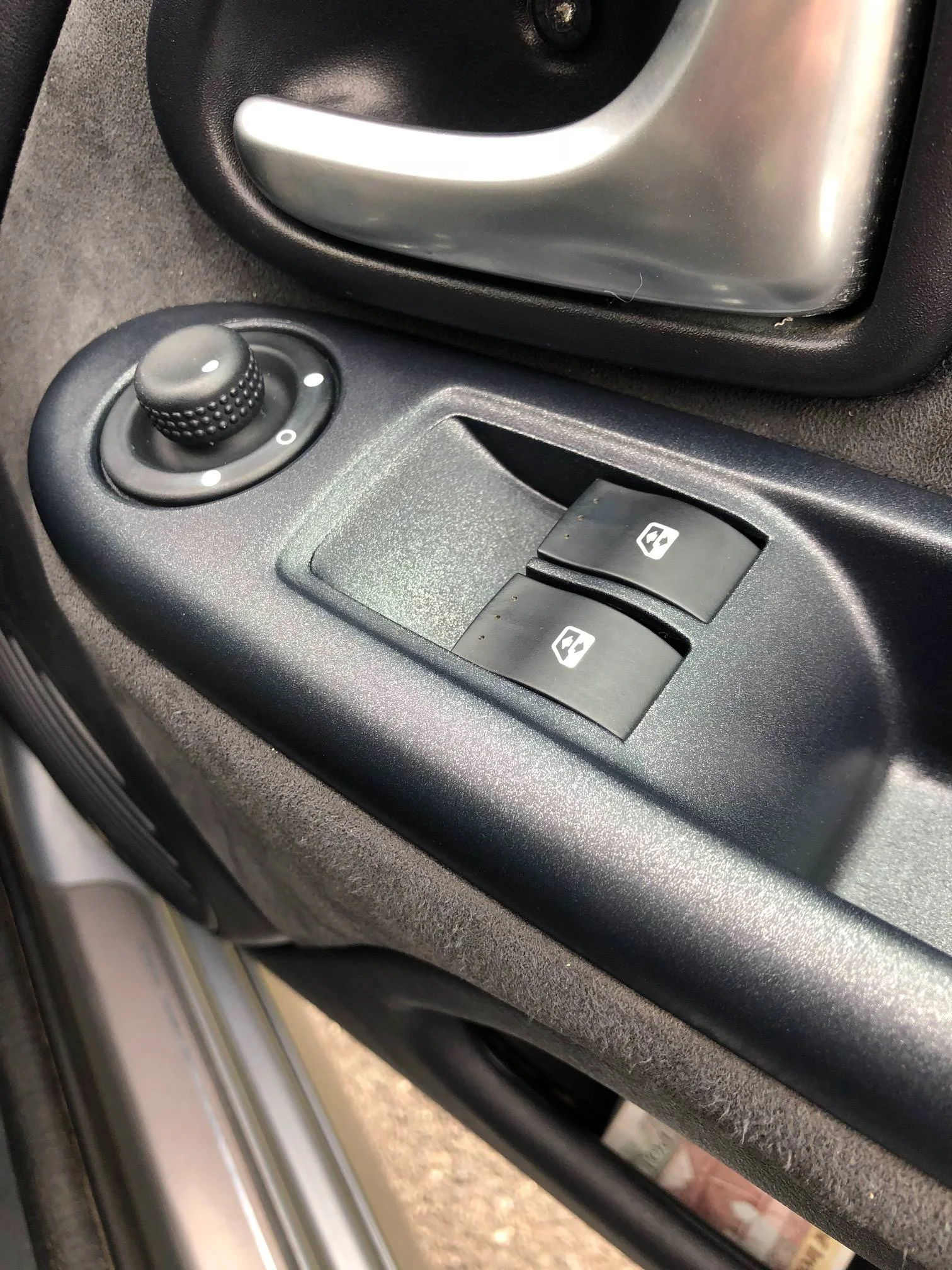

The results:
Hopefully this helps someone out.

The passenger side needs done again as there's a few bits I've missed. You only really notice it when they're dry.

I've seen folk lacquering them when I was researching how to solve it. I done this a few weeks ago to all the plastics in the car (and the rear wiper surround) and i've just been giving them a wipe when cleaning the car and there's no marks/grime on them yet.

Isn't that mirror switch on upside down? ? Also, does anyone know where to get the screw caps from and also what size screws are meant to be used? Thank you!
Lol, yeah. I've changed it since. Oddly, it works just the same upside down :/

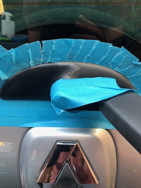

Anyone tried Autoglym Intensive Tar Remover and a clean rag? Worked when I had some decal residue on my motorbike. Going to try it anyway. ?
  Ph2 172, 106 Rallye
I tried a tar remover that’s supposed to be a chemically stronger concentrate of tar remover compared to autoglym on my rear wiper plastic and it started to go funny again within a week or two.
  Ph2 172, 106 Rallye
I’ll grab a pic when I’m home. It went whiter than it was before I started scrubbing it.
