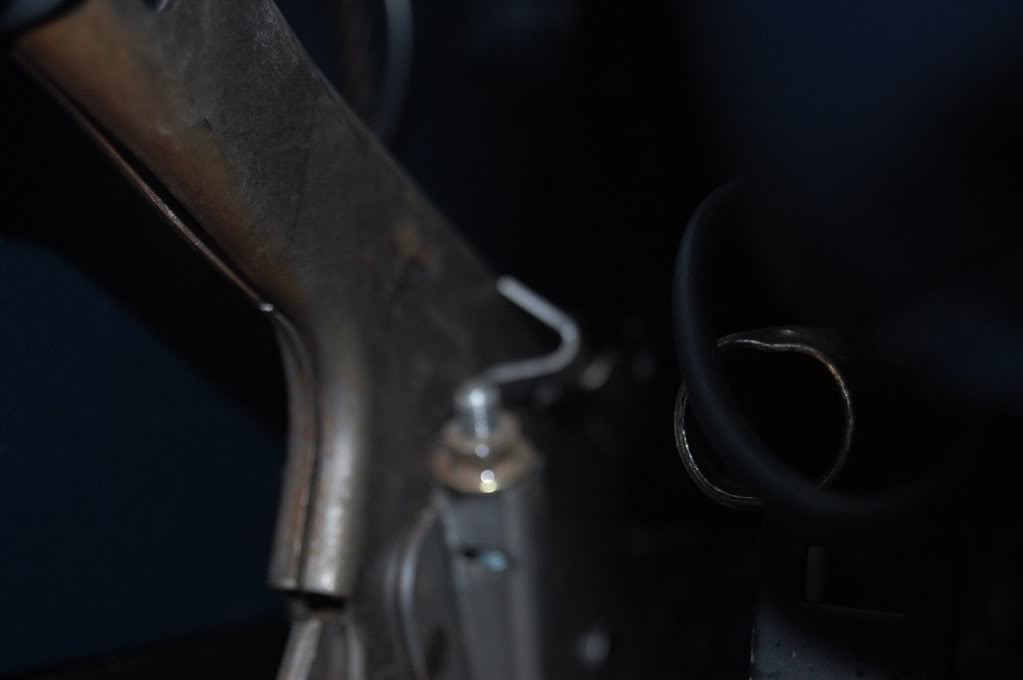

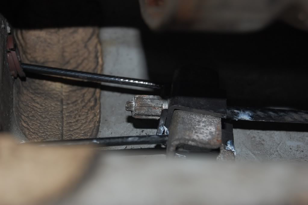

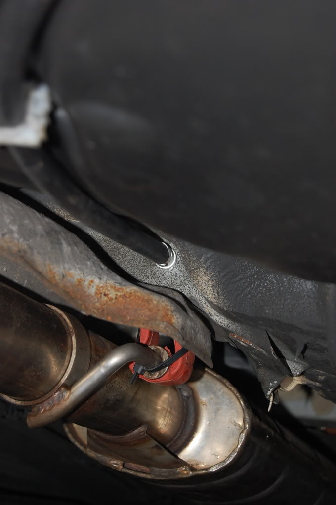

Easy
Slacken off cable inside on hand brake
Jack up use axel stands
remove heat shield 4 bolts which maybe seized
remove cable from caliper
unclip from divider under hand brake
pull out cables
