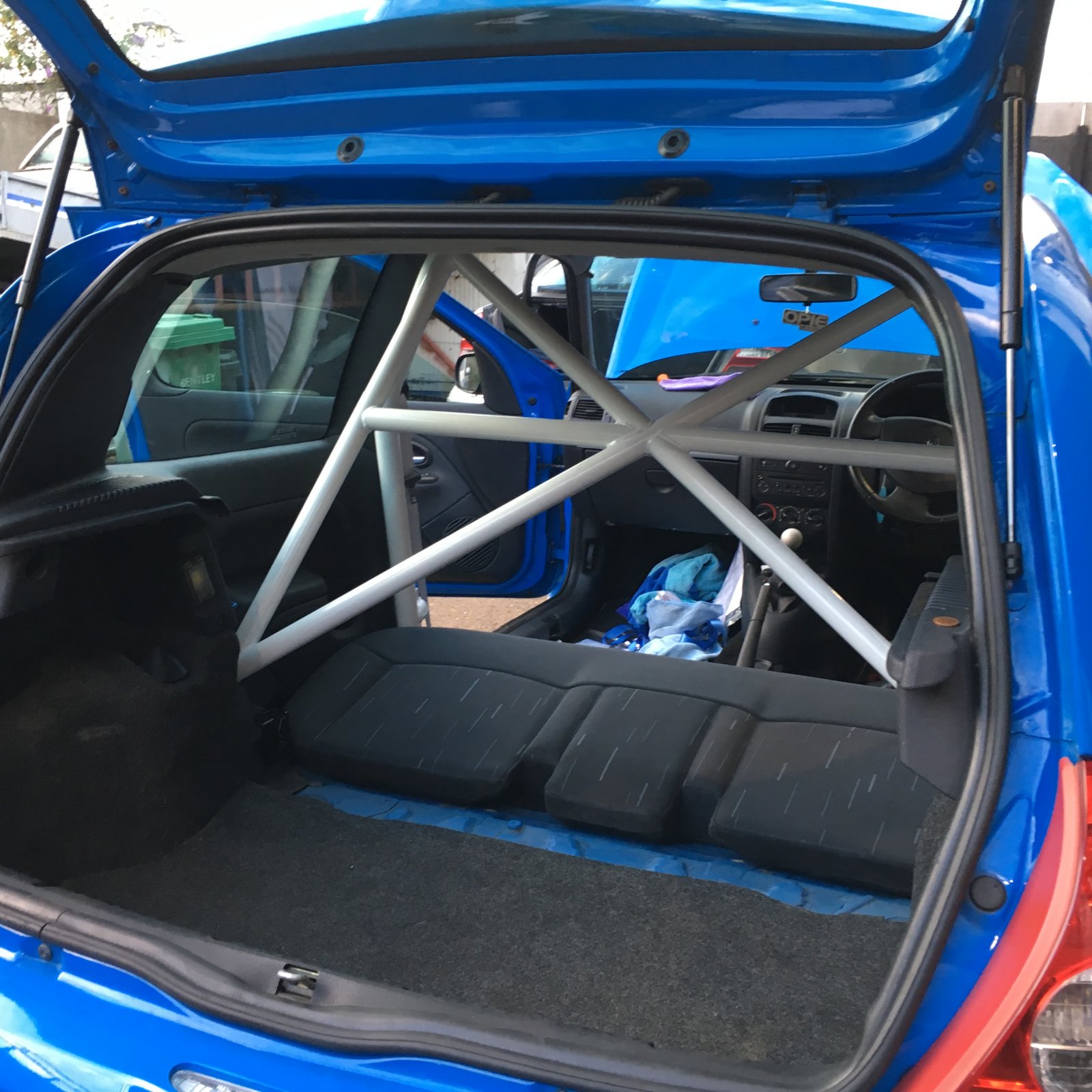

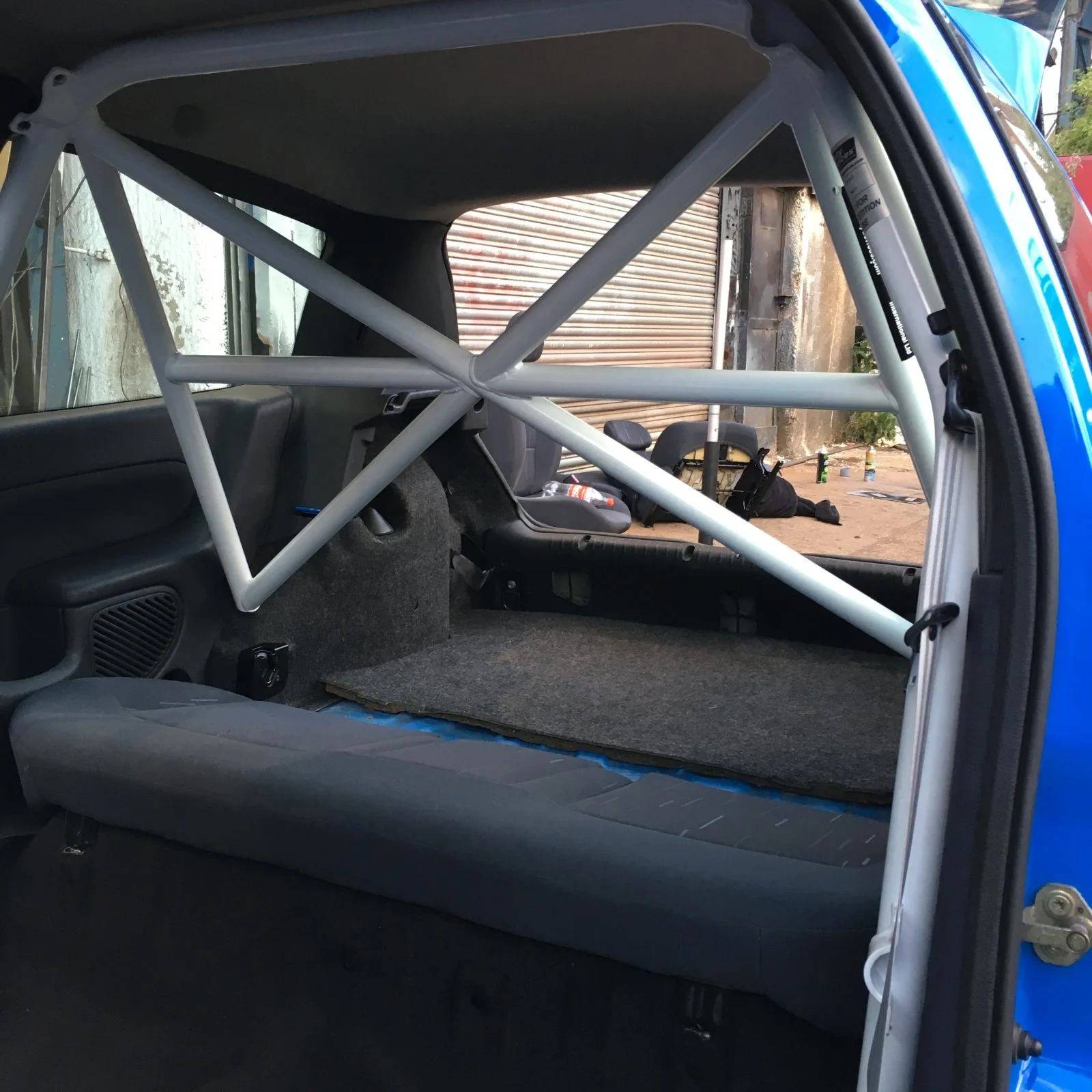

As some of you may know I've recently fitting a rear SD rear cage and this weekend coming I'm picking up the bucket seat & harness, which leads me on to my next question, Harness mounting points.
Here is a pic of my car/cage (ASW!)
I've purchase two Sabelt 6 point harness, the shoulder straps will be mounted to the cage, however I would like to see how people have mounted the crotch and lap belts.
If helps I'll be running a pair of Corbeau Clubsport seats on VBD X-Low subframes and I would appreciate pics of where you guys have mounted the crotch and lap belts.

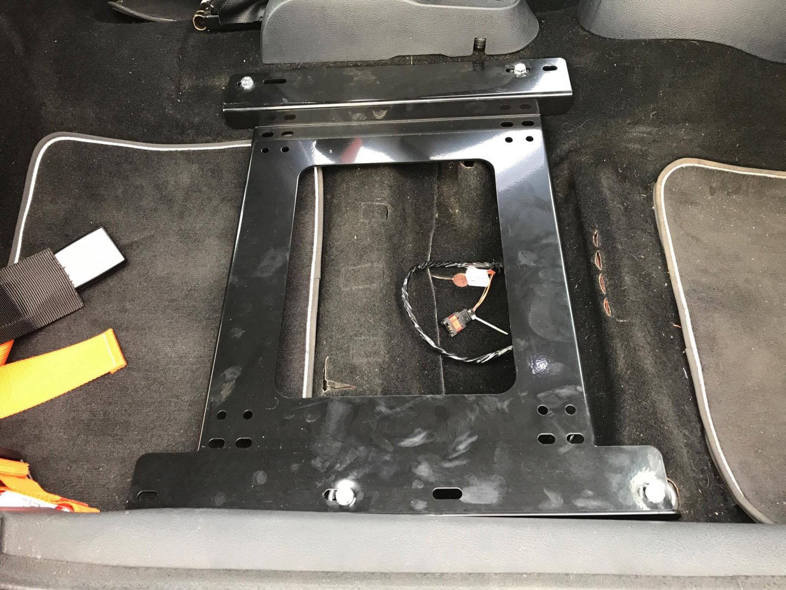

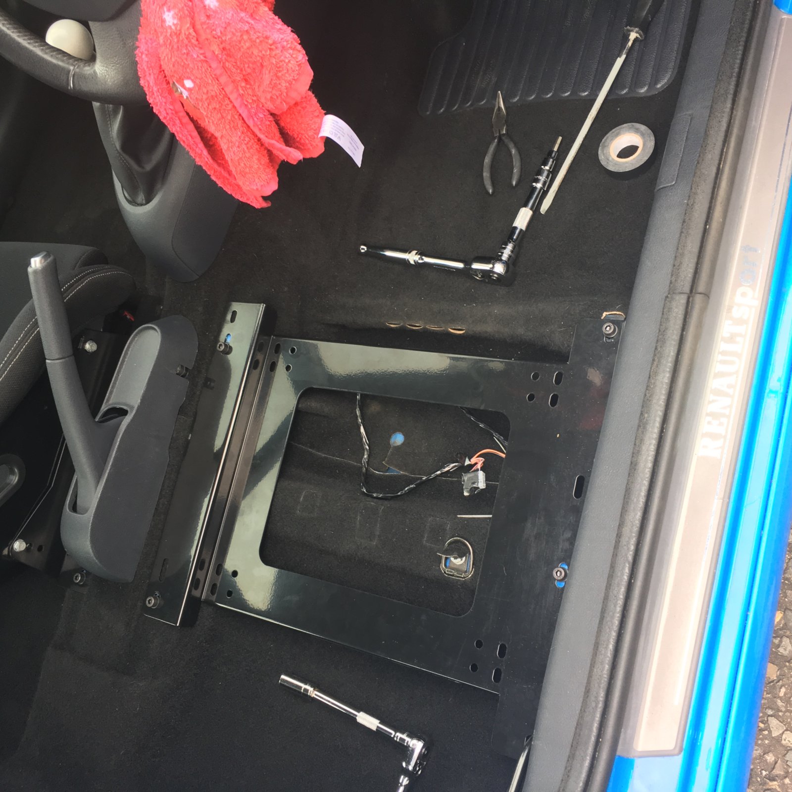

Here is a pic of the subframe I'll be using from this pic I can't make out where the seatbelt mounting point is by the handbrake...
Thanks again for the help.

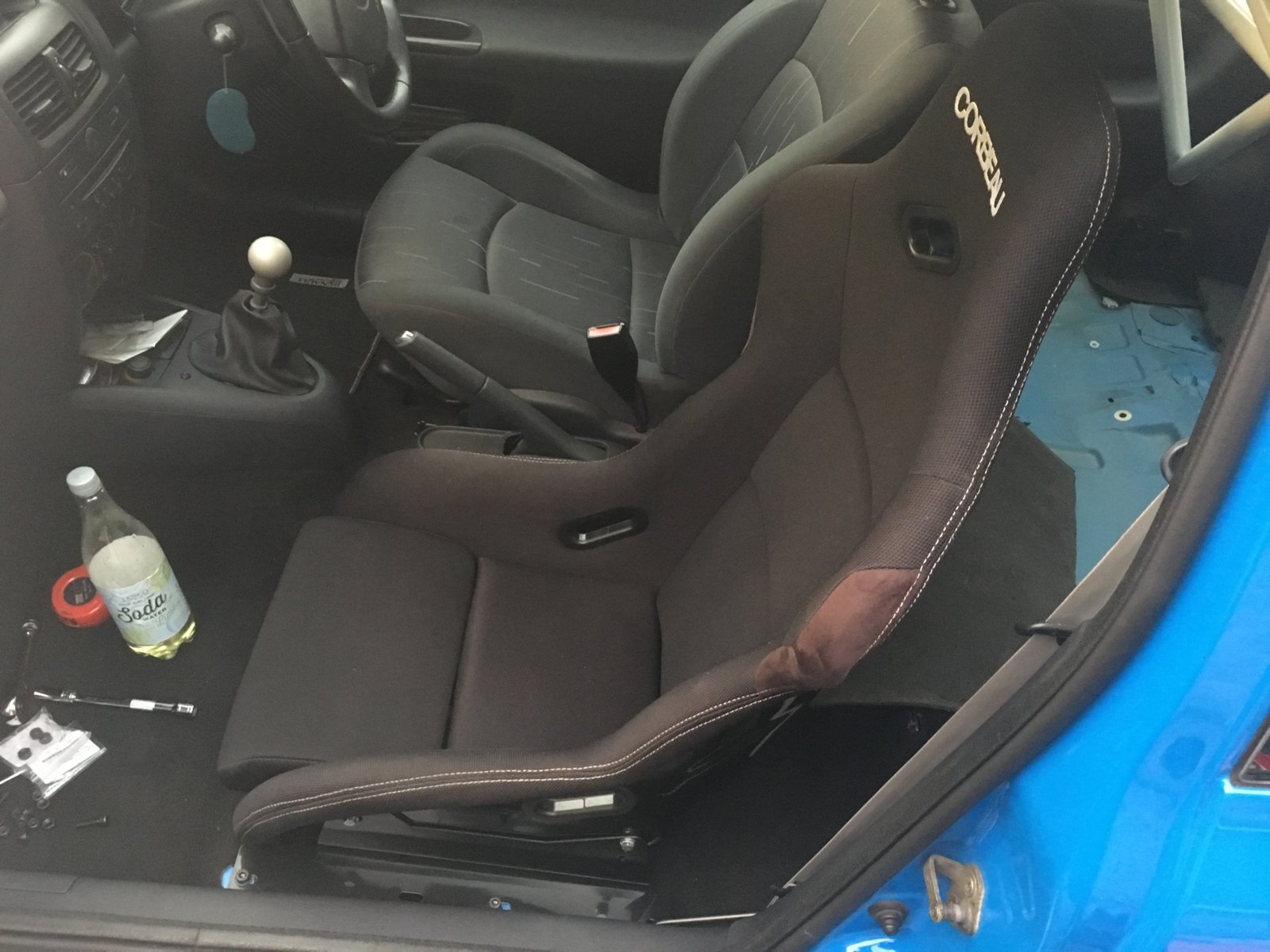

I fitted my seats this weekend however I'm still no further in knowing where I mount the lap strap? I don't believe there are any mounting positions on my subframe therefore am I best welding new fixing points for these as well as the crotch strap?
Any pics of how other members have mounted would be great.
Pics of how the car currently looks:

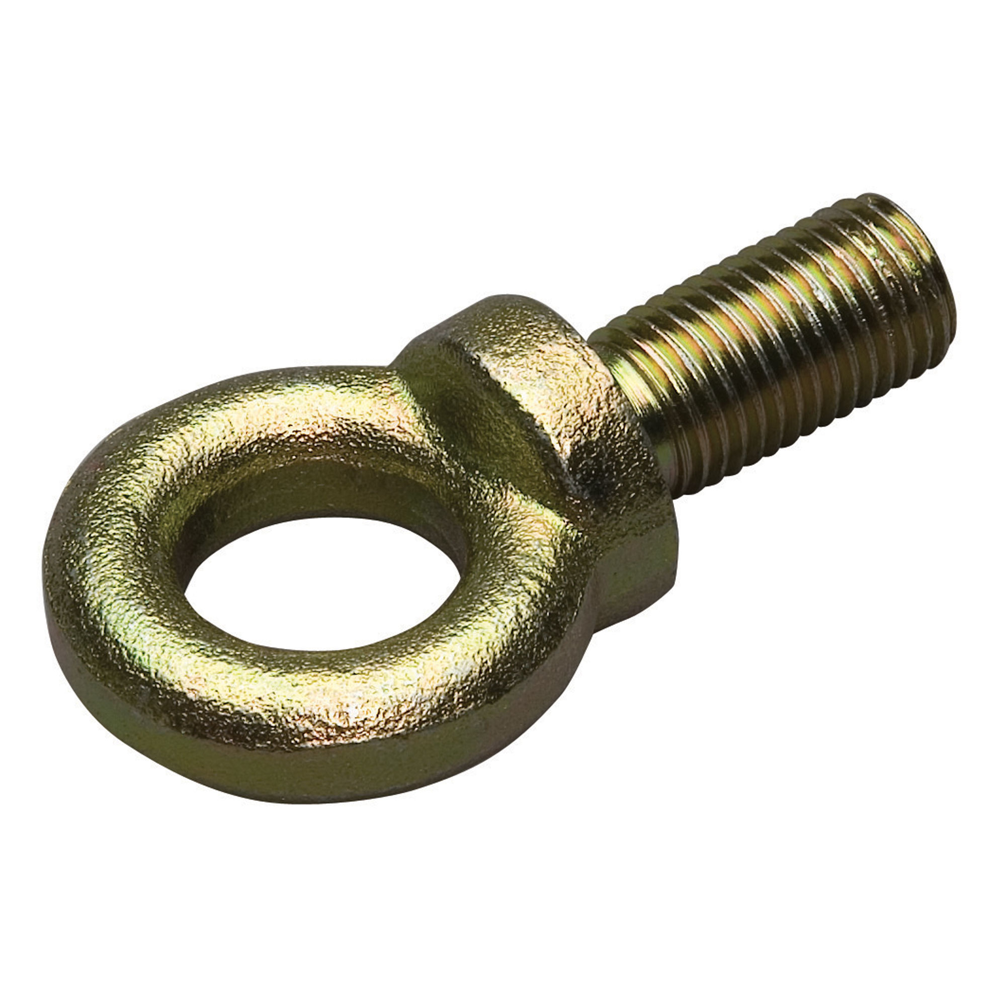

Removed the outside seatbelt rail and fit one of these in it's place.
For the straps on the inside near the handbrake, get one of those eyebolts like above but with a long thread and a nut and replace the inside rear bolt that holds the subframe down with that. So the eyebolt holds the subframe down on that corner as well as providing a place to clip the strap to.

I just used the below brackets, I fixed one to the bolt at the back of the subframe hand brake side, and one between my cage and OE seat belt mount. You would only need one though as you can use an eye bolt for the OE belt point by the drivers door, you'll need an m10 eye bolt with longest tread possible.

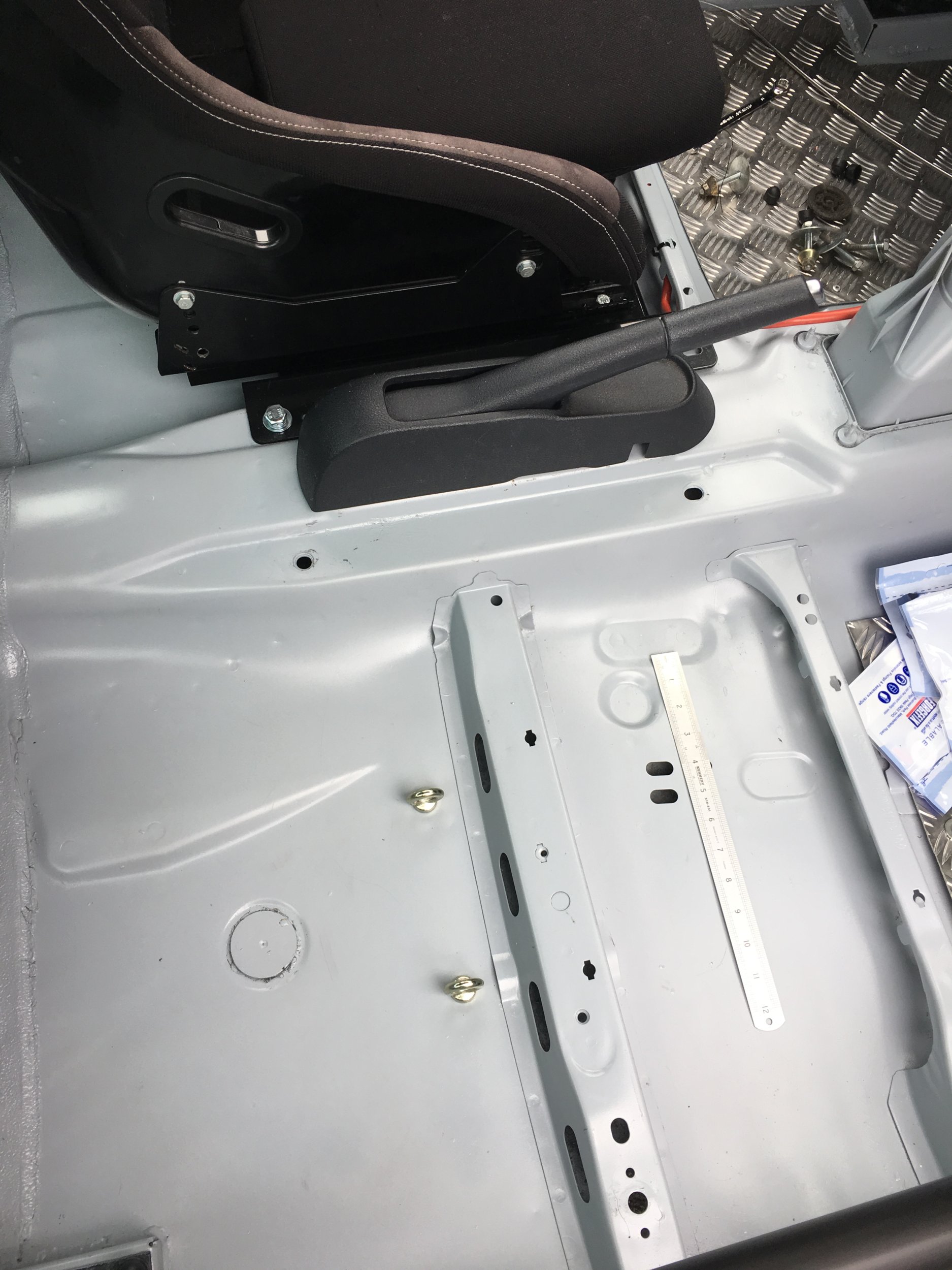

I will get pictures of where I put mine. But behind the rear of the handbrake the tunnel has a flat spot, drill it and put a spreader plate on the underside. Fit another eye bolt there, might need someone to stop it spinning around as you tighten it (unless you can wedge it with a bar or screwdriver).
Crotch strap, drill the floor and use spreader plates, or get one welded in if you can with captive nut(s) on

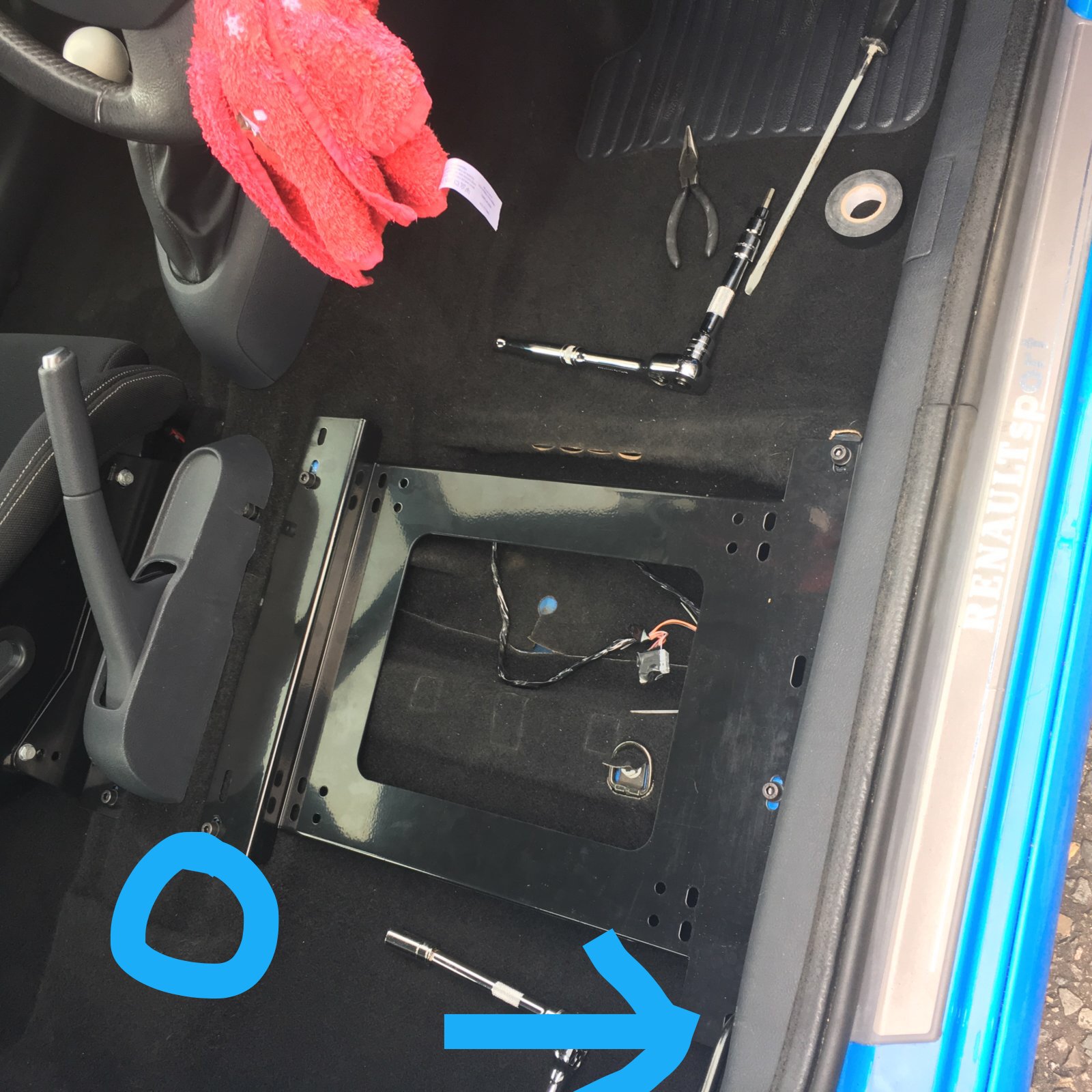

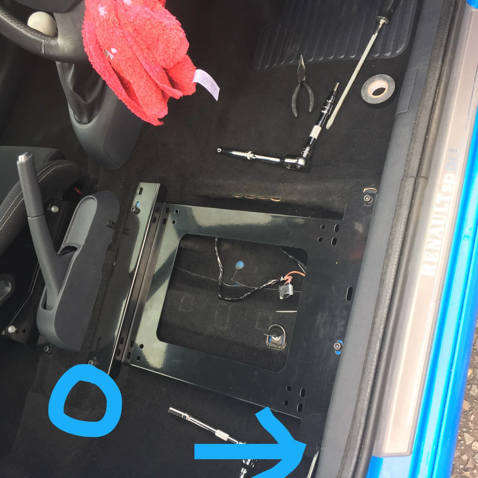

I will apologise, I've just spent an hour or so messing around in the garage with the Clio and didn't take pictures as said. However, the ring is where I drilled, outer eyebolt in the seatbelt guides hole. (Marked in up RB for you though! Ha)
I got my eyebolts and spreader plates from jjc race and rally

@Stuiemc i used the square ones, the one under the exhaust tunnel needed a small amount cutting off the corner. then gave them a good covering of underseal once bolted up

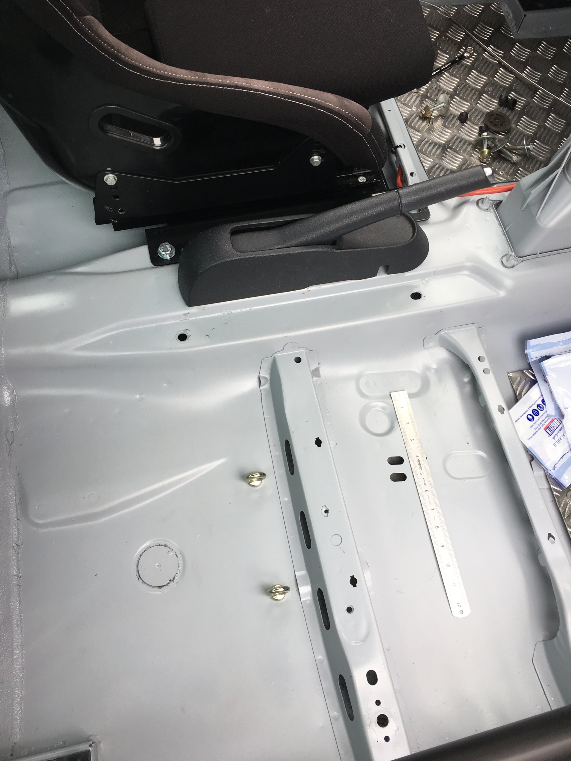

Did you have to drop the exhaust or remove any heat shielding? Going to order the plates now think I've got some eye bolts spare. Mounted the eyebolts and speaker plates for my crutch strap today.
They sit behind giving a 20 degree angle as per the Schroth guide.
