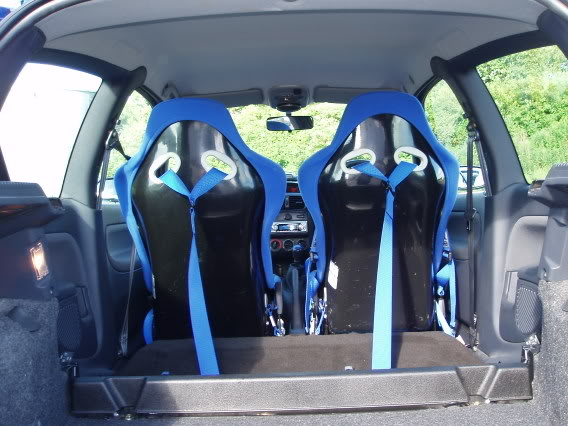

Anybody got any pics and details of were/how they mounted there harnesses to in the back of a 172/182?
Most people remove the rear seats and belts then use the points the rear belts use mate. I'm sure someone will be along with pictures at some point.
Not the best of pics, but you get the idea.
Depends on whether you go for 3 or 4 point harnesses. the lap belts are the tricky ones, and usually require drilling the floorplan to mount them properly.
