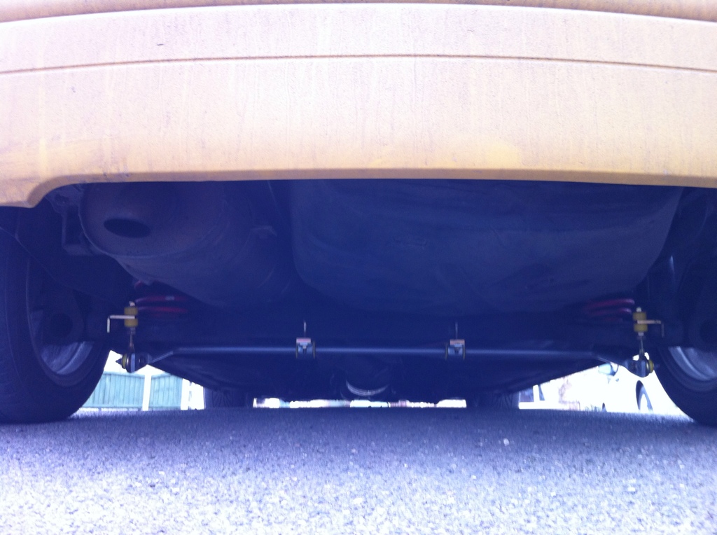

Aaaaand fitted...
Dirty shed is dirty. I haven't driven it yet, but i'm going out soon, so look forwards to seeing what the difference is. Obviously set it to the hard setting, because race car.
Ill see how it drives later on. Worse case scenario, I just knock it onto the other notch. It's not like it's a time consuming job, so I can mess around with it over the weekend if needed.

Djw John
Scotland - South

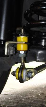

Now I'm not saying this is right or wrong but personally I wind the bushes and locking nuts down as low as they go, I believe that's how it should be rather than how you have it Paul. Happy to be corrected though!
It has 2 settings.
And cheers John. Ill give that a shot, although I'm sure the instruction photos are the same as mine? I may be wrong. It's going in to Diamon Motors on Tuesday to replace the manifold-cat joint anyway, so I'll ask Mick to check it over to see if its right.
Ive been out driving in it. Even at the low speeds I've been driving at (due to the exhaust), I can feel that the rear is tighter. Not as much sway in corners and feels like its steering through the front more (if that makes sense?!). I look forwards to trying it properly once the exhaust has been sorted by Mick.
Djw John
Scotland - South
Yeah that makes, stiffer at the back equals sharper turn in. If its too stiff in the wet it can become a bit tricky at the limit!
Let us know what Mick says, I fitted it by doing what seemed right rather than looking at instructions cos I got it second hand!

EDIT: Btw John, I looked at the fitting instructions for the ARB. It shows it to be fitted as I have, with the head of the bolt at the top of the thread.
Here's a photo off a website to show:
