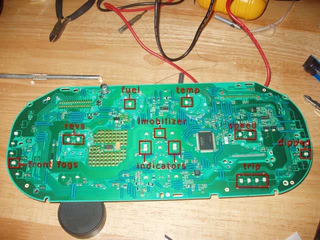

Guide to taking the clocks appart:
http://www.cliosport.net/forum//showthread.php?t=175675
it will be one of the ones on the left

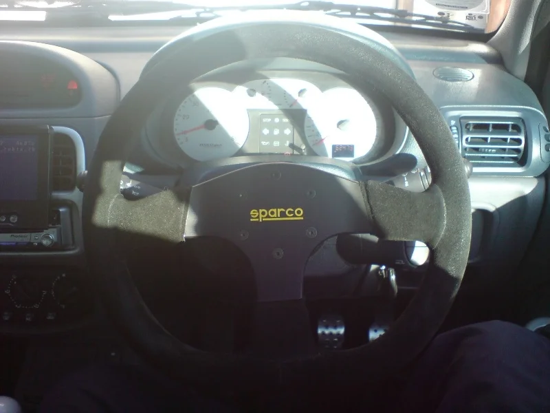

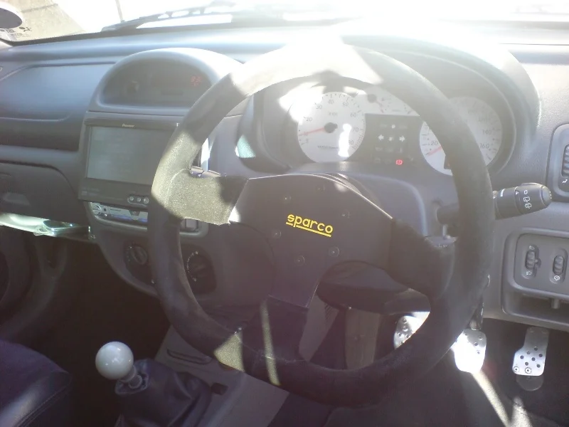

heres mine mate, i got my light removed via the clip tool from mike at rentech a good few months ago, hasnt come on since!
