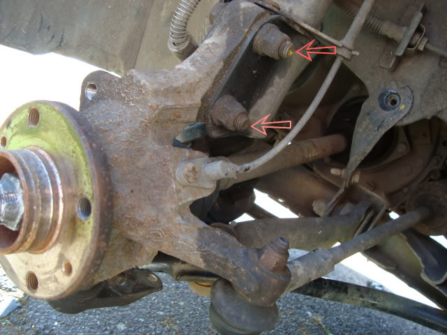

I'm looking to buy some coilies for my 182 but I'm under the impression that you need to know if you have cup suspension or not.. If this is true how do I know if I have this cup pack? My wheels are anthracite but I'm guessing there is a chance they could be sprayed after.

Do a search, you have to measure the struts, or hub, or something... It's something like 58mm = cup packed 56 = non cup...
It gets covered a few times a month so you'll have no trouble finding it

okay is ti 60mm for a cup? and this is gonna sound very stupid cos i am stupid.. where exactly do i measure? lol
