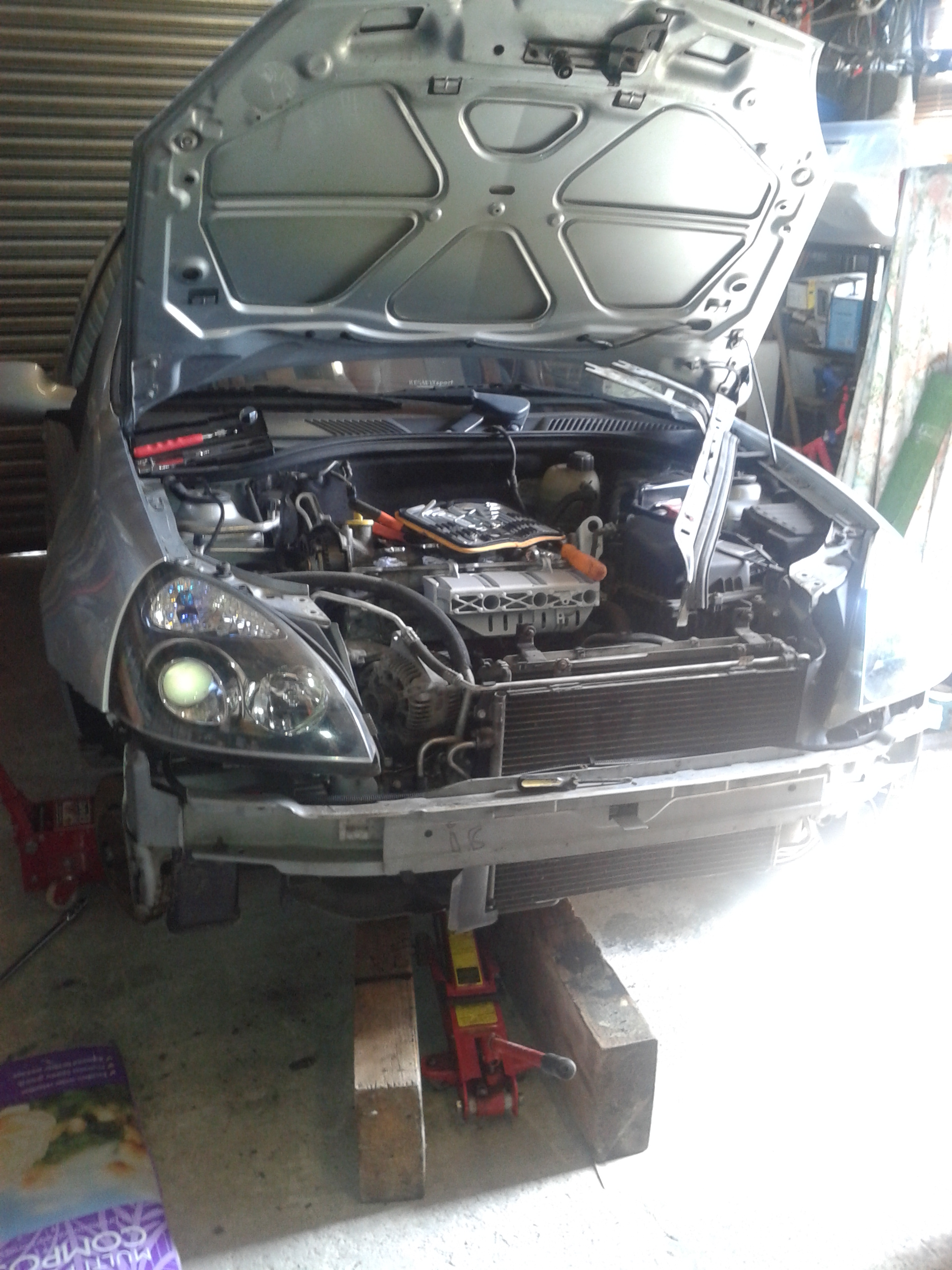

I've done a few of these belts now and can whole heartedly say they're 100% easier to do with the engine out, as previously mentioned with the engine in situ access is very limited and you'll find yourself forever lifting and loweringbthe engine to gain access to various bolts. With the engine out you don't have any of these worries obviously
Ads
  Clio 172
That's my mind made up then, clutch and water pump ordered and the engine is coming out! Has anyone had any luck with the lifting the engine out and leaving the gearbox in situ to save messing round with driveshafts and suspension?

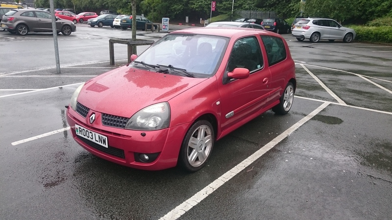

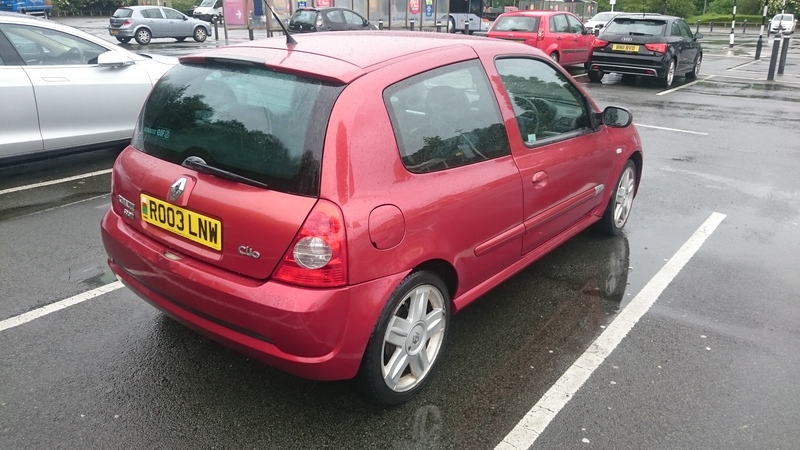

Bit of an update you all on the car, I drove it back today in the tipping rain, about 15-20 miles of twisty B roads. Thought I'd share a few thoughts, questions in bold.
The car had been dry stored for something like 8 months, so the drive back was a bit nerve racking. The car felt underpowered and sluggish at first, then I hit a long hill and it refused to rev, started missing and I had to drop to first to get to the top on a busy NSL road. Not a great start, I'm wondering if I've made a massive mistake!
Limped it to Tesco garage and stuck half a tank of Momentum in, I'm assuming what little petrol was in the tank was well stale! Started it back up and it was running a lot better, feels pretty normal up until about 4500rpm. However when hitting 4.5k it feels like the limiter is cutting in, EML light starts flashing and the car bogs down, then suffers from a lack of power until it's turned off and restarted.
Does this sound like a knackered dephaser throwing the timing out when the PCM tries to engage the VVT system? Or have I got another underlying problem? The pulley is really noisy and the fact it wasn't changed with the last cambelt in 2015 doesn't fill me with confidence that the local garage who did the work got the timing 100% either. Any similar experiences of knackered dephaser pulleys having this effect would make me feel better, but I think my only real course of action is to get it changed, get the timing bang on and the engine thoroughly serviced and see if it's better.
As for the rest of the car, I'm pretty happy. It's really clean and tidy, even underneath it's immaculate with no sign of rust that I can see. Suspension all feels nice and tight with no knocks, the brakes are really sharp and positive, everything in the cabin seems to work (F&R heated screens, climate control, xenons, auto wipers etc) and the half leather seats are still supportive and in good condition. Even the steering wheel still has its thumbrests!
Not so good points are the gearchange feels a bit 'wooly'. (Is there a cheap quickshift kit available for these?) and coming on and off the throttle can be felt through the gearknob so I'm definitely going to polybush the dogbone mount. The steering feels nice when it's loaded up, but in the middle it feels a bit soft and vague, is this steering rack mounts going perhaps? It's also not quite central, so once the other jobs are done I'll book it in for wheel aligment. And it desperately needs a set of wiper blades. Think that's about it.
So, not quite the bargain I thought I was getting when I bid £580 thinking a £175 cambelt kit would be all it needed, but even in it's current poorly state, in the pouring rain with mismatched underinflated tyres, the sheer grip it managed to find on the wet roundabouts on the way home put a grin on my face. I can't imagine how much fun a well sorted one of these will full power must be, and can't wait to get it up to scratch!
A few pictures:
Have got a load of parts arriving in the next few days, I've probably spent about £350 so far, and I still need to pick up the bushes and the cam locking tools. I was going to order the genuine Renault tools, but will the Laser set do as I'll have the engine out? Just thinking I'll have access to use an impact gun to loosen the pulley bolts which should be less likely to bend the horseshoe used to lock the cams.

That looks like it will be a well tidy car polished up!

Is that flame red? Looks rather unloved!
Just seen the first picture, looks better there!
