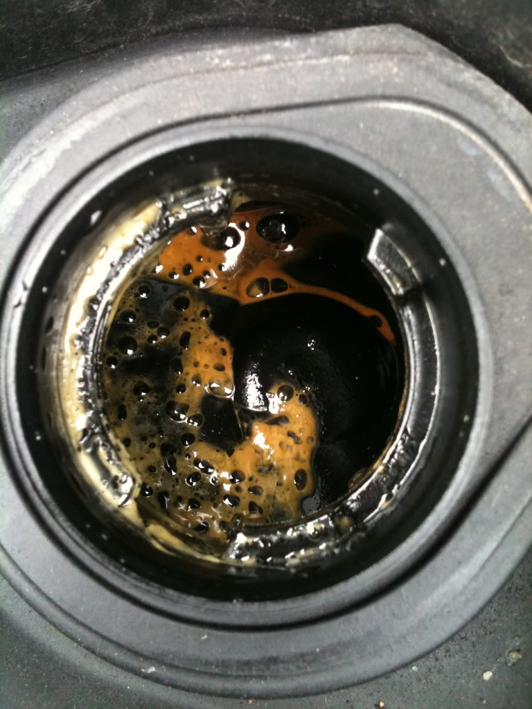

Right, well I was changing my side light bulbs today and thought why not look at the oil.
I opened the oil bit and it's got, thick mouldy looking cheese round the rim.
I went to a local car garage, explained it and they said straight away it's the head gasket.

Does it overheat?? If the answer is No then no its not... second question.. Do you do short journeys everyday? If yes then its just built up condensation
Flush out the engine and refill with semi synth oil. The sludge is a sign of short journeys as stated previously and / or cheap oil wityh a poor visco range . Hand in pocket time and 5w / 30 time.:)

It doesn't overheat no. & yes I do a few short journeys, 5-10 minutes. However I also do a good 35minute run everyday.
I bet if you go out for a blast for half an hour then came back and had a look it will have gone away.

Easy way of checking for head gask problems is to check the Rad cap, if there is a porridge type "sh*te"" <<< TECHNICAL WORD on the cap then you could have a problem.

Yeah it's like a mouldy cheese looking thing lol.

& nailed it down the M1 today and back a good 50minute run, got back had a look, and it was still there lol.
D4F is your engine code, its nothing to worry about happens to pretty much all of them no matter how much they get used due to the plastic cam/rocker cover. Moisture gets in and condenses, mixes with the oil and et voila you get a little bit of sludge.
As long as its not excessive and theres nothing on the dipstick untowards don't worry about it. Never actually known a hg to actually fail on one.

Just took a picture to upload and this is what it looks like..
