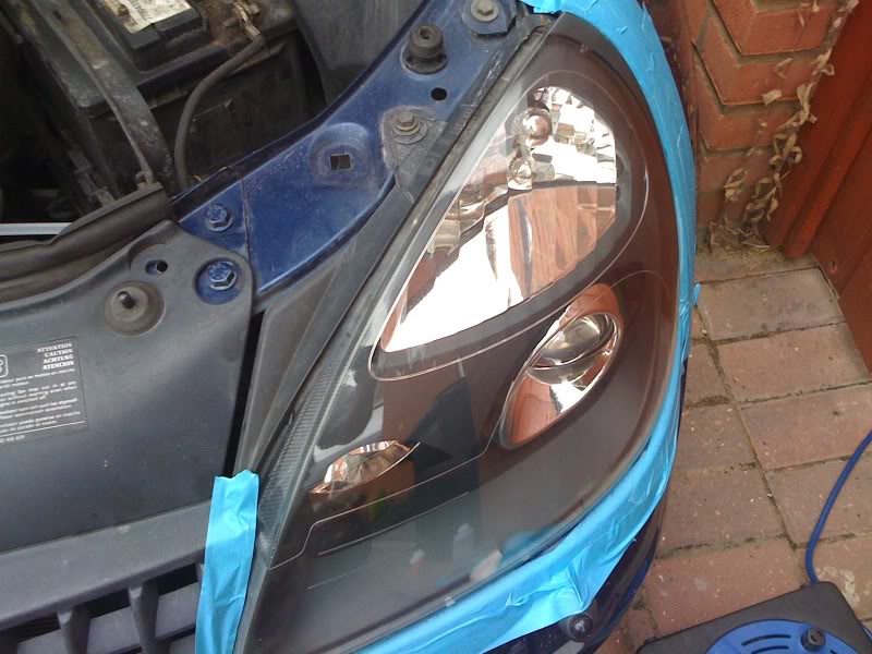

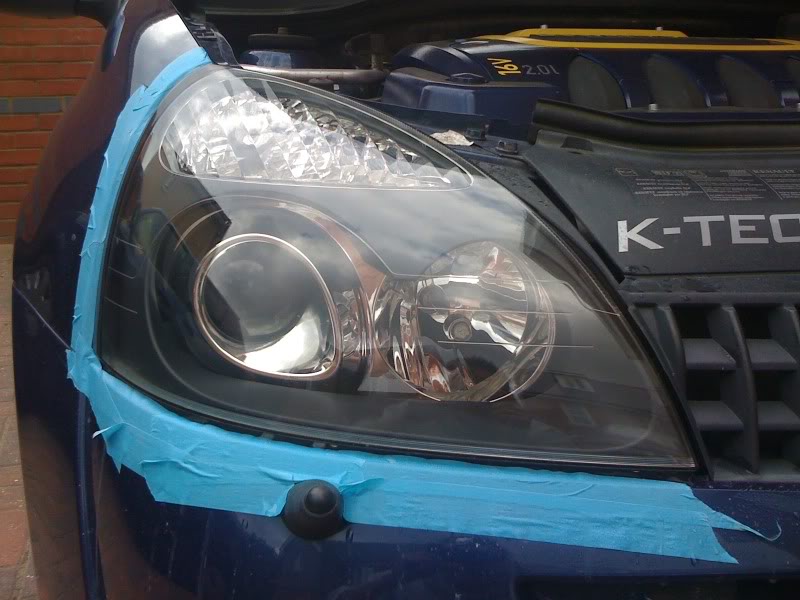

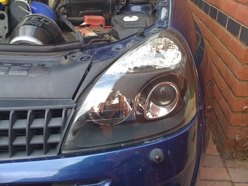

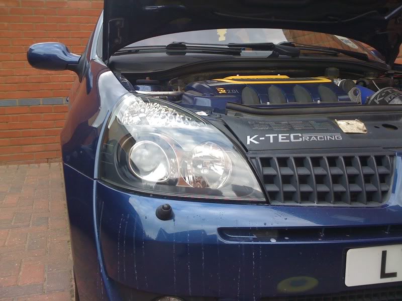

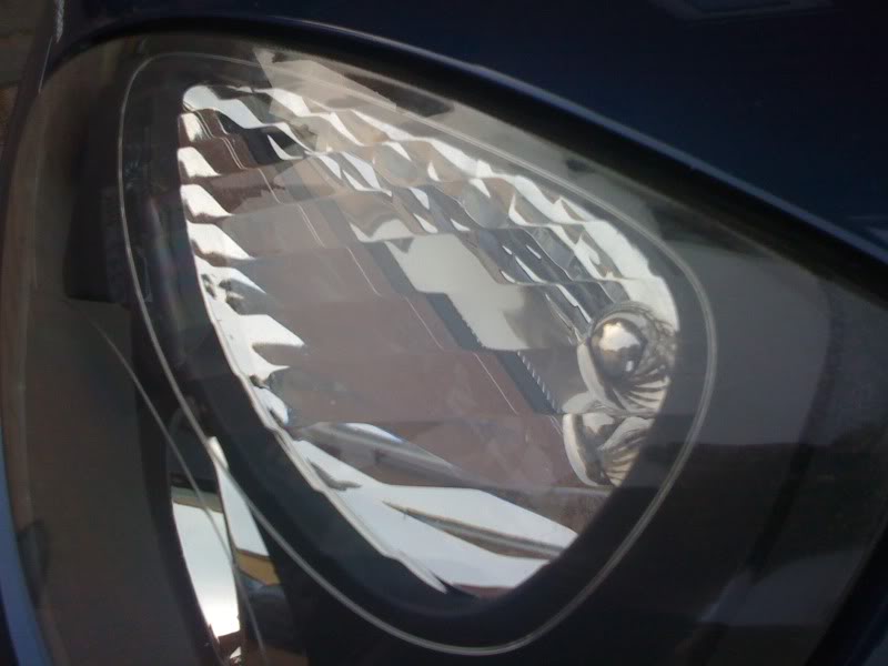

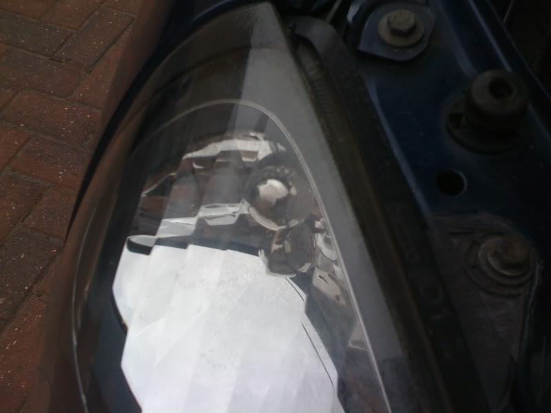

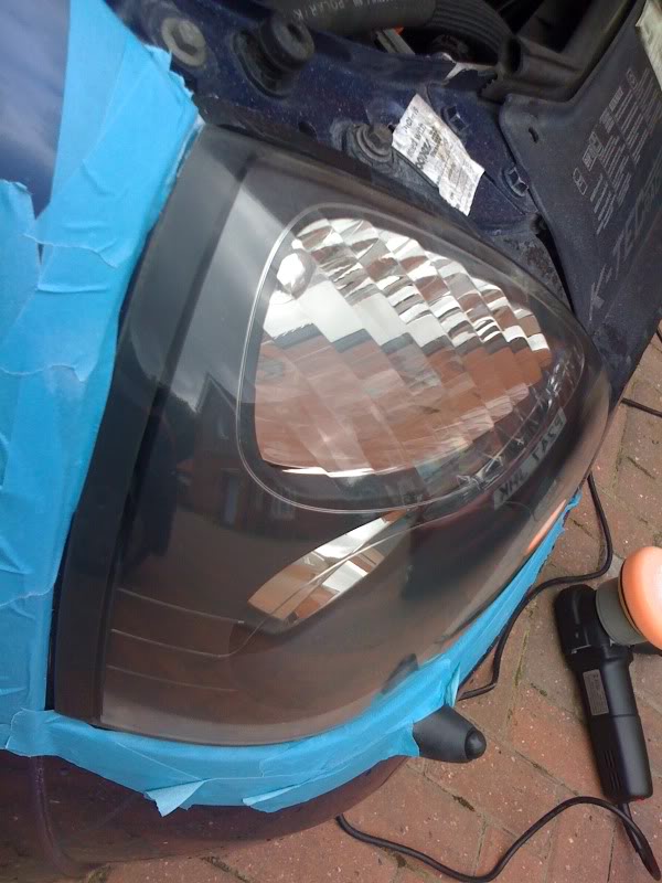

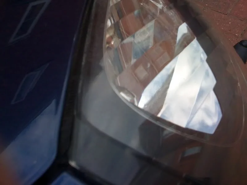

Well my headlights have suffered from that horrible markings over them for a while and I finally got My DA through today. SO like any kid at christmas I had to have a quick play.
I wet sanded with P1500 first then tried out each pad to see what happened using the various pads.
Used a combo of Menz and PO 85 RD 3.02 and Poorboys SSR2.5. Finished off with Menz PO 85 RE 5 on the yellow pad, then sealed them with Poorboys EX-P sealent.
Results....

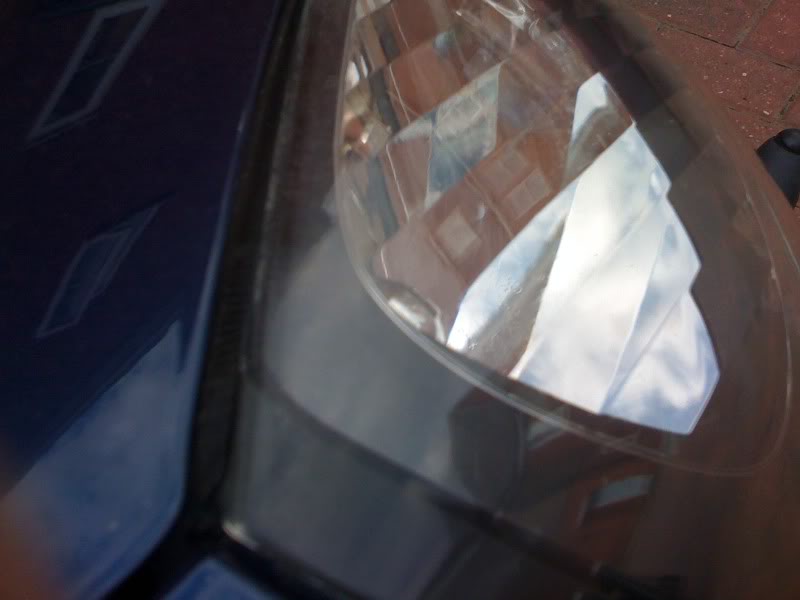

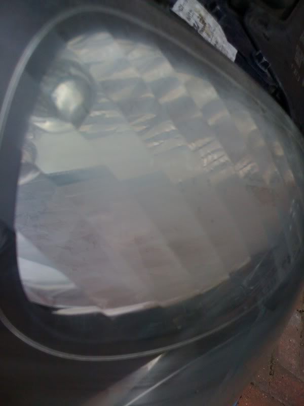

Wet sanded..

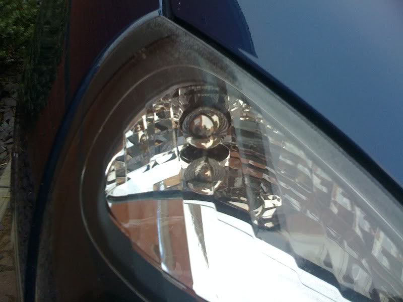

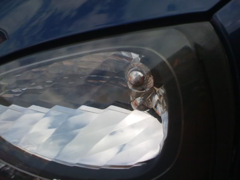

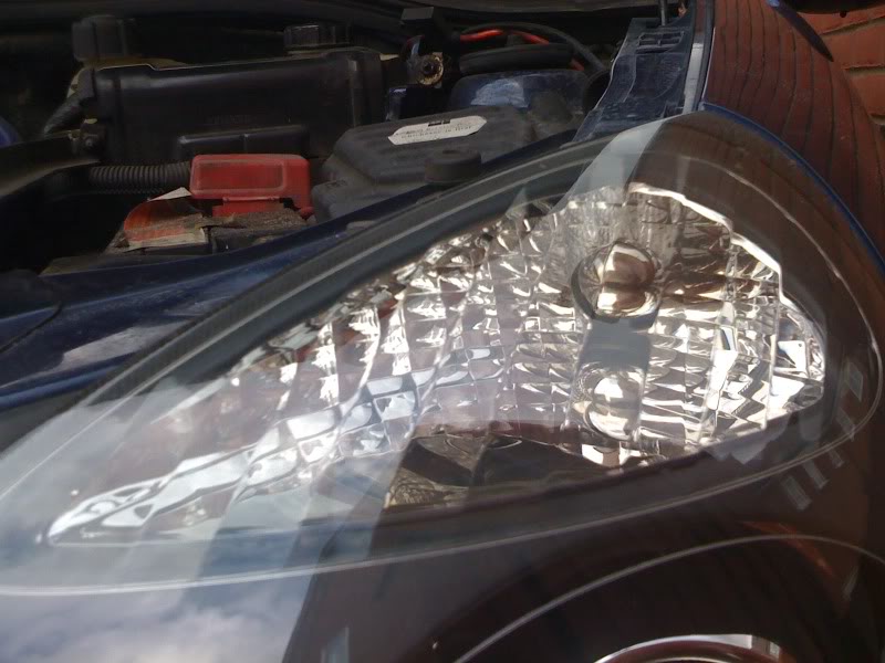

After Polished
Results..
Il probably go over it again soon as the bits up the top nearest the engine bay are quite bad but for now its all gravy baby :)

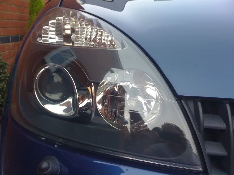

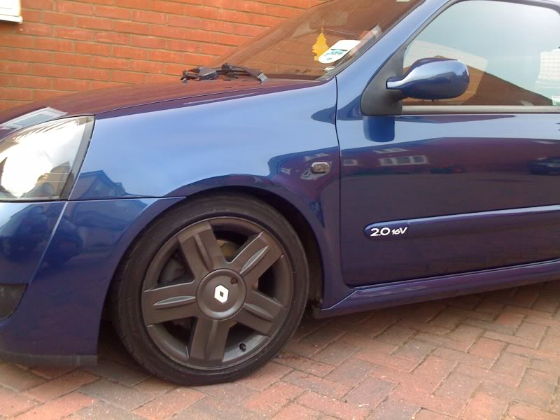

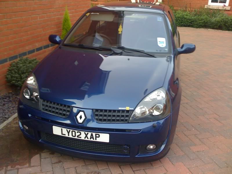

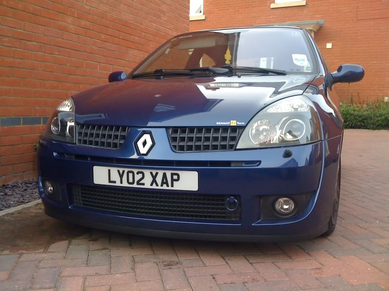

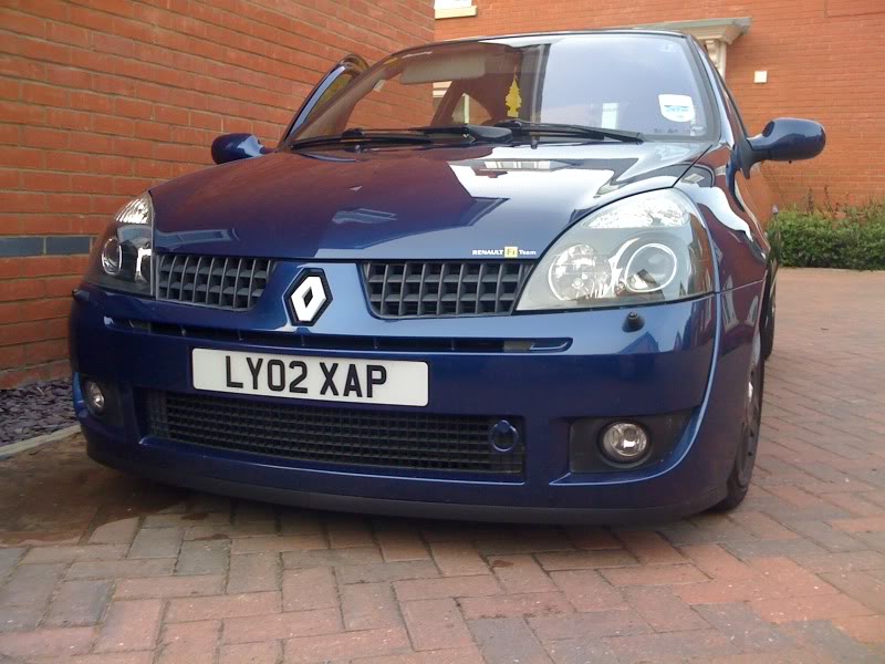

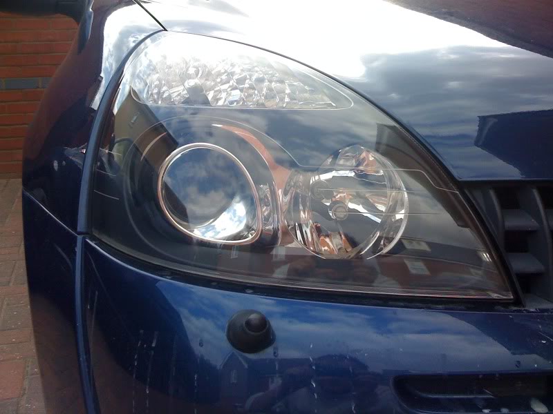

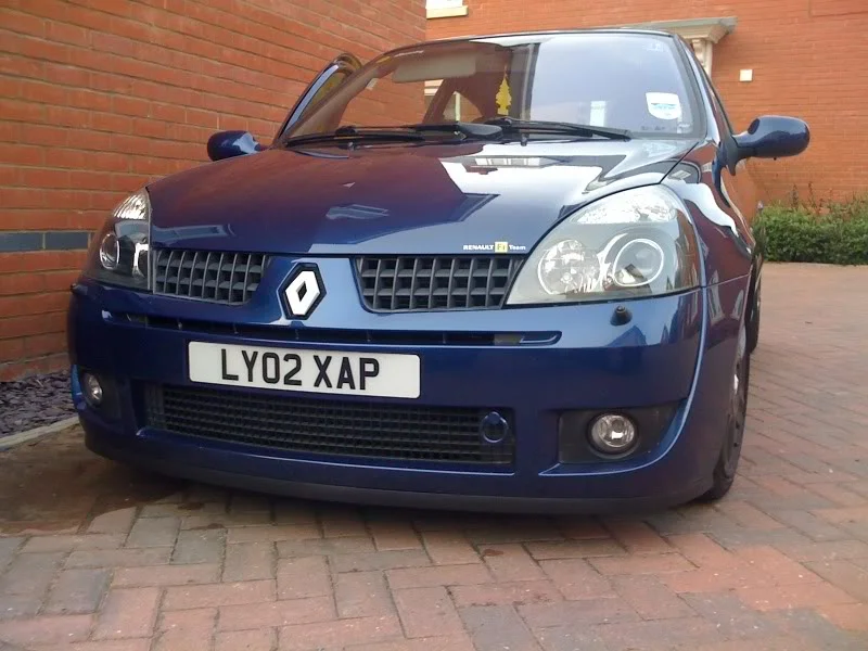

Couple of pics after a quick wash today..
Washed with CG Maxi Suds II, dried and used Britemax Spary and Shine quick detailer (had a sample sent to me :) )..car was waxed about 2 weeks ago with Blue Velvet and hopefully next weekend or weekend after it will get a seeing to with the DA :)

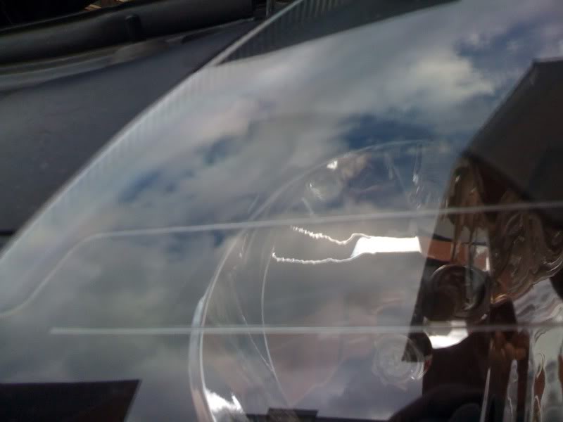

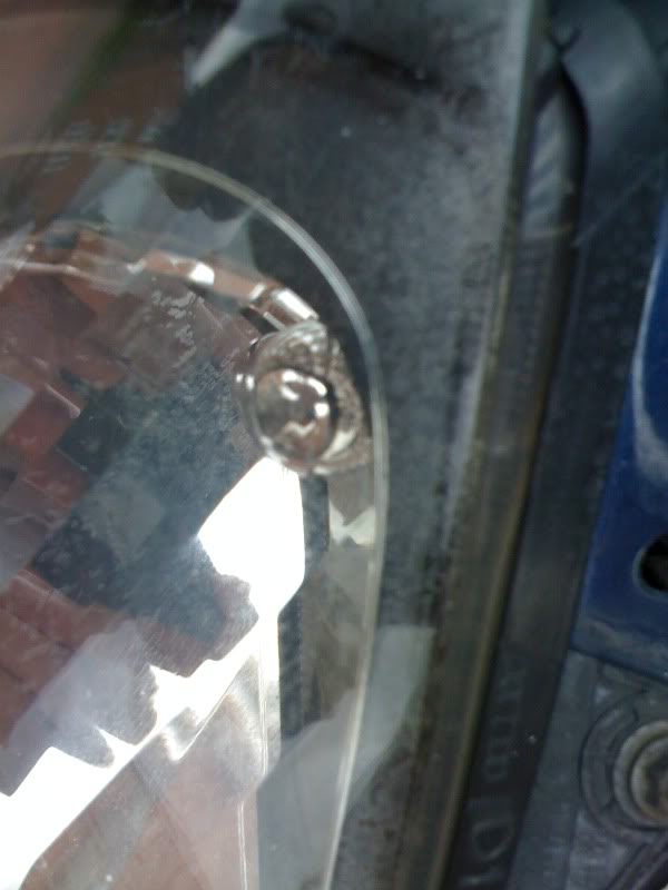

Healights still okay so far..like I said a few marks I couldnt get out..need to use a more agressive wet and dry to get these out(if you can make them out??!) You can see it on second photo down
  "Navy" N17 TWO
I've got the very same marks on my headlights, what did you use to buff it back up after wetsanding them?
  Bumder With A Buffer
Used my new spanking Kestrel Das-6 :)
Then sealed them with some Poorboys EX-P Sealent.
Like I said they are not 100% as there are marks a lot deeper than I first thought....BUT they are a huuuggee improvement on what they were like before!
Read the OP you ned! ;)
Used a combo of Menz PO 85 RD 3.02 and Poorboys SSR2.5. Finished off with Menz PO 85 RE 5 on the yellow pad, then sealed them with Poorboys EX-P sealent.
I think the SSR2.5 did the most removal to be honest..it was hard to tell really
