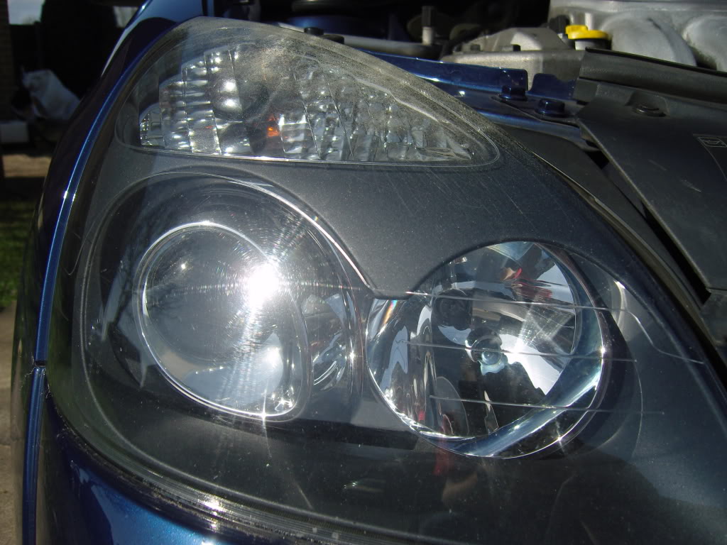

Had a few hours spare this morning and wanted to sort out the headlights as best as possible. Not quite sure how they are this damaged, but let me know if im not alone.....
They have been bugging me for a while, sure you can see why:

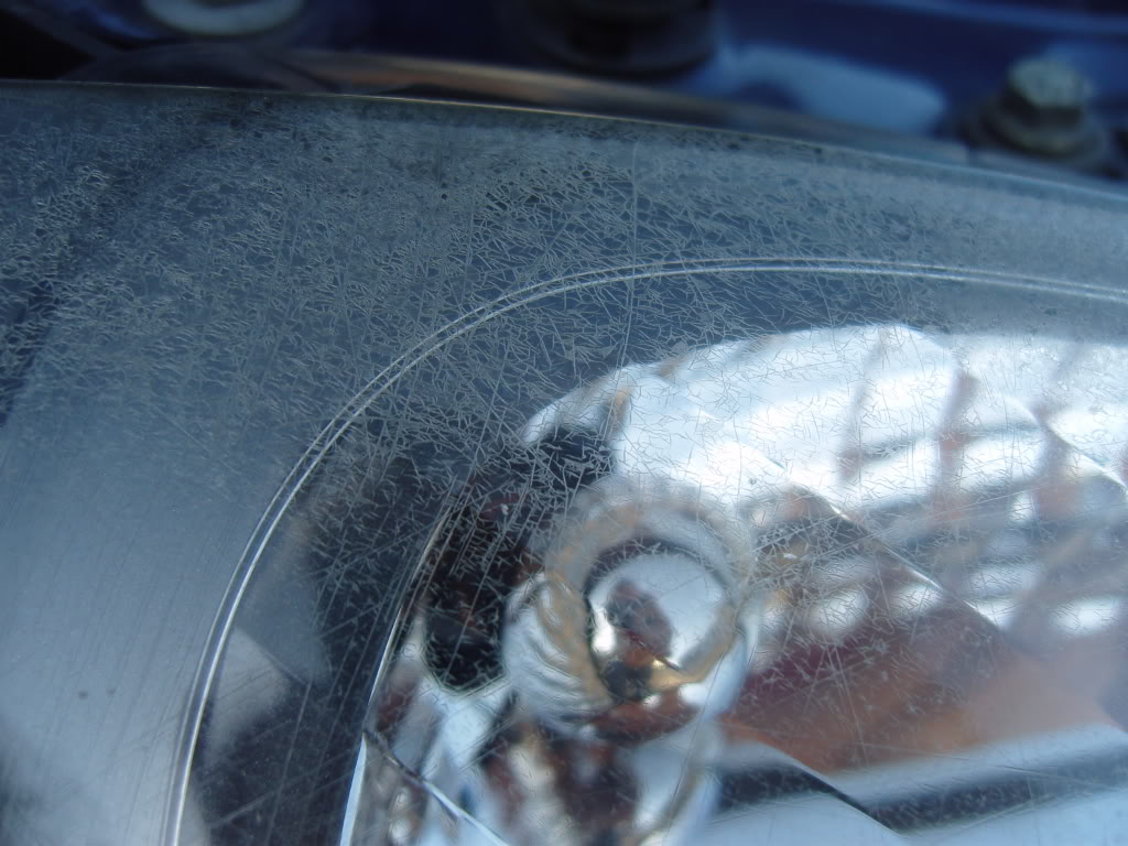

So after some wet sanding (1000, 2000, 2500, 3000) I got a nice consistent cloud (yes, this is the other light, the pic of the first one was poo):

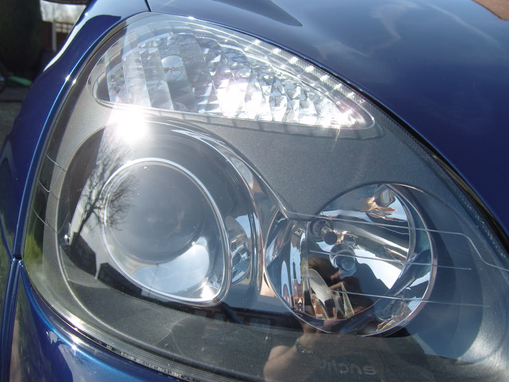

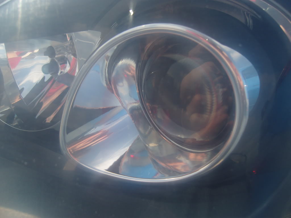

some machine polishing later:
[There are still some imperfections, and i know with another more intense attack I could get a slightly better finish, but well over 80% corrected and very happy with the results.

used a kestrel DA, with PO203S on a Menz 80mm white, followed by some PO85RE5 on a 80mm yellow. Started off with a slow pass at speed 2 to move the polish around, then a few passes at 5-6 with a spray of water on the pad each time to make sure the polish was being broken down enough.
It was the wet sanding that allowed the polish to work the best. All in the prep.

That is a variation of plastic oxidation...very common now since everyone is using plastic covers for the headlights. Some cars are prone to this due to headlight shape and size. If the headlight has some horizontal surfaces the UV rays can attack those areas with more intensity. That bit where the turn signal sits is very horizontal and receives more UV rays than the rest.
Once you polish the headlight it becomes very important to use good synthetic wax with UV protection to slow down this process.
I think you did a good job, maybe a thinner polish will improve the cloudy look and then 3-4 layers of wax will keep it shiny.
