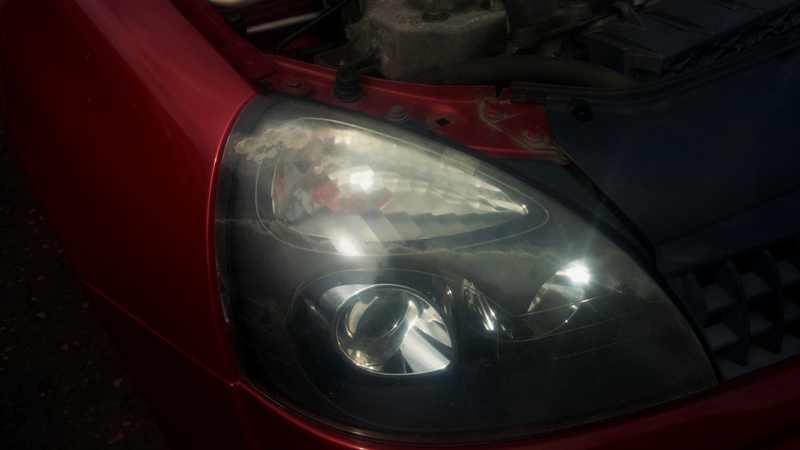

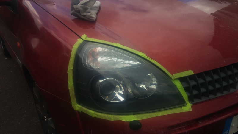

So got the 3M kit of eBay, looked at the Meguiars kit but thought you will get better results sanding the lense down first the polishing up rather than just the compound with the Meguiars kit.
The lenses themselves were in terrible condition, weather it was a type of glue on it or something else, it just chewed the first sanding disc, so save ruining the rest of the pads i cracked out the 240 grit wet & dry. What a difference that made, putting a wee bit of elbow grease in first then using the 3M kit after. So my advice would be spend 10 mins a light first with some 240 Wet & dry before using the kit as you do not get many pads.
The pics aren't the best but what a difference after tackling this.
Before

After

240 grit?! Holy hell. Did you have that left over from sanding down metal? God forbid someone follows your advice.

It worked for me, if you really want work up to 400 then 500 then 800, as i said i done this by hand to get the worst of the rubbish/glue residue of as it was just chewing everything else up.

You didn't work up at all? Christ, Ian - there are going to be a heck of a lot of scratches in the plastic, fella. Most likely irreparable too.

2000. Yes, it takes time. But the simple fact is, anything lower and you'll not get the marks out. This is plastic, not paint. There are no layers, it's a single unit. Start off with 2000, work up through 3000 and 4000 and then polish back.

My headlights look worse than that pictured and were quite pitted, one light I started at 1200 and this alone left some deep marks that took a bit of time to remove, the other only needed 1500, working back up to 2000 and 2500 before using a cutting polish. If they did have some form of glue on them? you should have used a chemical cleaner like tar and glue remover first.
To those reading this thread looking to do it themselves, please do not start with such agressive paper.
Totally get where your coming from, but they were really bad - whether or not i wasn't going at them enough so never went crazy mad i don't know, but as said it worked for me and all i had at the time lying round. I need new lights anyway due to them being buggered inside with the clips burst.
