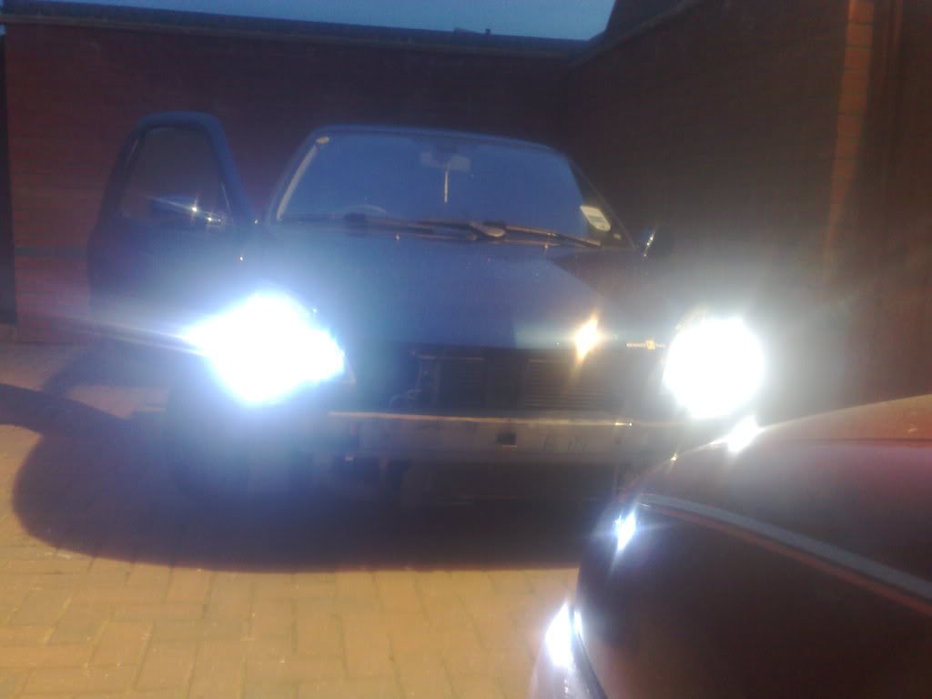

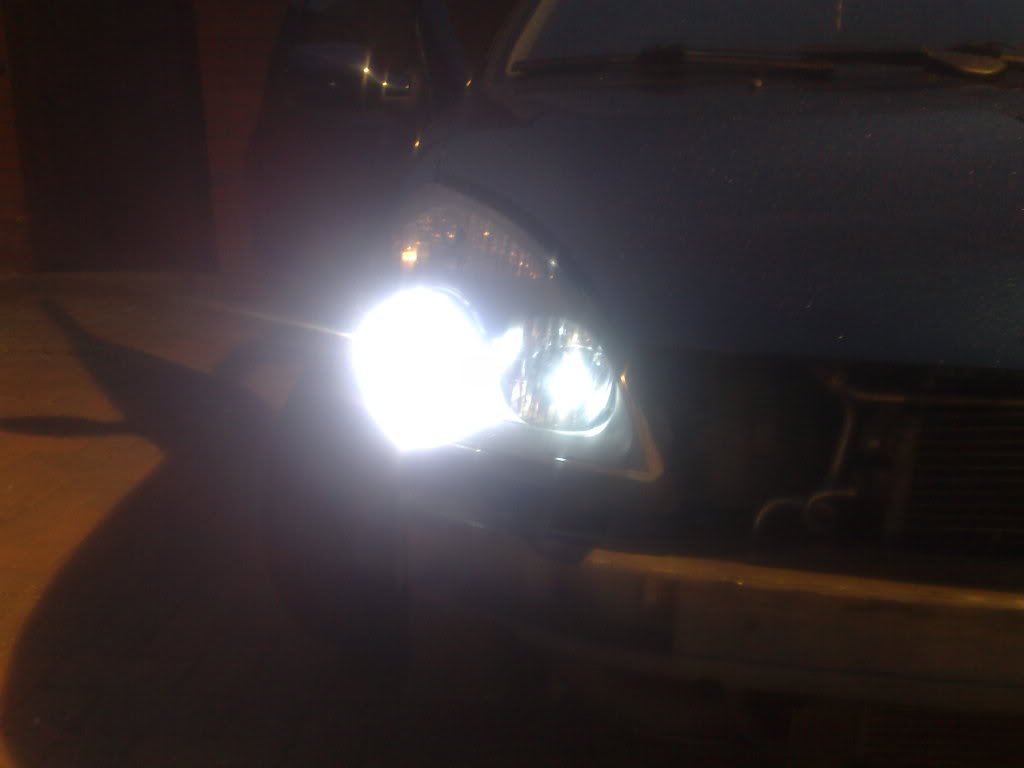

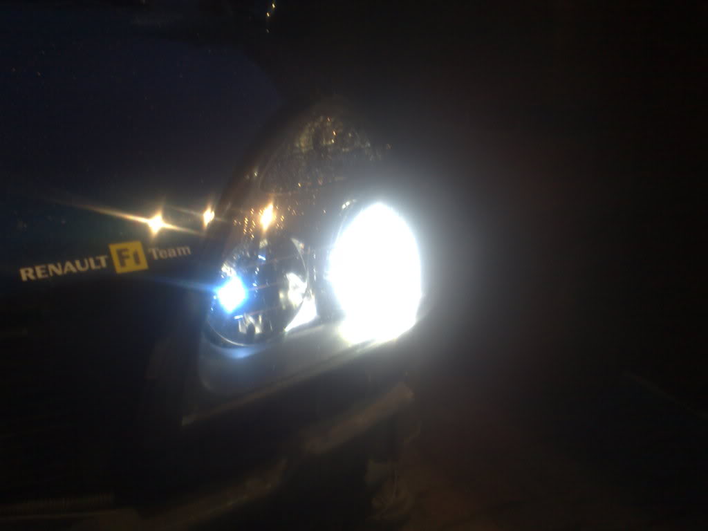

Right this is a pic of how im "rolling at the moment.. passenger side standard drivers side 6800K one. Im aware it looks gay but at least they will function all the time. Is this an MOT failure as thats fast approaching? Im hoping new ones will be here in time tbh!
Passenger...
Driver
Fairly noticeable that they are different colours yes?!

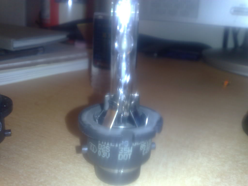

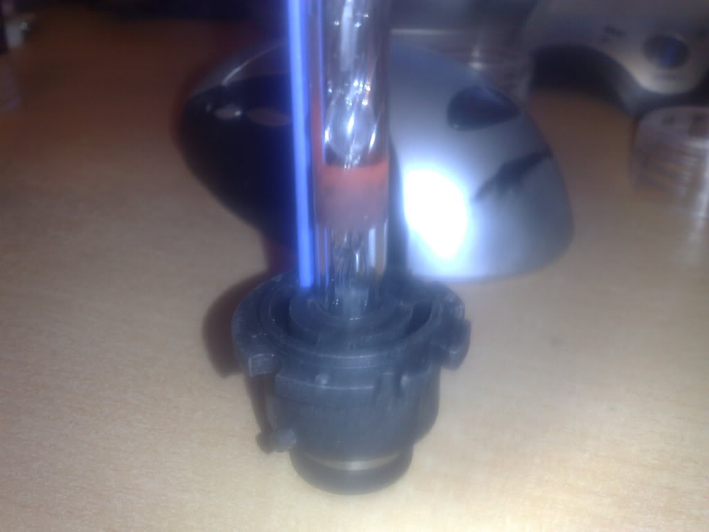

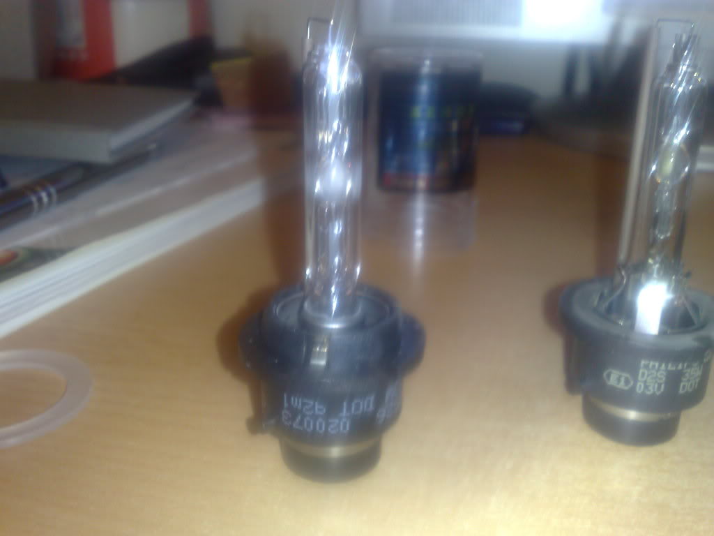

Finally pics of the old vs new bulbs.
Apologies for the crap camera shots the N95 is usually good for photos :(
Old Driver Side
Old Passenger side (the one I put in there just now to try
New one thats was in pass side that seems to be playing up
As you can see the old passenger side one has a flanged type metal ring that goes up the shaft where-as the old drivers side one doesn't (well not as much)
The new one has not got this at all. Also only just noticed that the old ones are D2S's were the new ones are D2R's. Thoughts? My next thing to try is the new bulb in the drivers side to see if it plays up in there. If so then faulty bulb :(
Hokay tried new passenger side one in the drivers side...problem follows to the drivers side so looks like a dodgy bulb :( FFS
