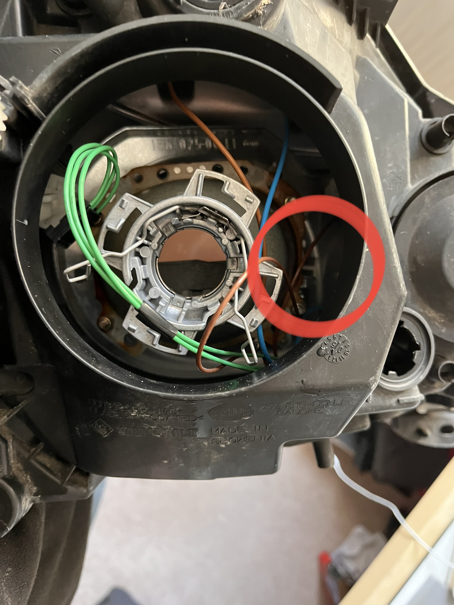

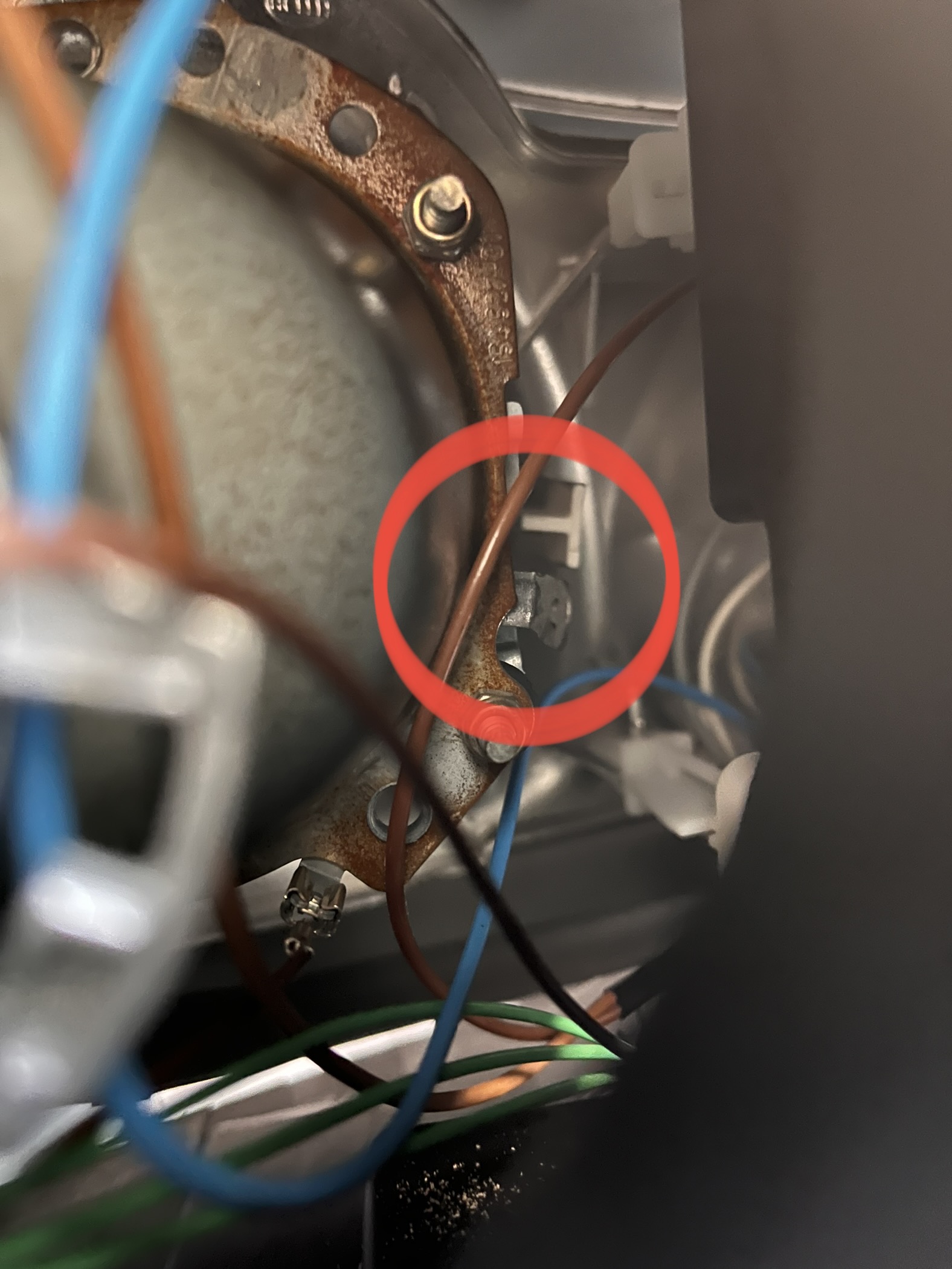

ill get one in the next day or so, I’ll need to dig my spare headlight out of the loft. It’s a small flimsy lever inside the light unit. It’s a bit of a pain to get too as well, but it’s defo there.

Sorry for the delay.
so basically it’s this flimsy little thing
you need to swap them to the other setting and that should sort it out.
