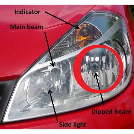

( I have attached a pic to show which headlight is not working)
