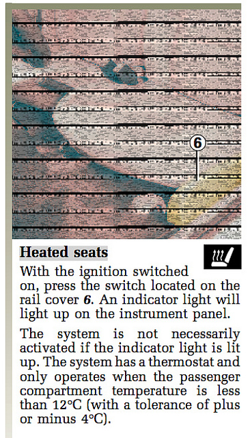

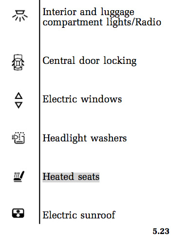

Heated seats were an option, why not figure out how renault were going to do it and do it that way
There is a fuse for it

And the buttons were going to be put on the sides of the seat
Screen Shot 2012-02-15 at 14.05.32 by sbridgey, on Flickr
The images were taken from the renault online manual so apologies for the quality of that picture.
Problem with going for an OEM install would be that the cars computers wouldnt be albe to tell it what to do. I may go down the scrap yard and get the switches off a renault though so I can put the buttons on the side of the seats
