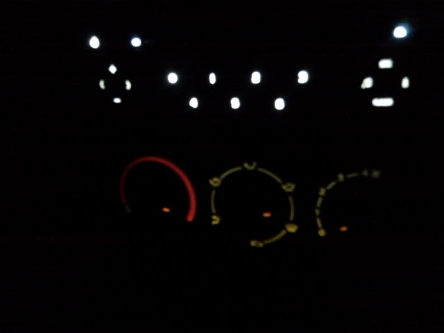

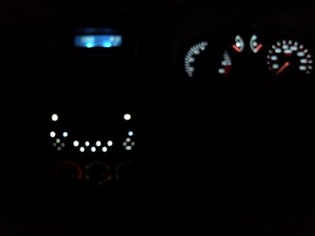

Heres the finished work lol although they do look slightly orange they are identical to the stereo.
Oh, yours looks exactly the same colour as mine.
Must just be me, being a fussy git. Gonna try and cut out a new filter to put behind it at some point. and put a blue smd in the re-circulation button.
