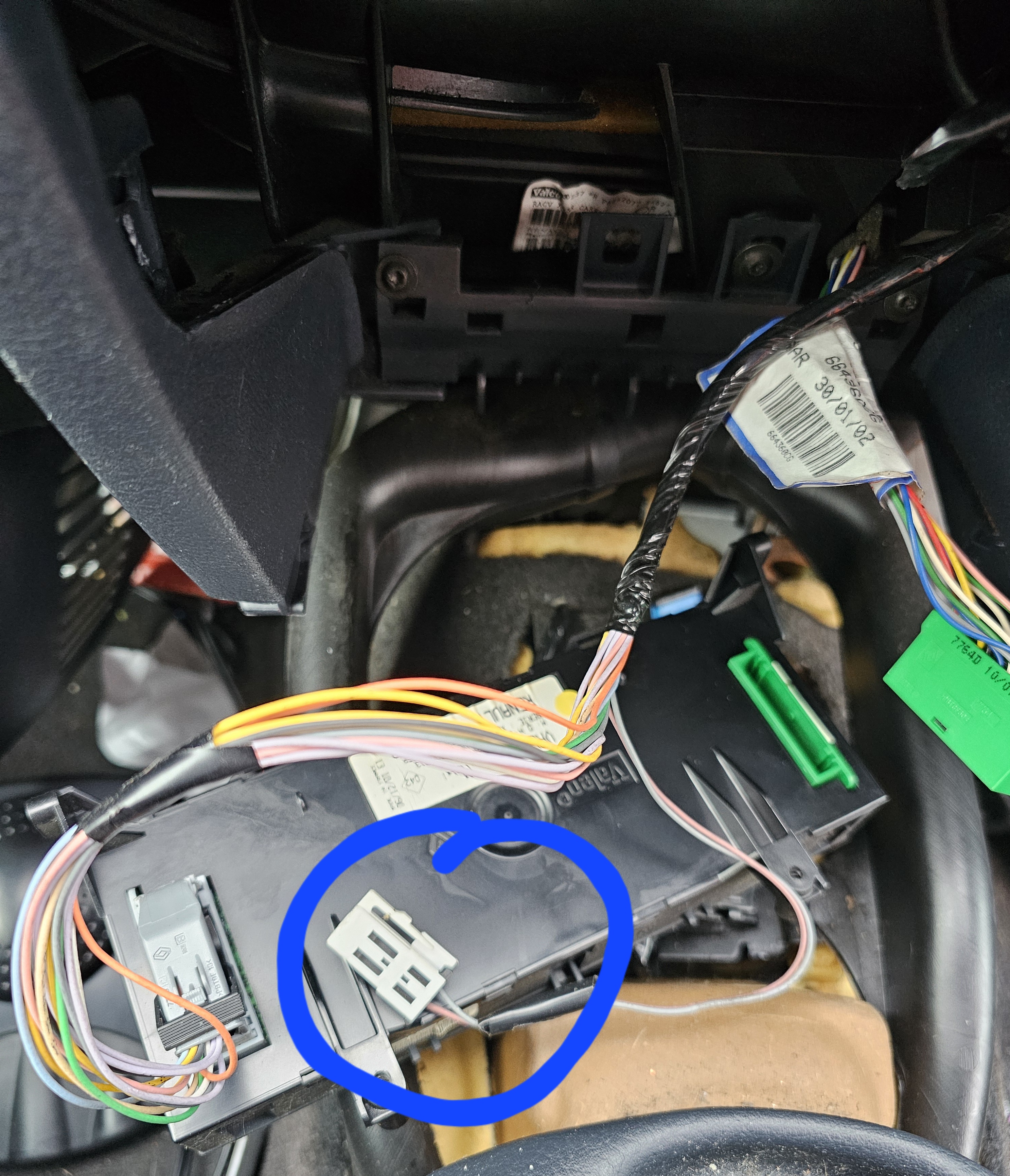

And anyone know what this plug is?
It wasn't plugged into anything and comes off the loom to the climate control panel
