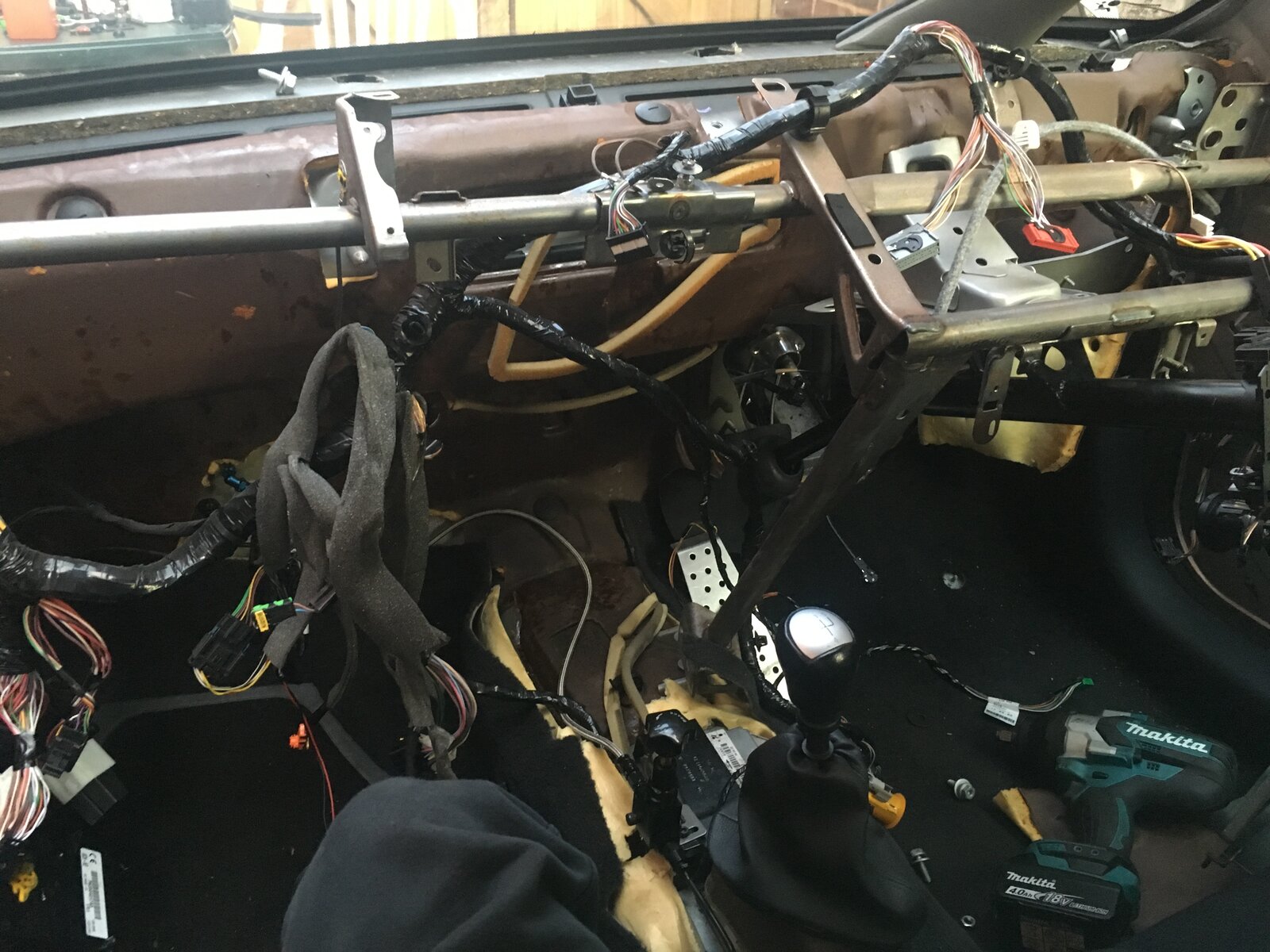

From exploded view i gather the matrix goes in from the side? (as in remove centre console)
Any insight would be appreciated!
Just take everything out, it really doesnt take long and is straight forward going back in
