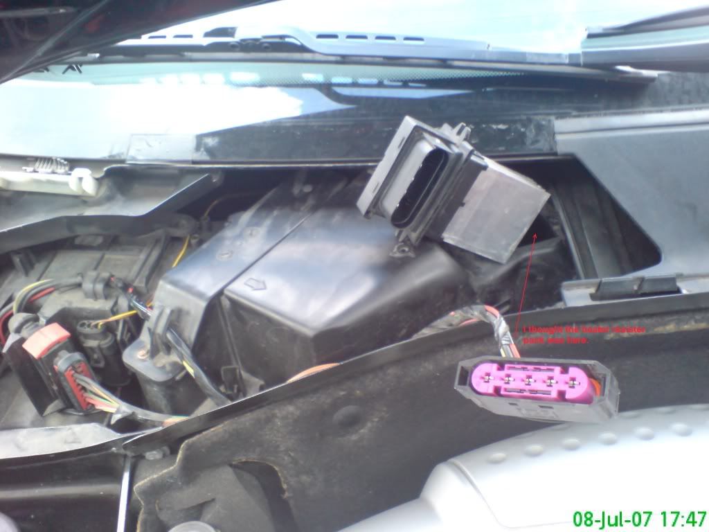

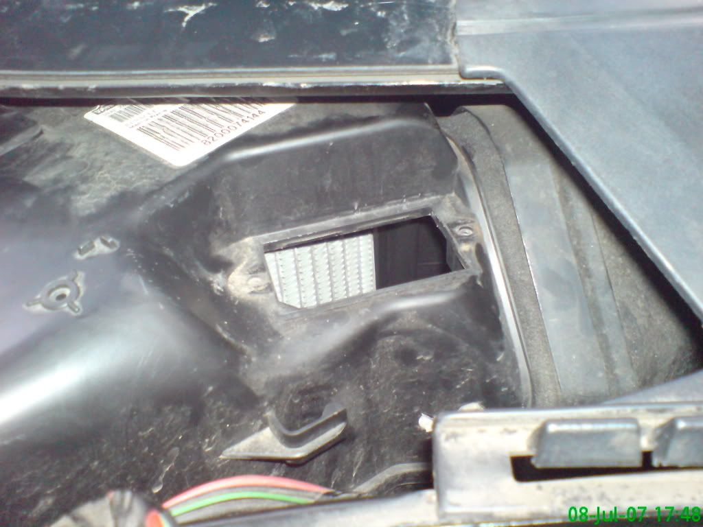

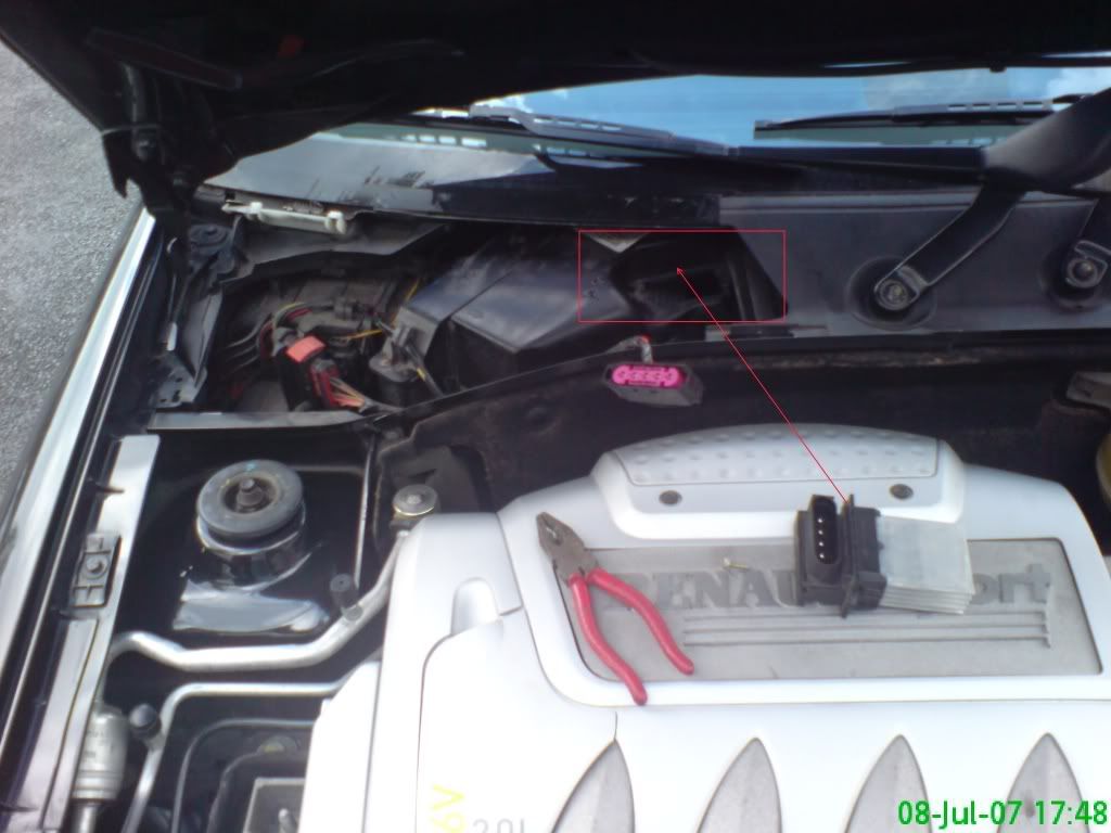

Yes, the air con unit seems faulty, and i've been told it is probably the heater resister pack. Am I supposed to be looking for something like this:
http://i106.photobucket.com/albums/m271/BrianR_04/DSCF2553.jpg
http://i106.photobucket.com/albums/m271/BrianR_04/DSCF2552.jpg
This car isn't the same as mine though and not sure if it is in the same place.
The unit seems to go on full speed when pressing the off button and the flow control buttons don't work. Here is my original thread: http://www.cliosport.net/forum/showthread.php?t=170197
