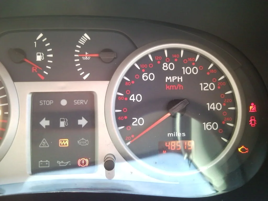

Jumped into the car today and when i went to pull away i knoticed a light on the dash. it looks like a heartbeat on a monitor. i thought ill give it a minute to see if it clears and carried on driving. thats when i realised that the bugger wouldnt rev. its ok under very light acceleration but when you hit 2500rpm it splutters a bit and wont rev past 2900rpm. ive tried switching the car off and then running it again only for another light to come on, this time on the bottom right of the dashboard. ive put a pic below to show the two lights on.
Any ideas?
thanks

Jumped in the car today and the light in the middle of the dash didnt come on (the one that looks like a heartbeat) but the engine management light stayed on. today it drives fine, no power loss and will rev right up to the limiter with no problem.
yeah will do. i tried the in-dash minor fault finder thing today (by holding the button on end of wiper stalk before turning on the ignition) but it came up fault clear. im guessing the fault code will be stored in the other bit of the ecu

99% there is a problem with the loss of signal between TBW TB and ECU or throttle pedal. If that happens even 4 a millisecond ECU goes into safe mode and your dash looks like Xmas tree :D
Problem could be that the TB itself is malfunctioning and needs replacement too.
