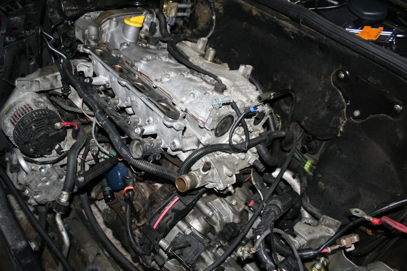

yea some times the wires get snagged etc, the sonsor wont move as its bolted in, make sure the conections are clean on the sensor plug etc.
is prop a sensor though. easy to change, you just need a deep socket and a some water LOL
you can see the sensor, its on the (right hand SIDE not the front sorry) of the block, sticks out like a marker pen (black with silver bolt on the engine)
has two 10mm bolts just above it , either side
Had a little wiggle, but didn't seem to make any difference. Its still really chuggy and the coolant light is still flashing.
