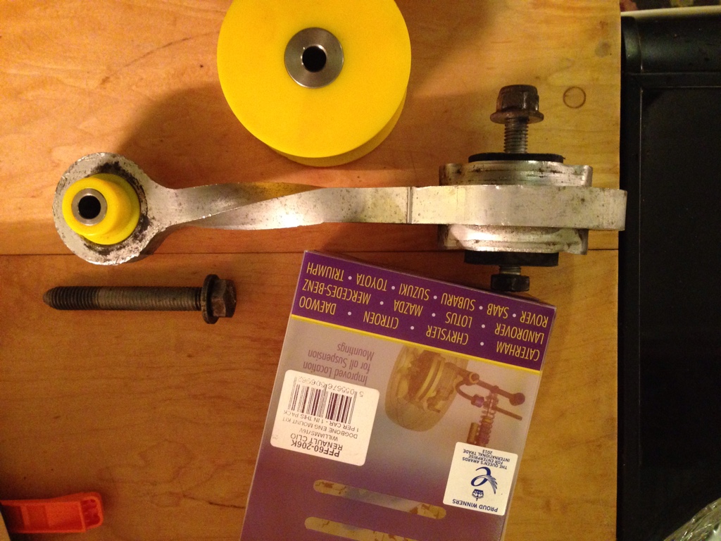

Hi - I'm trying to fit bushes to the dogbone mount but have found the bolt at the gearbox end (smaller bush) the OE bolt is too thick for the collar
I've now noticed the kit states for Renault Clio Williams and 16v. It's PFF60-206K
Car is now undriveable as I destroyed the old bush.
Any ideas welcome :)
Yep don't look like a phase 2 kit to me bushes in phase 2 are purple iirc
Thanks - the eBay add clearly said 182 and Trophy so they must have screwed up. Car is now immobilised on ramps outside my garage and I can't close the door tonight now. :( joy.
