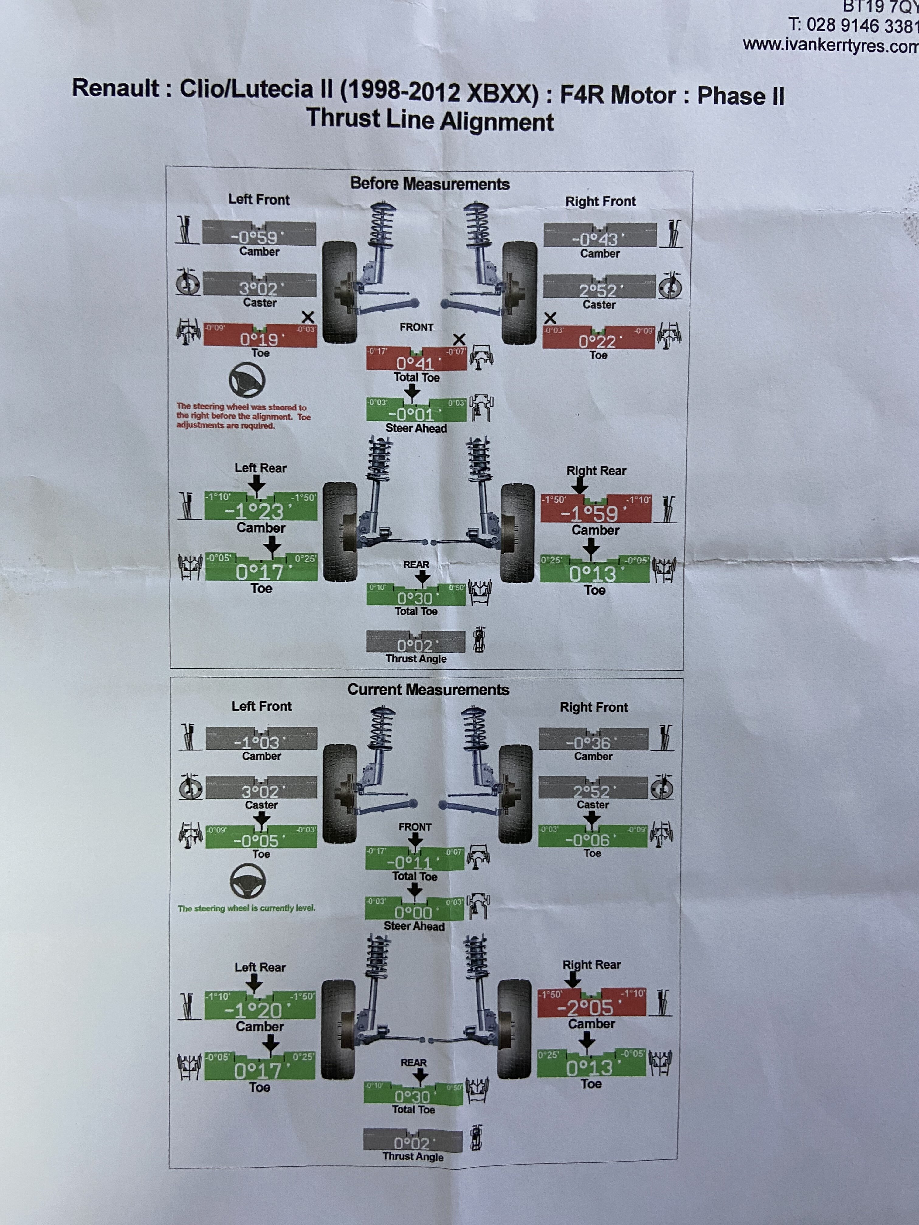

Have you got a print out of your current alignment?

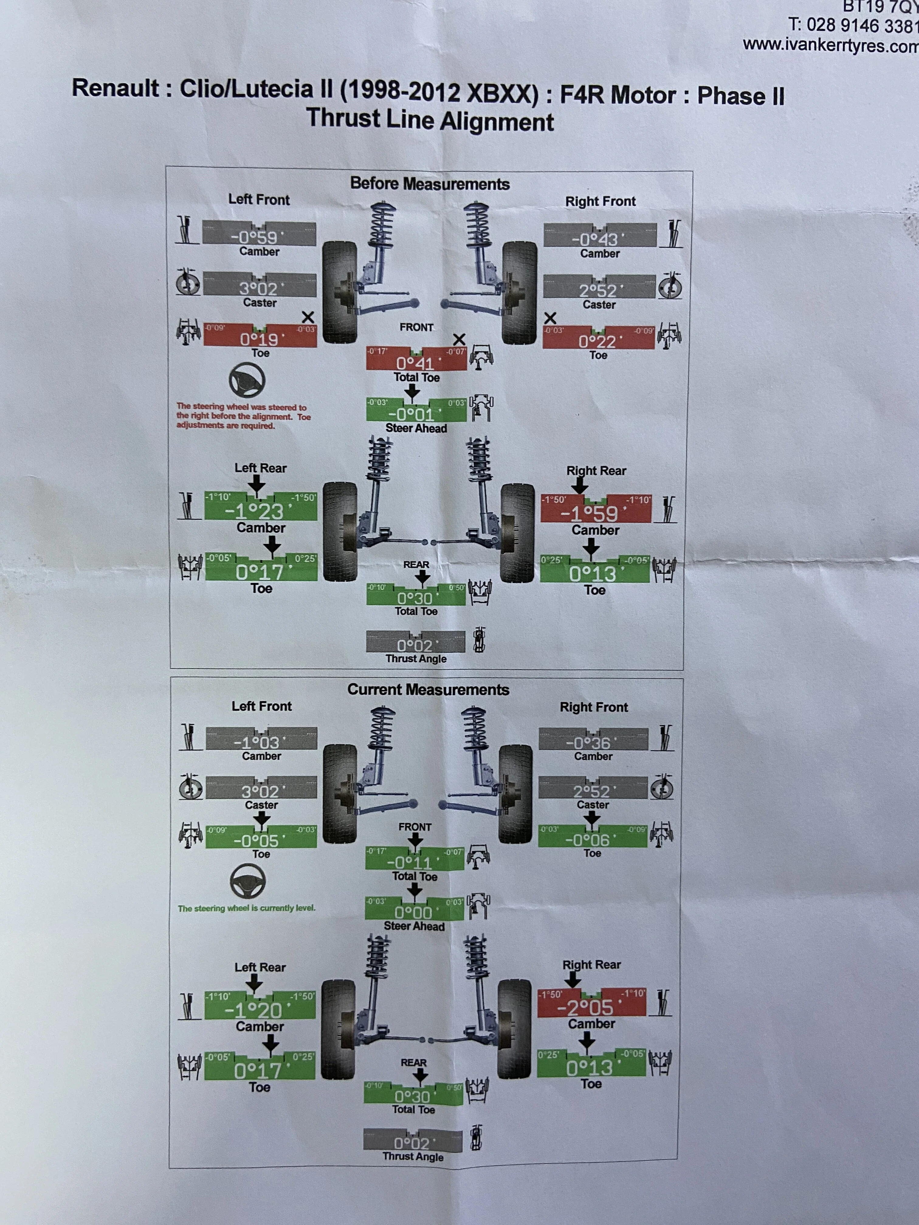

The car is an FF car. Running on Koni springs and cup shocks. Here’s a print out of the alignment I had done.
It’s feels too much to just be alignment. The car drives in a straight line no problem.

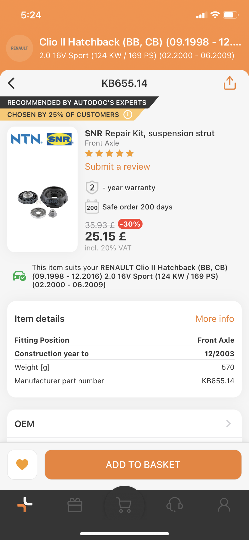

Thanks. I’ll change the top mounts next to see how I get on. Guessing fitting a new rack would be a big job.
