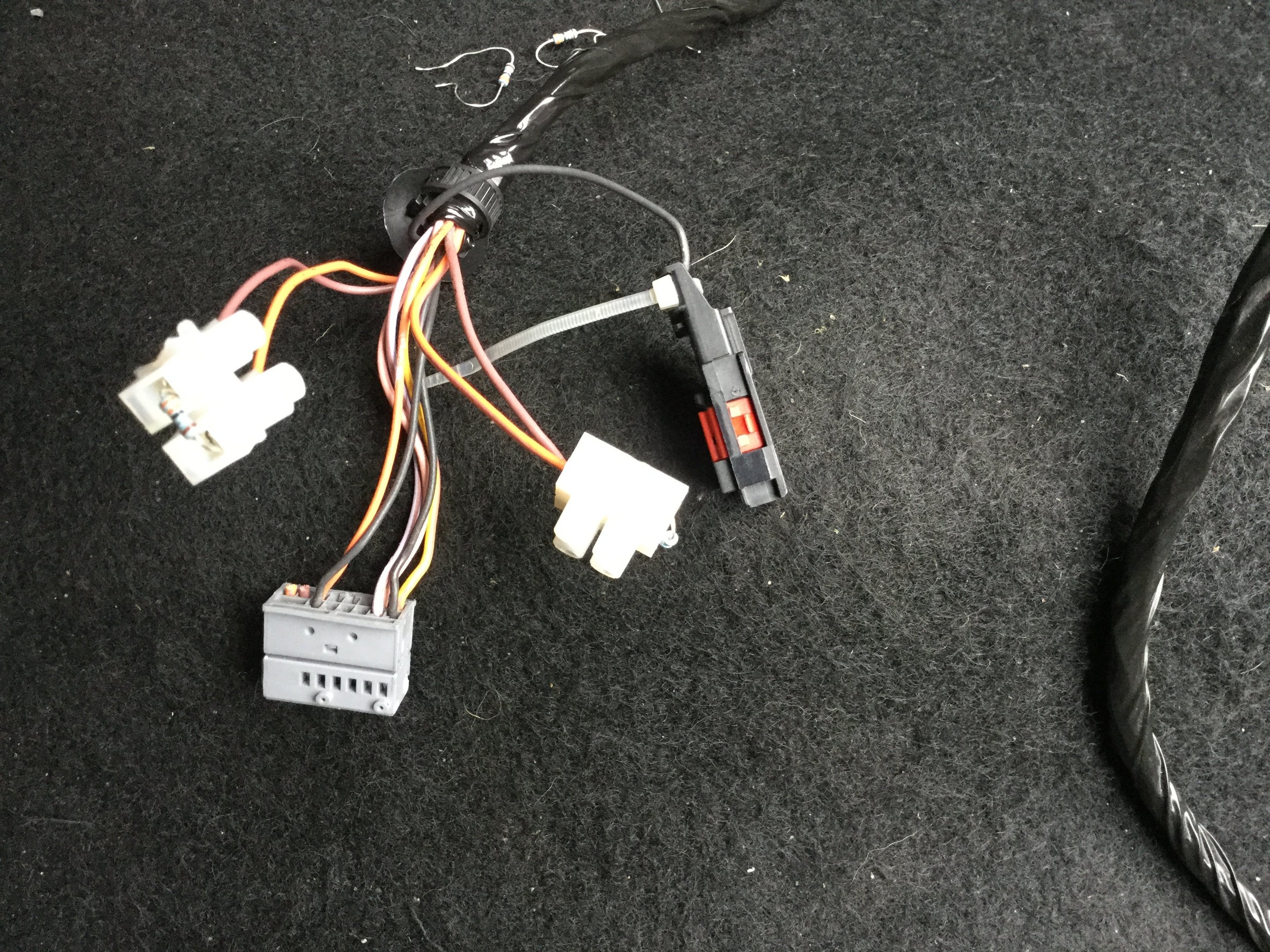

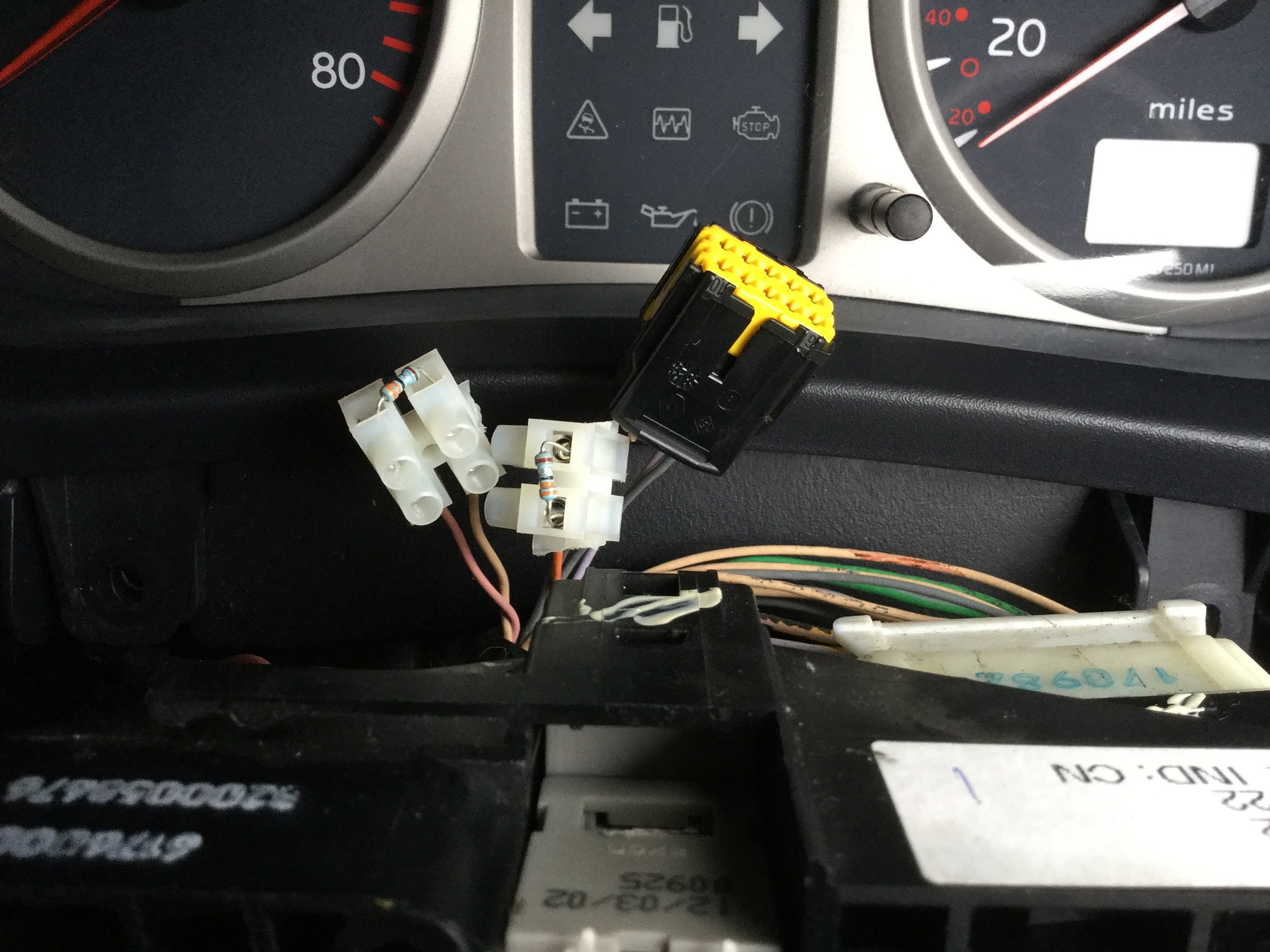

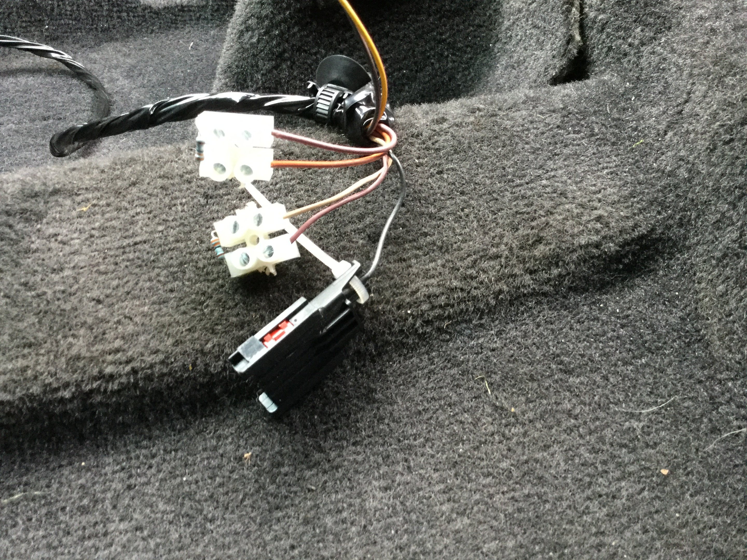

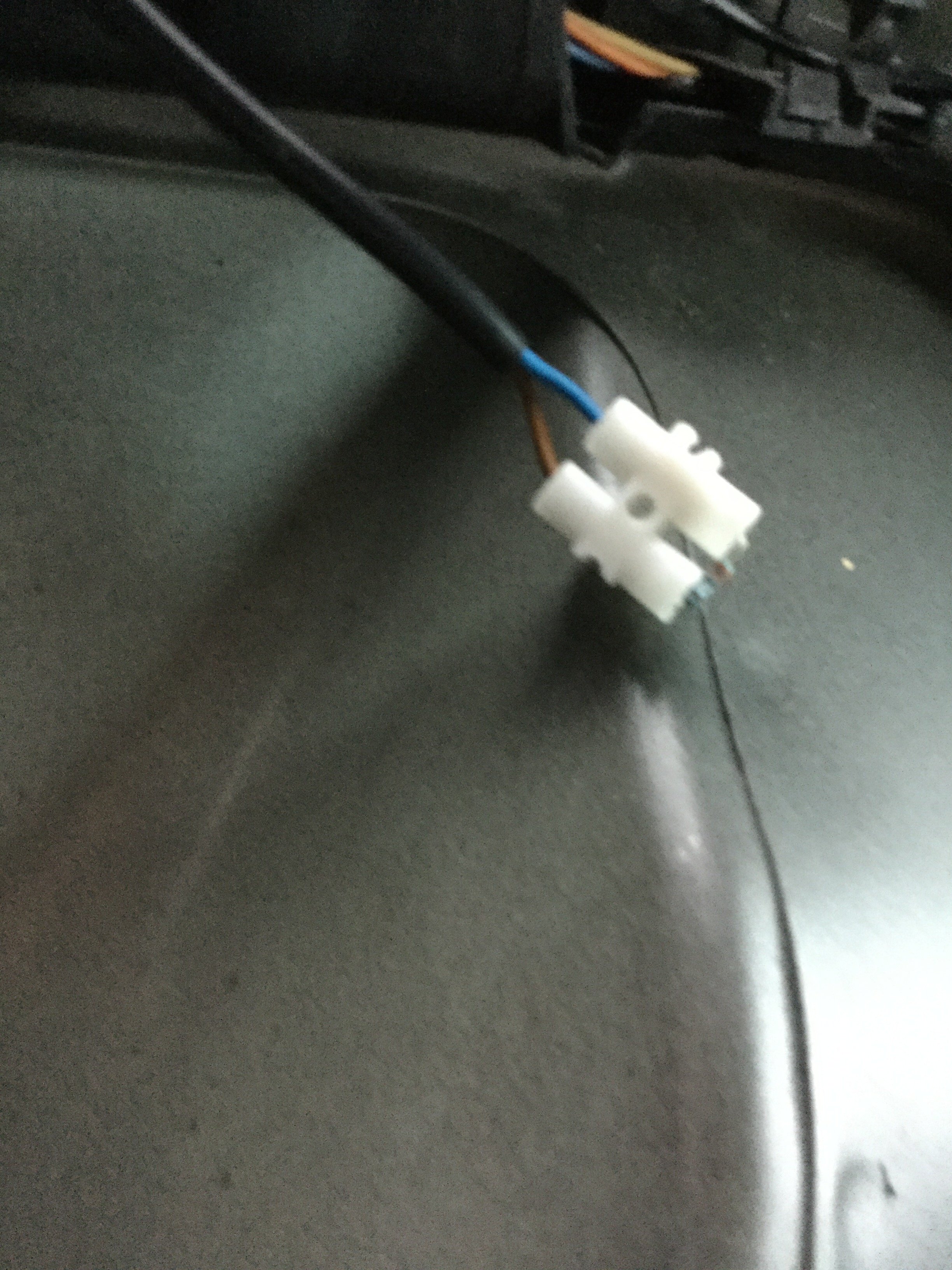

This is what I've done , have I missed anything ??
First pic rear seatbelt pretentioners
Second steering wheel airbag
Third passenger seat airbag and pretentioner
Fourth drivers seat airbag and pretentioner
I have not touched the passenger airbag just turning it off

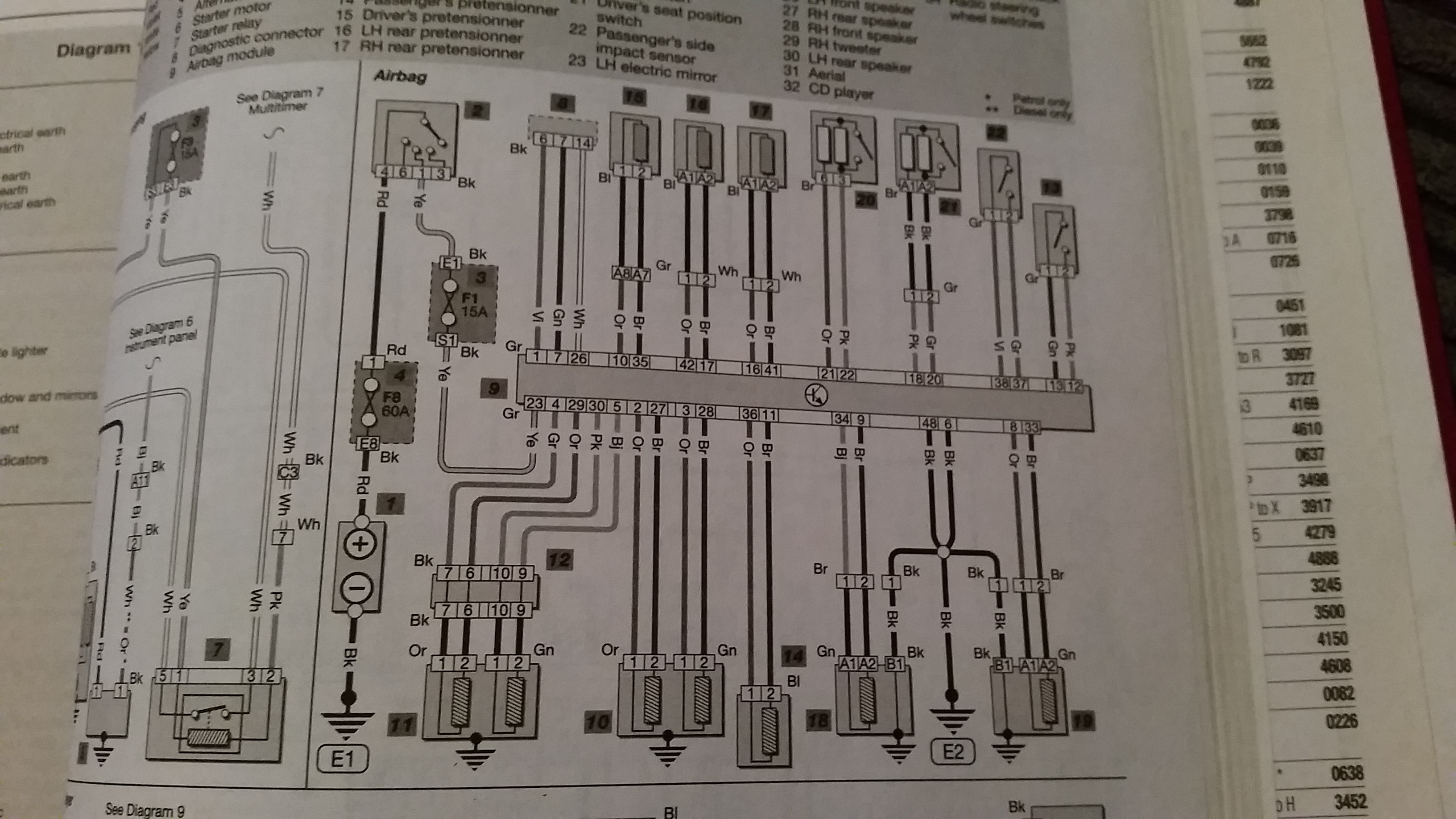

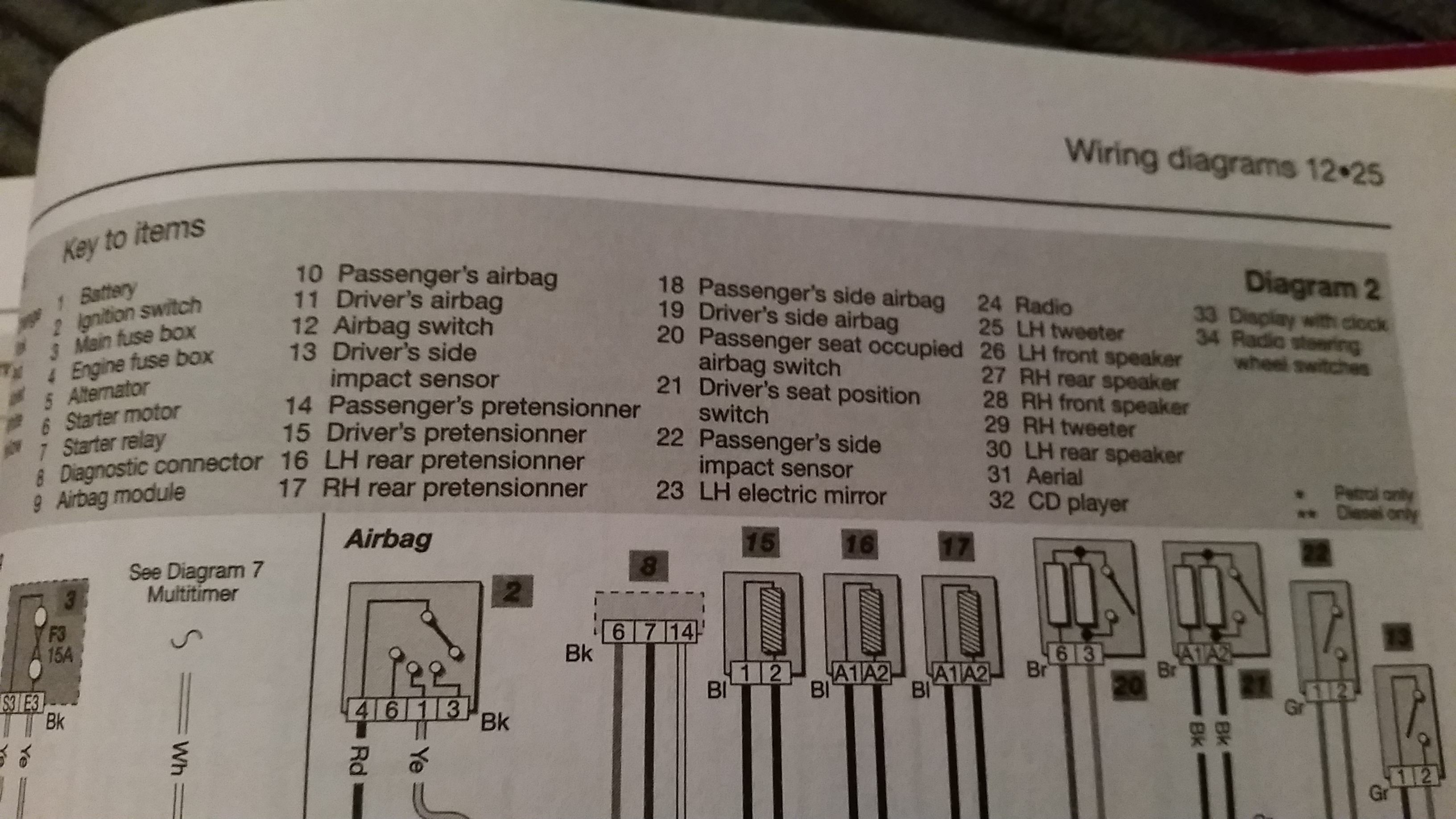

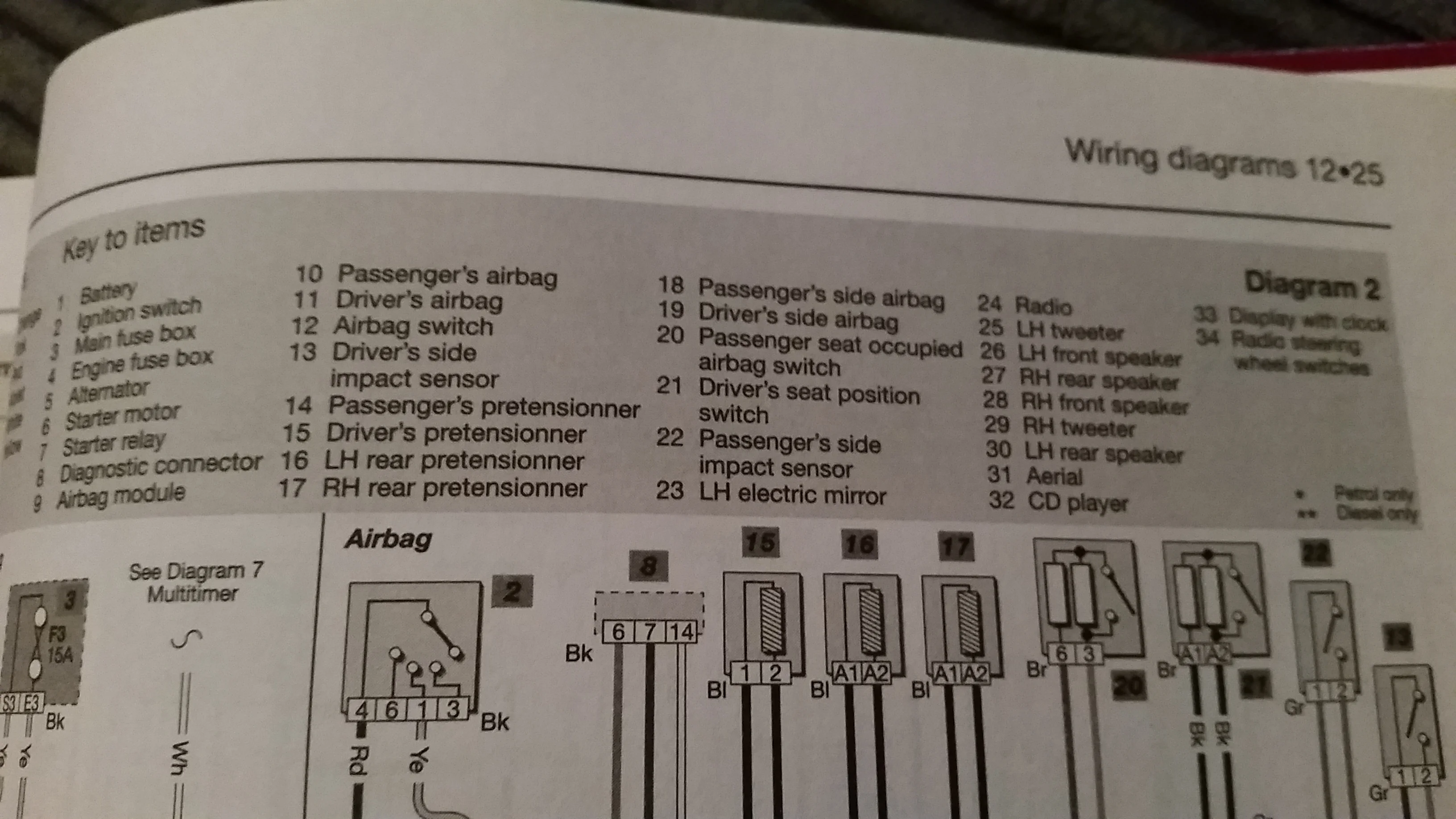

Just resorted to the dreaded haynes manual, as much as I hate them.
My understanding is that in order for the airbag light to stay off the airbag ecu has to see all the above 'working' whether that's by them actually being there or by fooling the ecu using resistors
And a key for the above

Just resorted to the dreaded haynes manual, as much as I hate them.View attachment 145460My understanding is that in order for the airbag light to stay off the airbag ecu has to see all the above 'working' whether that's by them actually being there or by fooling the ecu using resistors
