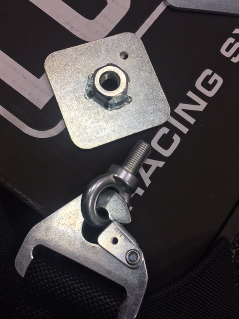

Hi Guys,
Looking to fit a set of Luke 4 Point harnesses, is there any good photos showing the exact positioning to fit the anchors on a 172 Cup or a guide? I am running corbeau club sport seats on a XL low frame. I assume I need to drill the holes and not weld, I also received the plates from corbeau/luke

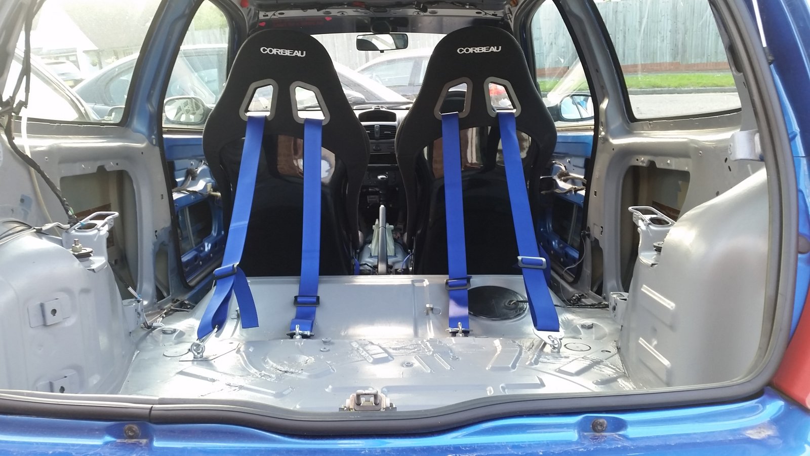

Have you got back seats fitted still? One eye bolt in the origional lower seatbelt mounting point at bottom of door pillar, one in the rear seat belt clip mounting, one in the isofix mounting and one just back from the left seat mounting with one of the plates you pictured underneath. It's better to mount the rears off a harness bar or cage, but the above is how to fit if not.

Have you got back seats fitted still? One eye bolt in the origional lower seatbelt mounting point at bottom of door pillar, one in the rear seat belt clip mounting, one in the isofix mounting and one just back from the left seat mounting with one of the plates you pictured underneath. It's better to mount the rears off a harness bar or cage, but the above is how to fit if not. View attachment 190118
Thank you for the reply, I have just today ordered a half cage so should be with me in 2 week, I may however do your technique as a temporary measure. Can you confirm the eye bolt sizes required and do you have any pictures of the left side of the seat mounting you talk about?

I will try and find a picture for you. The eye bolt size for the iso fix is M10 x 1.5mm thread, 23mm long and all the others are 7/16" UNF. You can also use scroth fixings. Hope that helps.
