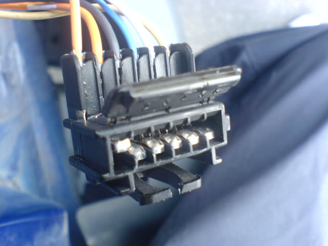

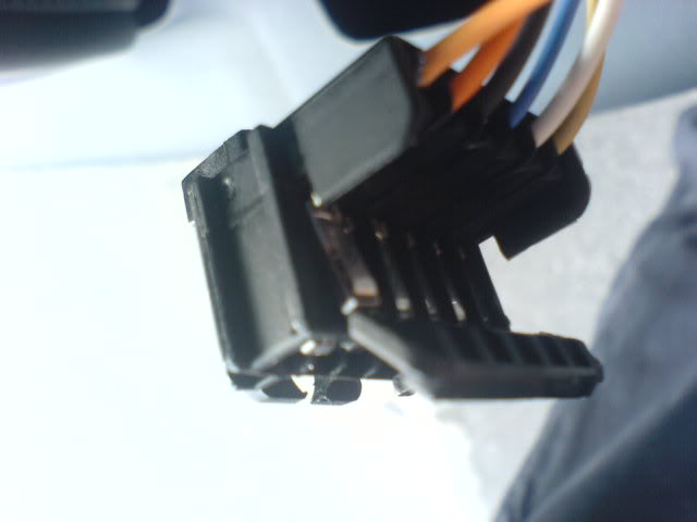

Been following fubar's guide for fitting my ph2 rear lights. I've come unstuck at the wiring though. When removing the wires to re-wire in the right order. Should I be trying to pull the whole thing out i.e. wire and the silver terminal if you like aswel, or just the wire from the silver terminal? Either way I'm having a fair bit of trouble getting it out, if it's just the wire tho I'll be able to prise the bits that clamp it in open to get the wire out. It doesn't seem to just pull out tho. If anyone can shed any light on this that would be great!
u need to make sure u lift the flap holding the silver bit in, theres one big one and one lil one for each othe silver pieces on the bottom, best lifting the individual ones as you pull it out, shud come out easily
These really aren't coming out easy at all! I've been trying to prise them out with a flat screwdriver but it's just not happening. I can get the first bit of the silver connector out but the bottom just wont come out, looks as if it's to big to fit out the hole.
Photo's if it helps, thats as far as any of them will go, any ideas? What am I doing wrong! lol
I had the same problem mate. The bottom bits do come out but I found it tricky at times and had to get a neighbour to help me. A wire split on me and he had to solder that too. Not as easy a job as I thought it would be!
I've been trying to prise the wire cover aswel as I thought that may make it easier. You're right, really isn't as easy as I thought it would be, need about four pairs of hands!! They are taking some serious force, bit worried I'm going to knacker them soon lol. I'll get a mate to help me tomorrow.
Hopefully it will be a case of once you've got one out...
im sorry i couldnt help any more mate... they should just lever out with a screwdriver.

Sorted now thanks fellas. Just went out with a better, stronger and longer flat screwdriver and it took me about 10 mins in all.
Fubar if you want anymore tips for the guide...don't know if it was just mine but there's no chance they'll just pull out. You must use a long, narrow, strong flat-head screwdriver. I tried different things yesterday as the toolbox wasn't here but used a screwdriver today and that was sound. When prising the wires out with the screwdriver, fair amount of force is needed (does seem too much for something that looks so delicate but it's fine) you'll hear a click when you've prised it enough, then it will just pull out.

The wires WILL just pull out, if you look on the OPPOSITE side of the plug to the pictures you have taken, there are some small tabs, you need to prise those up, and once you do that, they just pull out.
