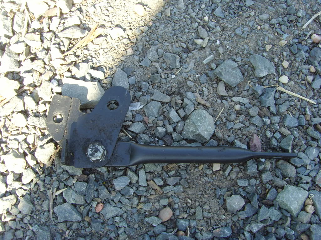

Ive nearly finished fitting a new engine and box in my car but as i didnt take it apart I have no idea where this part came from. Could someone please advise me?

It attatches inline to the dogbone mount then bolts up to the engine, an extra restraint you could call it
