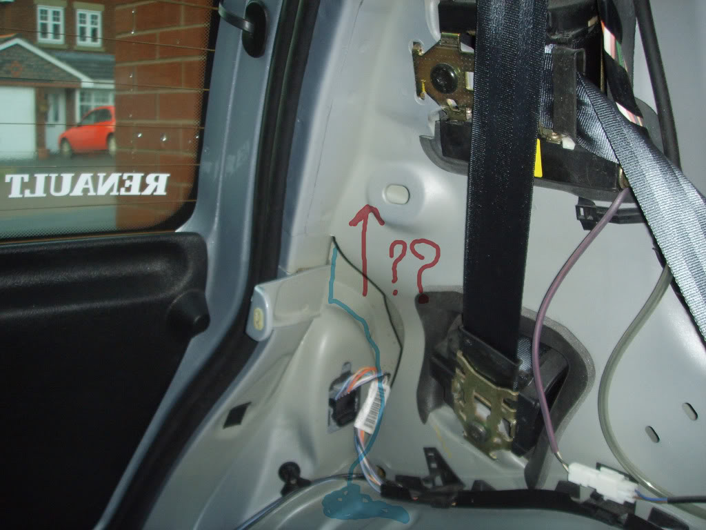

This is how the car is at the moment

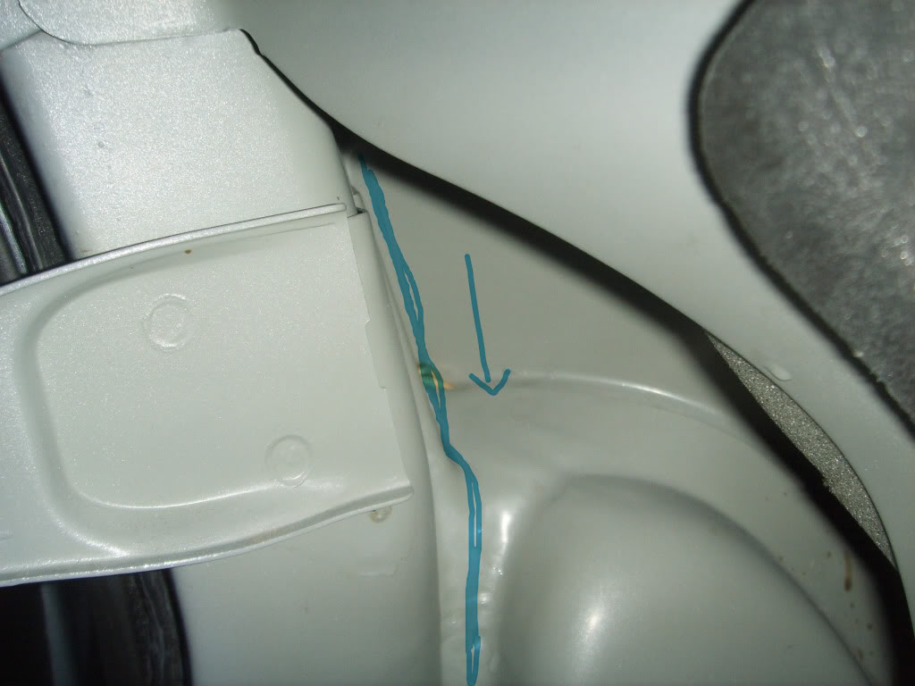

and this is the area we're interested in!
water is coming down from the cavity shown with my epic photoshop skills
my question is whats upthat cavity? its deffo coming from that high up.
Please note I took the aerial off the roof and masked it, masked the tailgate connectors so as far as I'm aware there is nothing else that high up that can let water in! its not the rear windows..
The ONLY thing I can think of is those removable strips over the rear windows - I'm assuming thats something to do with fitting the windows but is there any holes at all up there? does anyone know?
Passenger side only this - drivers side is dry as a whistle.
HELP ME PLEASE! I'm at the end of my rope on this one!
