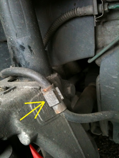

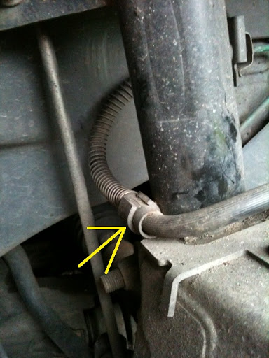

there is two clips on each brake line holding it on to a bracket. How do I get these out to put the new line through this bracket? If I dont use this bracket theres a chance the lines will foul on the wheels... pics to come..
thanks,
adam.
and
not planning on reusing these lines but at a guess I need to reuse the clips to stop fouling the wheel?
Just take a hammer and screw driver to the "clips" to wide them?
cheers Fred!
are you planning on reusing the existing lines? HIT EM!
Have fitted any to a 197/200 Fred? I'm just interested if you reused the bracket or used the shoddy little clip you get with them.
It seems it's easy to fit them in such a way that they foul on full lock with the back side of the rim.
