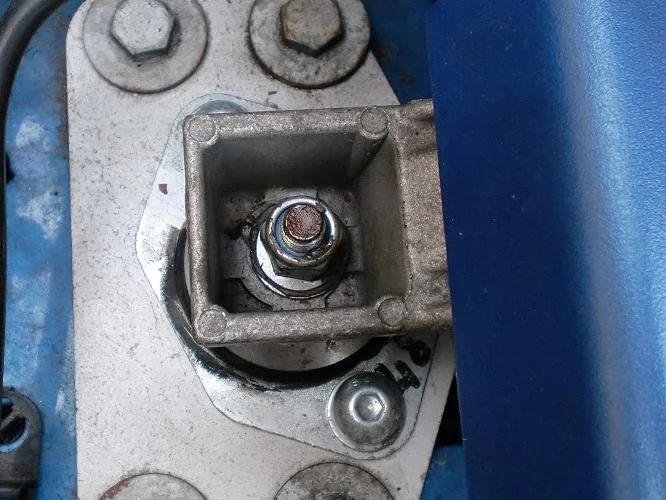

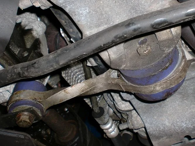

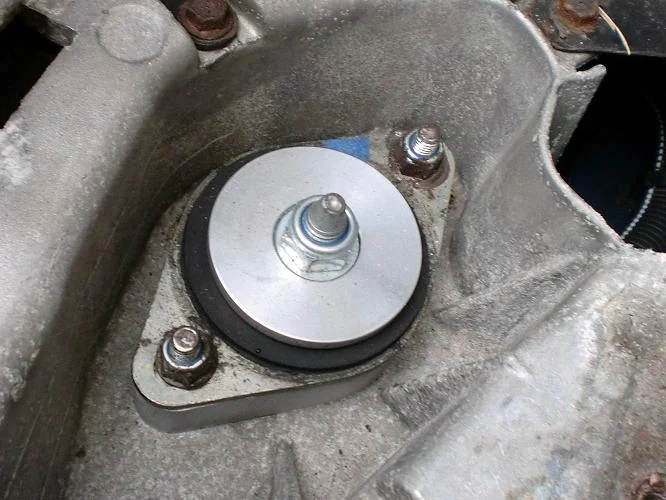

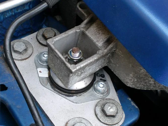

Evening all, following on from this thread where I'm trying to identify why there's so much engine vibration rattling through my car.... I've taken some pictures of my engine mounts - I'm fairly sure that the dog bone is powerflex but can anyone identify the other two for me? It would also be nice to get some opinions on whether the dog bone mount has been fitted correctly or not - I've seen a lot of different opinions on here about whether on the gearbox end, the large part of the bush should be facing upwards or downwards.... could this be causing the vibration problems? Thanks in advance for the help! :)
Dogbone is fitted correctly and as j said other mounts are k-tec uprated ones and they are considerably harder compound over the O.E mounts so yes you will get a fair bit of vibration.
Plus they may need to be aligned properly.
yeah powerflex is the purple one. if you dont like the others I'll have em! My upper g/box one is pooped
Thanks guys, is the best way to realign them slack them off a bit (supporting the engine if course) and then re-tightening?
TBH I'm still undecided about them. My main concern is finding out if they're fitted properly and there's nothing I can do to improve the situation... It does handle brilliantly so it's probably just me not being used to the car.
I run these on my Williams and have ZERO vibration. In fact they are so good along with the lower gearbox mount and ploybushed dog bone I would say to anybody to do it.
Even with the turbo there is no knocking
Ok so it sounds like my options are: realign them, if through vibration doesn't get better replace them with oem or powerflex.

Having read the various replies I can't wait to get outside and try to sort my k-tec mounts out (well, it's raining and dark so maybe I can wait a while!). There seems to be such a difference of opinion!
Finally had a crack at realigning my engine mounts yesterday, didn't think it had made much difference to begin with... But having driven the car for a bit they've settled right down and although they're not perfect, they're a lot better than they were! :)
It no longer feels like I'm constantly on a massage chair!
