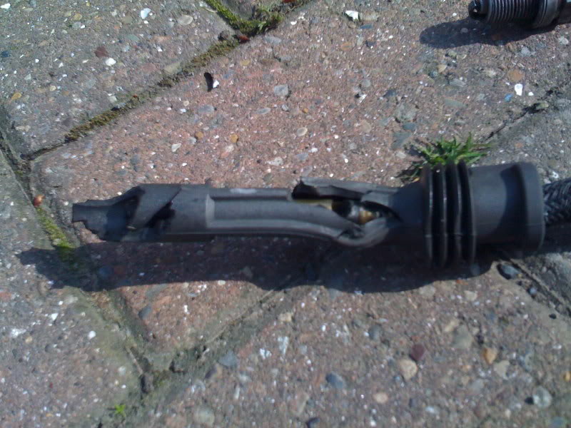

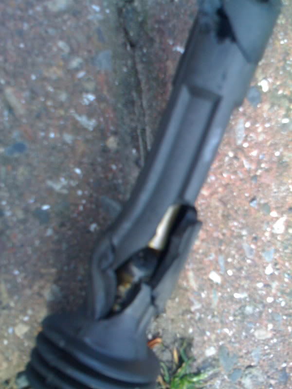

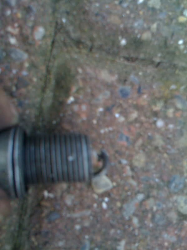

fixed!
spark plug went flying lol changed the plug and fitted a new set of HT leads and its working :)

The same thing happened to me... When travelling 70mph down a dual carriage way!
Pooped my pants at the time, plug number 2 had blown out and the lead in 100pieces
