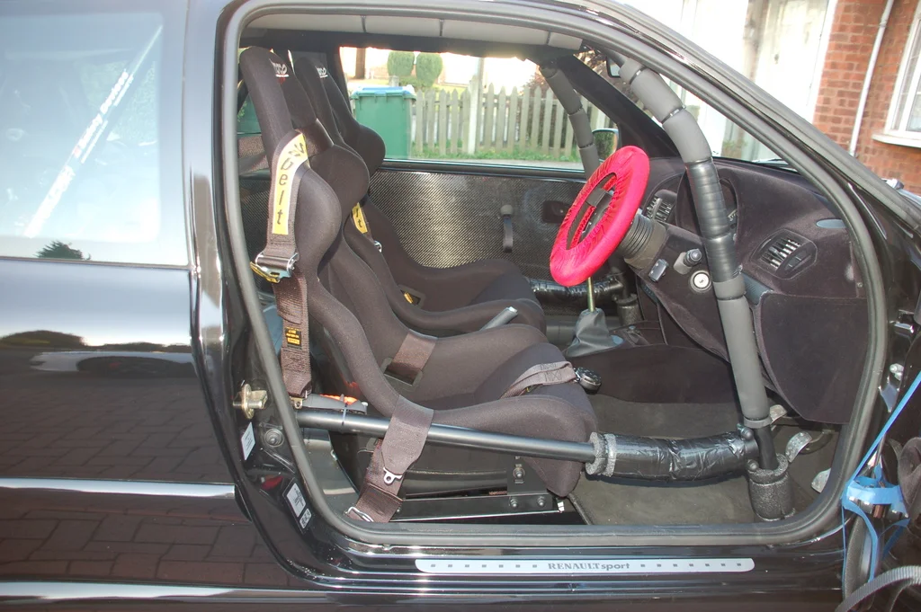

When I tried and failed to strip the rear if my car (can't undo the middle passenger seatbelt bolt on the roof) I was shocked at how little a lot of the stuff weighed. The sound deadening in the rear doorcards weighs bugger all as does the stuff directly under the carpet. The tar stuff is surprisingly heavy and does seem to do feck all too! The cards and seatbelts themselves seem to weigh a bit though.
I've still got the full interior in mine. Just with a cage and buckets.
"Clubsport spec" I call it.
For track, I don't see the point of stripping it completely. Race, obviously is a different story. I suppose I'm just old and like having my stereo and carpets as I float around Oulton.

i think I'll go similar, I don't find the noise at present too much but may get the ktec boot carpet. Depends really. I can't wait to swap the heavy drivers seat for a cobra clubsport (most likely) although sadly the passengers will have ti remain as I need it on the off chance I need to take my son in the car.

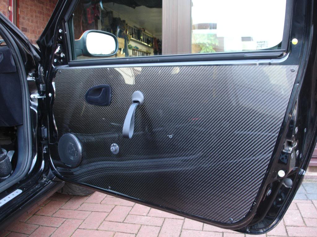

I have gone inbetween, I left the carpet in the front and everything from the seats back has gone, the door cards have been changed to carbon fibre ones but still fitted speakers as it is driven to the track (not the best sound but better than a constant exhaust noise).
I am in the process of finishing off fitting a roof vent now but still kept the headliner as I did not want to get dripped on when the condensation built up, even with no carpet in the back it is still civilised with a ktec 2.5inch exhaust.

Really like the door cards mate where did you get them from ?

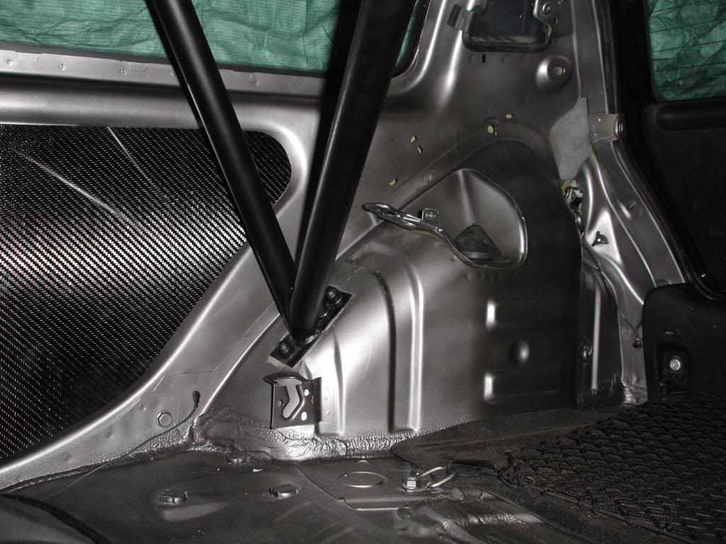

Where did you root the wires in the back that looks really clean and professional ?
Have a look at my build thread its in there with more pictures.
The drivers side is routed between the panels and comes out by the rear light and the passenger side is just tidied up by putting the cakes inside some conduit tube
Thank you I shall have a read through it tonight. What the back of your car looks like is the sort of clean professional look I want to go for :)
