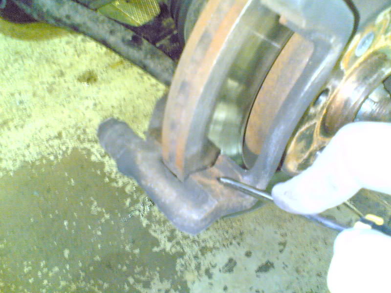

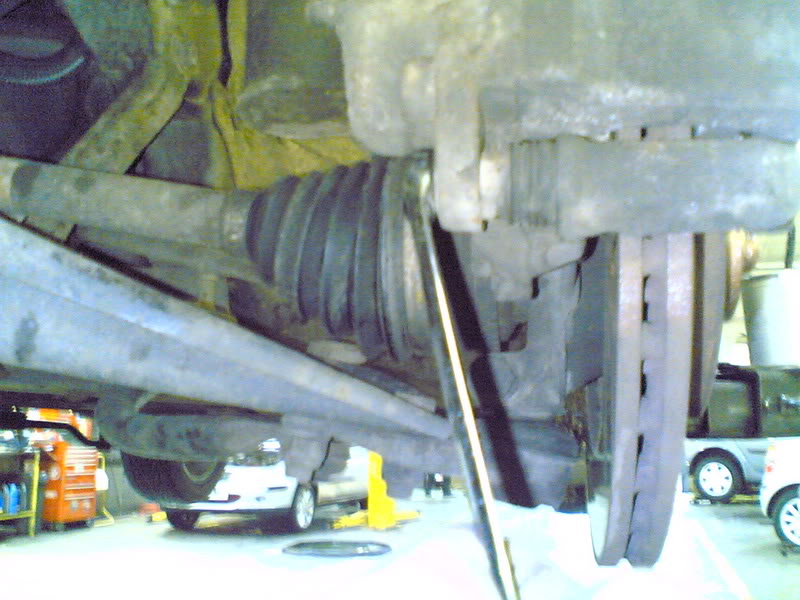

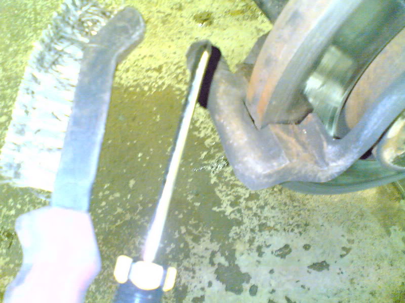

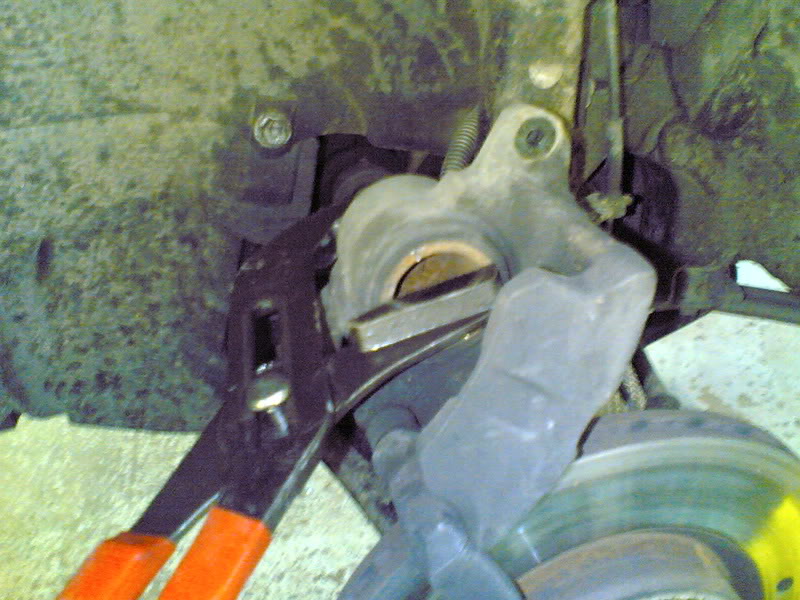

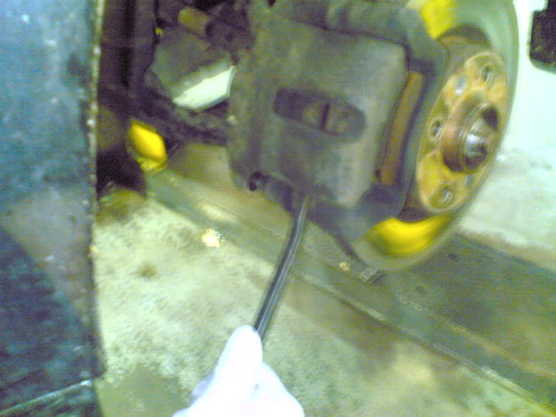

Heres a quick guide for pads/discs I did for someone else, very basic just rushed it tbh.
Quick Pads/Pads & Discs Guide - Non-RS Models
Okay this is a quick one for the pads and discs - do a side at a time so you can refer back if you have to.
Jacked/axle stands - safety
Wheels off
Remove 13mm Bolt on bottom of caliper
Lift caliper up, slide off carrier
push back piston (keep eye on level under bonnet)
Remove old pads & shims as necessary
Remove 2 X 18mms in the carrier (Bit that holds the pads)
Remove carrier, clean up with wire brush
