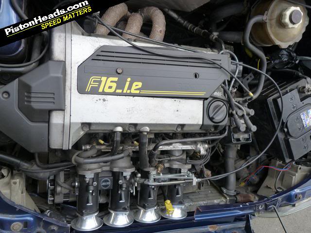

hi , i have a williams with jenvey itb fitted from ktec (told by previous owner) but i have no filter, which filter do i need to order, ive just recieved the pipercross 600 base plate but it looks to big, do i need the piper cross 500 base and filter, what are you guys using one this set up? cheers.
the aprox dimmensions of the truppets are 90mm by 360mm in length
pics of set up
You called me a week or so ago I believe, but didn't seem to want to cut/drill the backplate. There's no way around it, you have to do it or pay for it to be lazer cut
You also have to trim the bodywork a little
