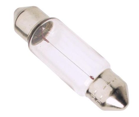

as above, please help me, how do i put the white led bulb for my rear registration plate in?its a long shape and the standard bulb is different shape? thank you

You've bought the wrong bulb then.
I'm guessing you've bought a festoon
and you're number plate bulb is actually

yea the top one is wot ive bought, but the bottom one is different to that, its bigger and has a metal part at the bottom
i gt it off ebay n it says its for clio ect....

You bought the wrong one, you want one that has a baynet bulb dont you. The feaston one you bought will fit in the glove box and the boot. you want one that looks like this.
