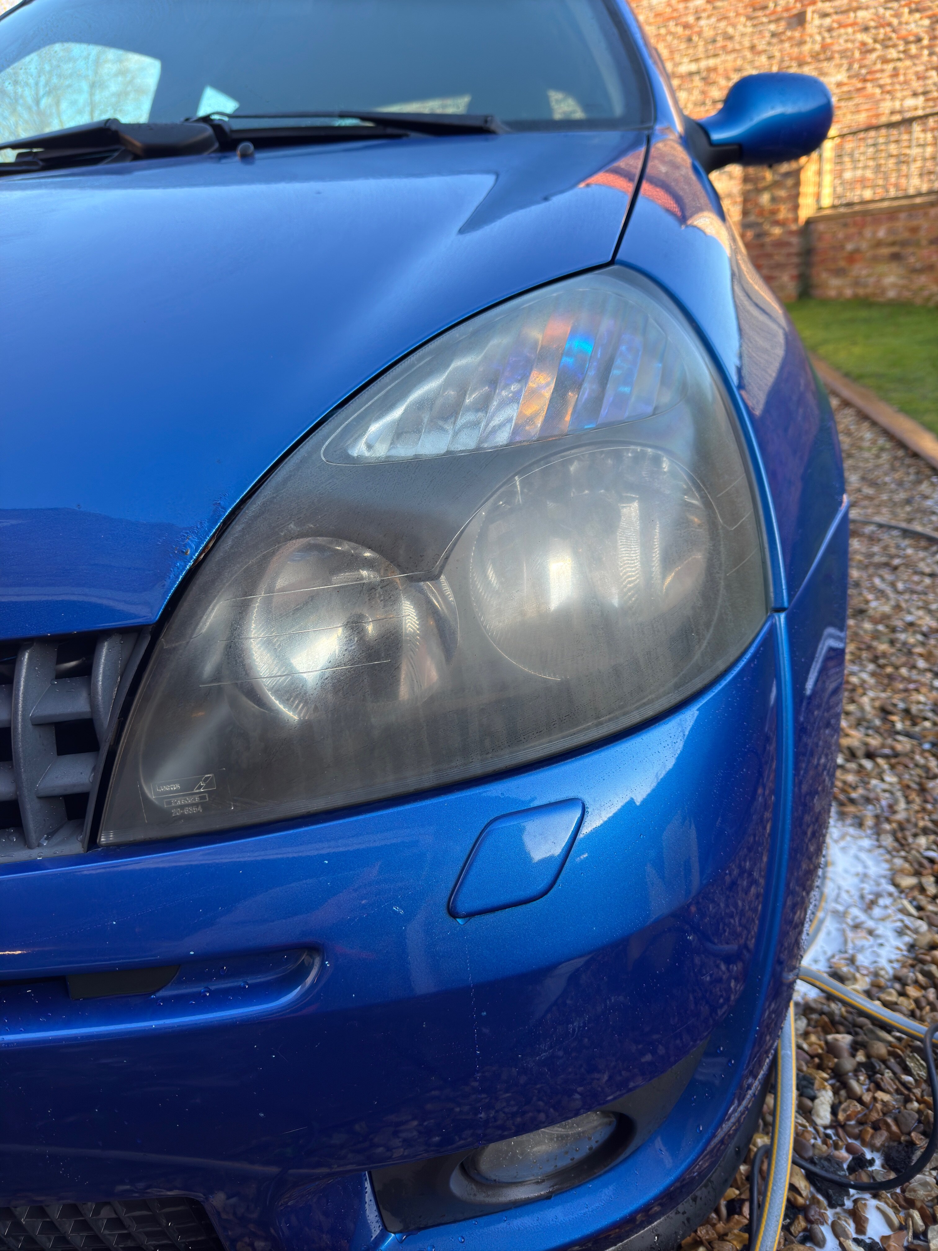

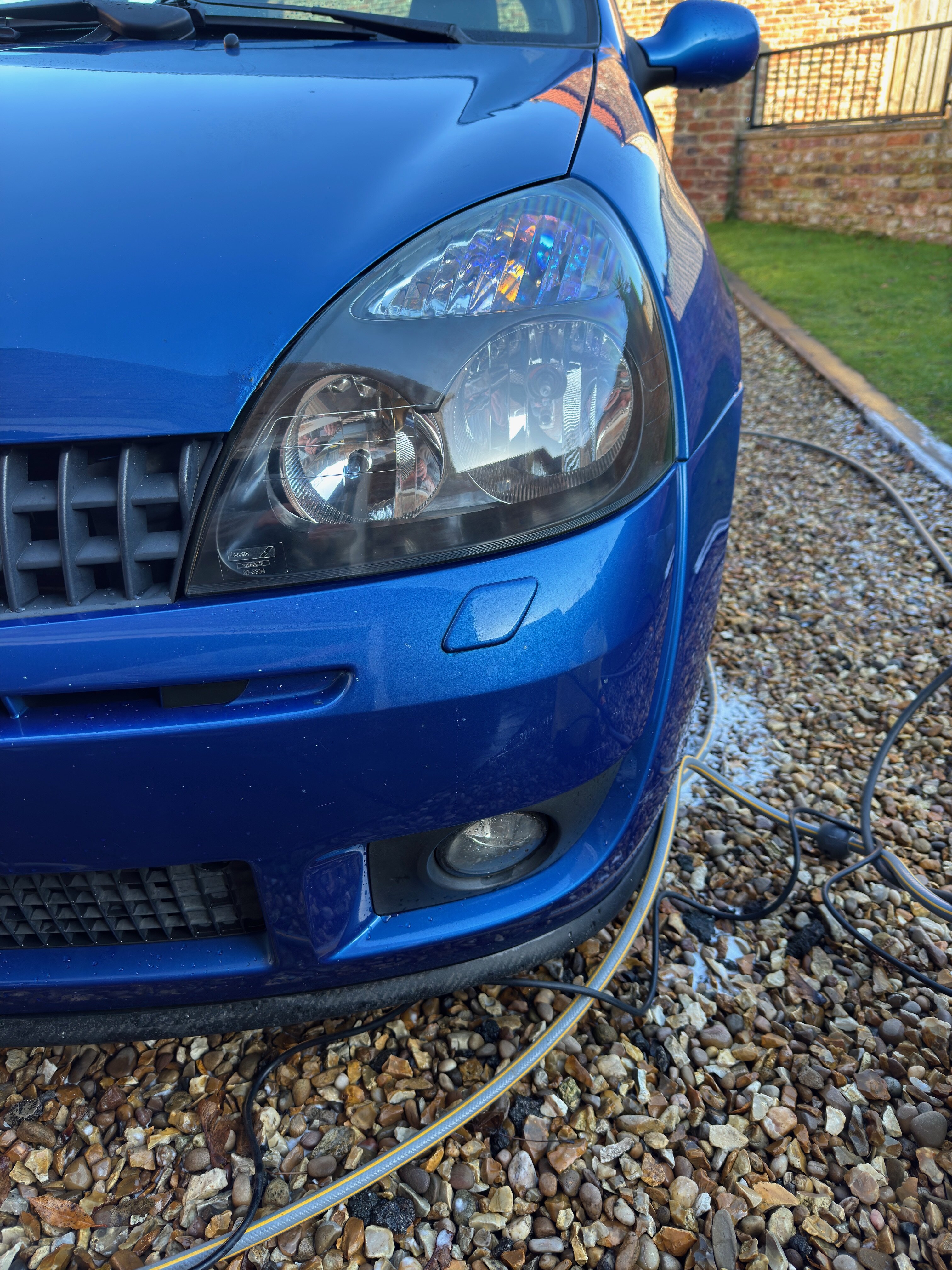

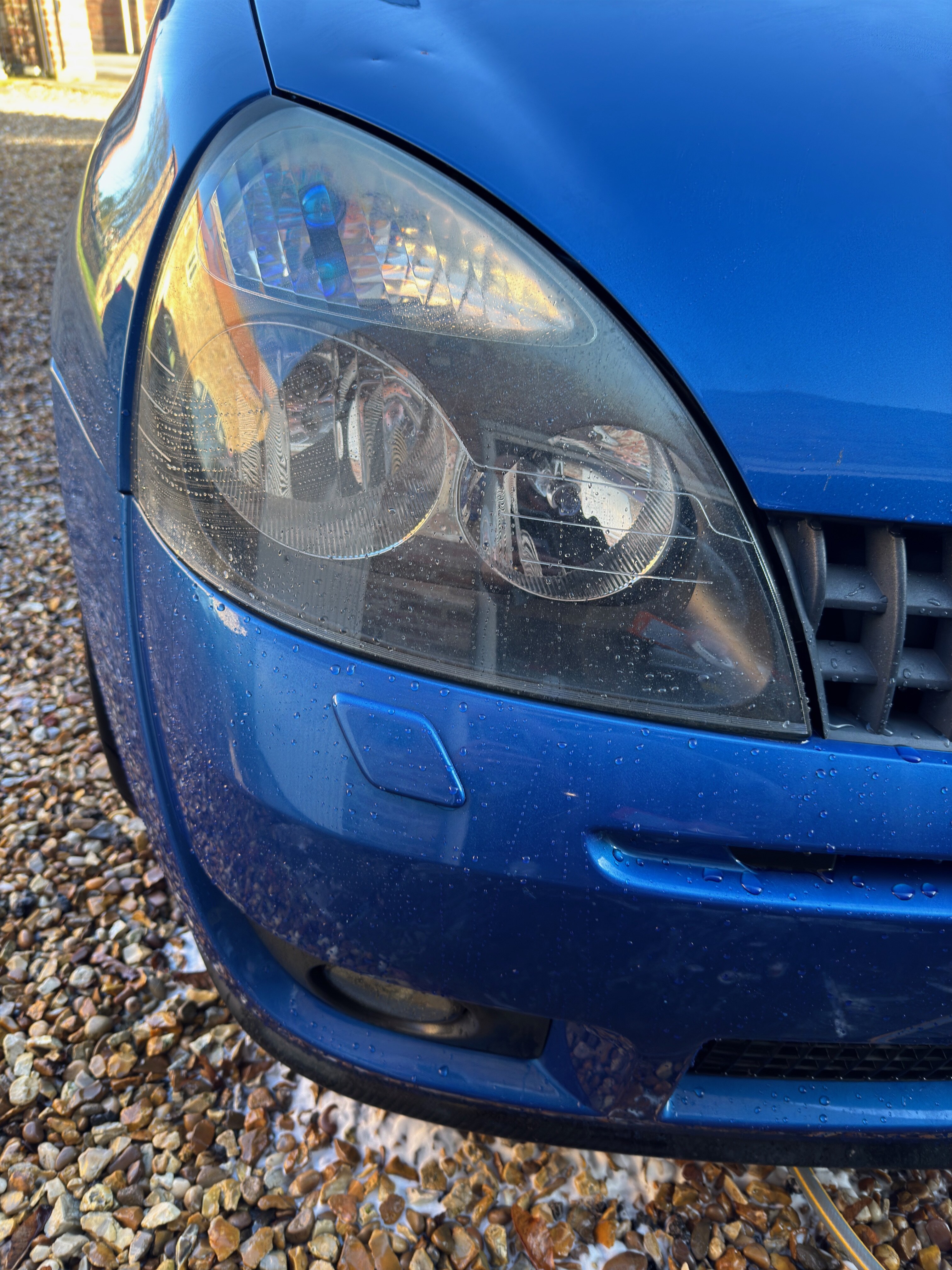

Finally the nearside light was frustrating me. It was cloudy as heck. I purchased a cheap "wipe" kit on Amazon and had a go. Nothing to lose really!
Its only gone and worked!
Before
What it should look like
After

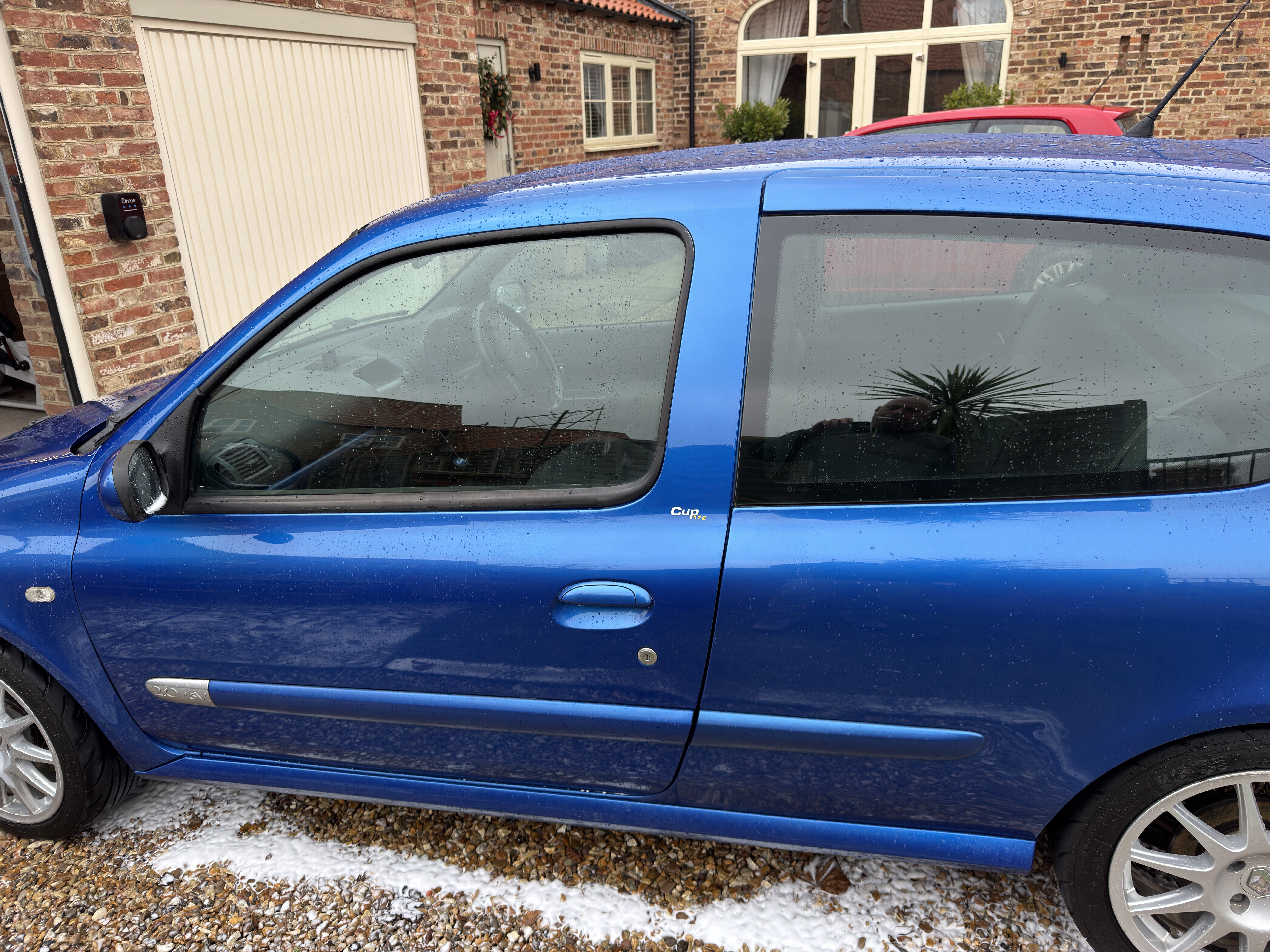

Matt Cup
  Leon Cupra

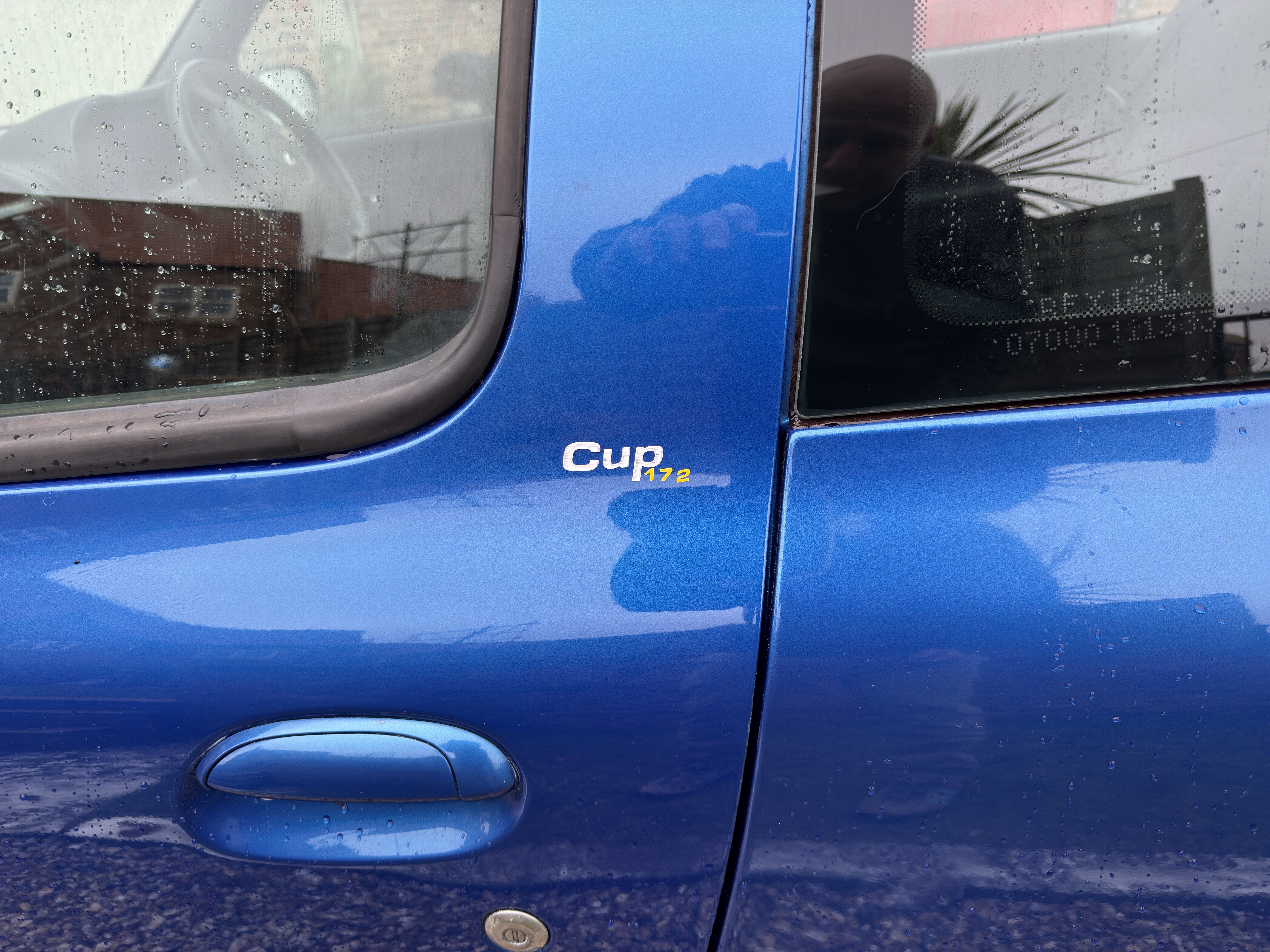

Post paint I had to get some new decals.
I appear to have slightly nudged the number 2 when fitting but its nigh on identical to the other side. Both passed Renault QC I am sure ..
