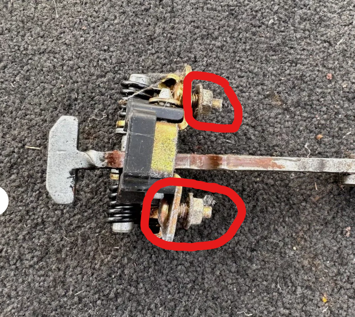

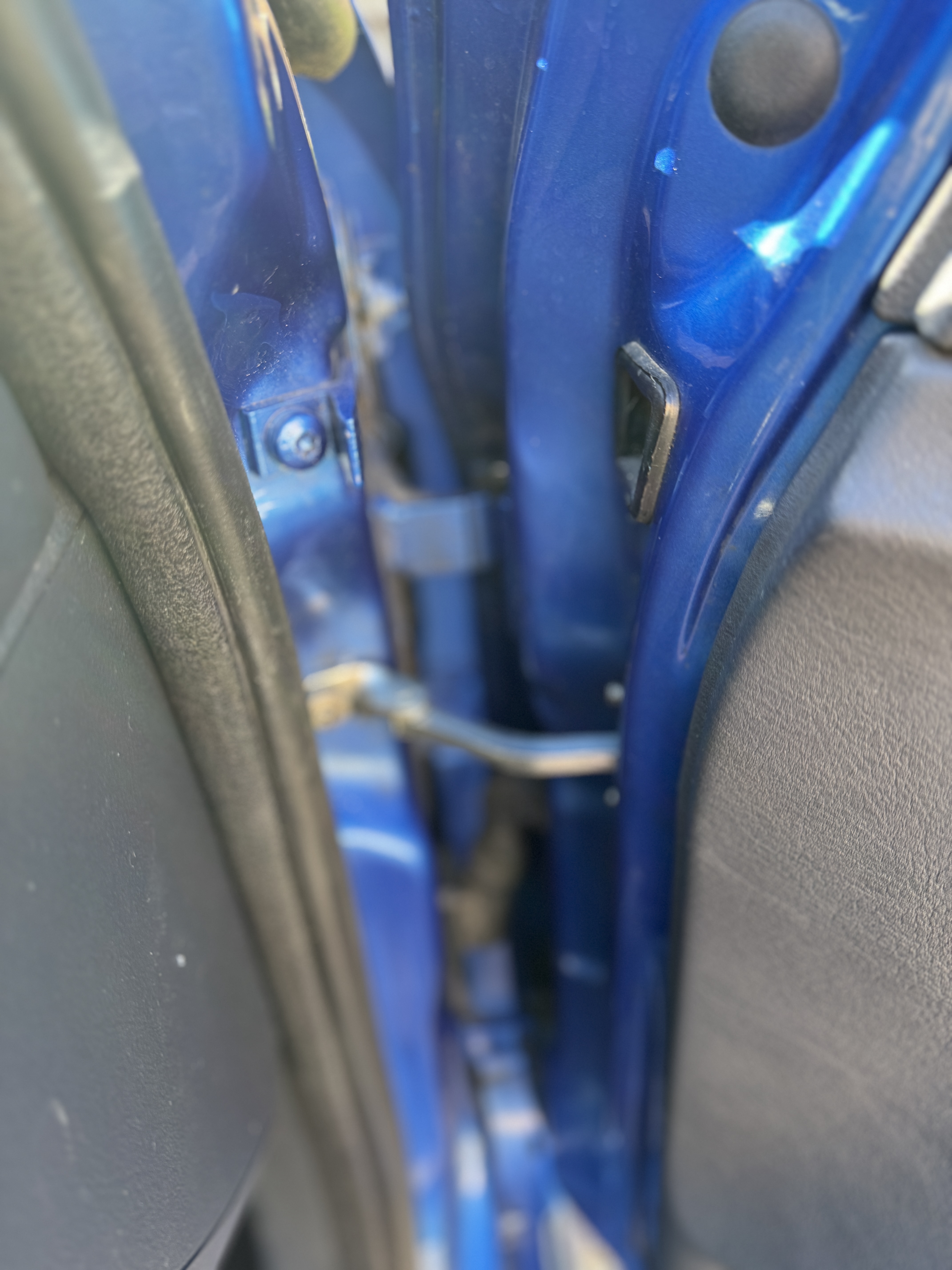

Today I decided to swap out the checkstrap on the drivers side door.
Nothing went to plan.
1) The checkstrap didnt fit
2) I broke the plastic part that helps align the doorcard to the top of the door. Its superglued for the short term
However, I did have a supervisor.
Door card off
Back on - can just about make out the damage
Supervisor not impressed

What was up with your check strap?
My drivers door is incredibly creaky and white grease on the hinges didn’t solve it. So was thinking it may be that.

I have two check straps.
The replacement one looked too long, but looks can be deceptive. It fitted well and I didnt have a wrestle with the doorcar putting it back together. The door is now proper stiff to open and close in a good way. Am I supposed to apply grease anywhere?

Yesterday I fixed the drivers side check strap and a few rattles.

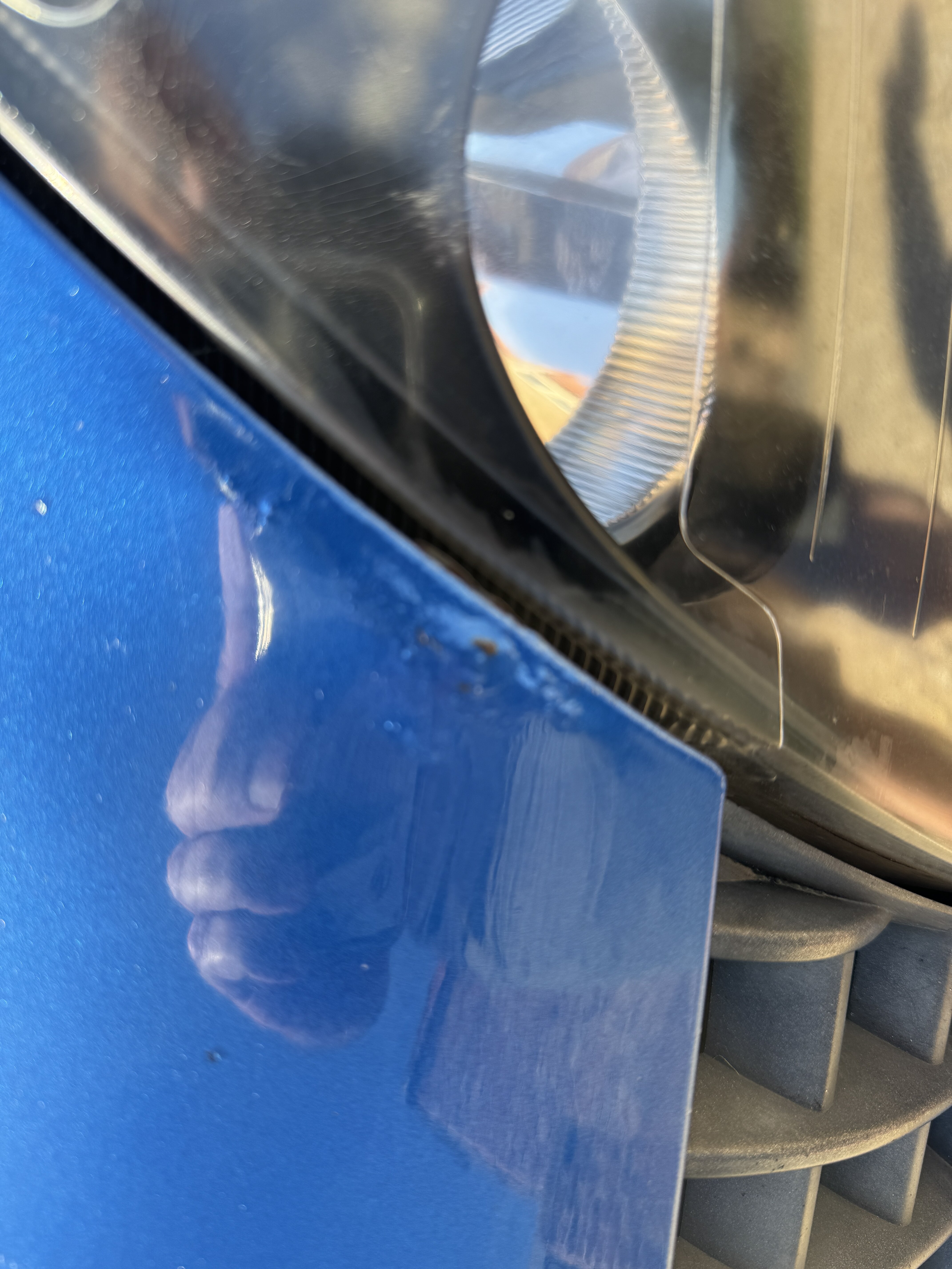

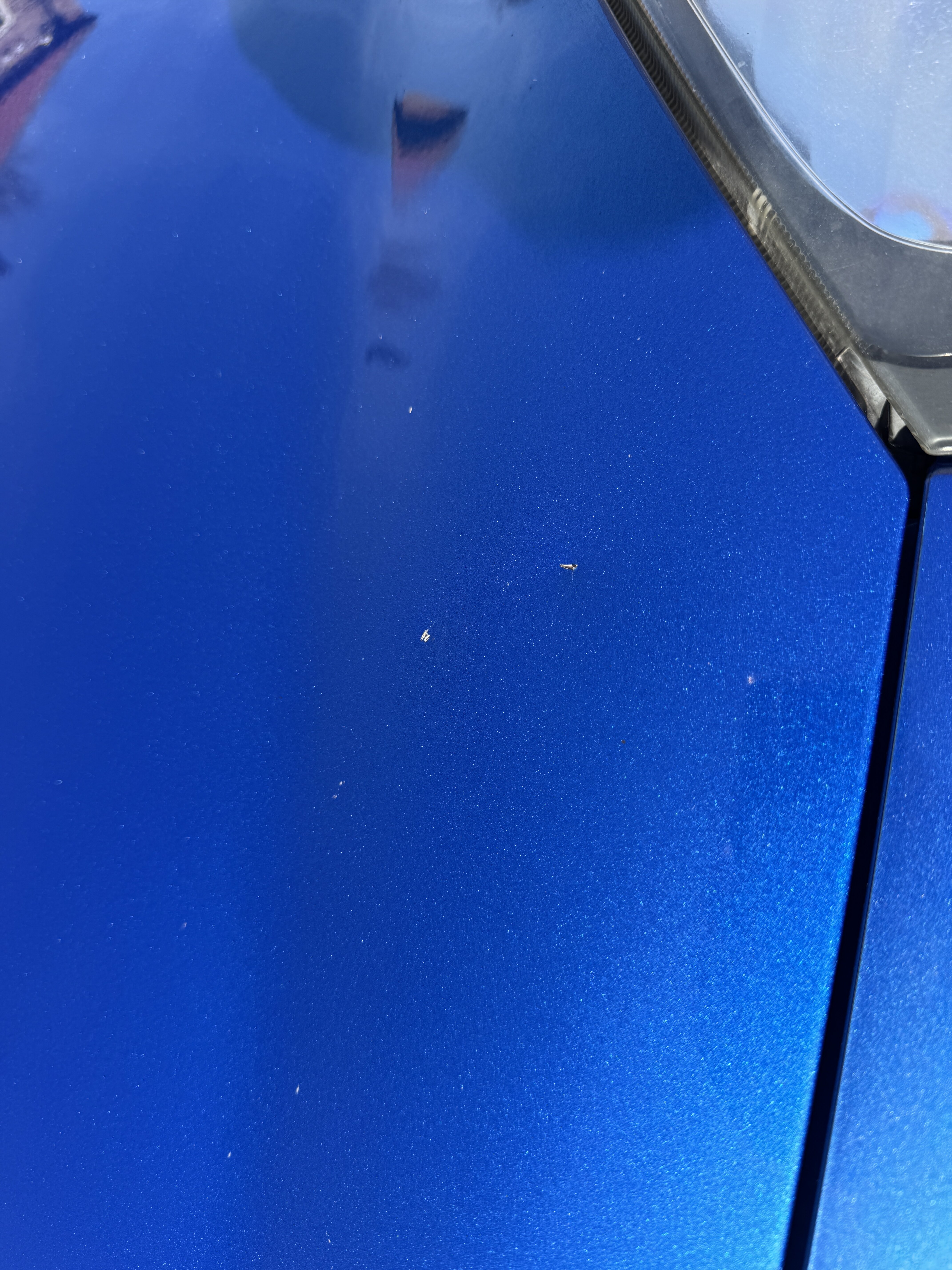

This morning I broke the sound barrier getting over to a localist paint shop.
New paint acquired, sprayed and lacquer erm , lacquered.
Awaiting it to go off and will flat it with 3000grit paper and polish
Looks a mile better
Before
During
After

After pestering @DiamondPerformance for an age on whatsapp I got down to 3000grit wet and dry , a lot of warm soapy water then some cutting compound which I applied by hand.
For an amateur effort its a solid 8 out of 10 and I dont think you would notice the repair unless I pointed it out. Sure the lacquer isnt super glossy but it doesnt catch the eye either!
Happy overall.

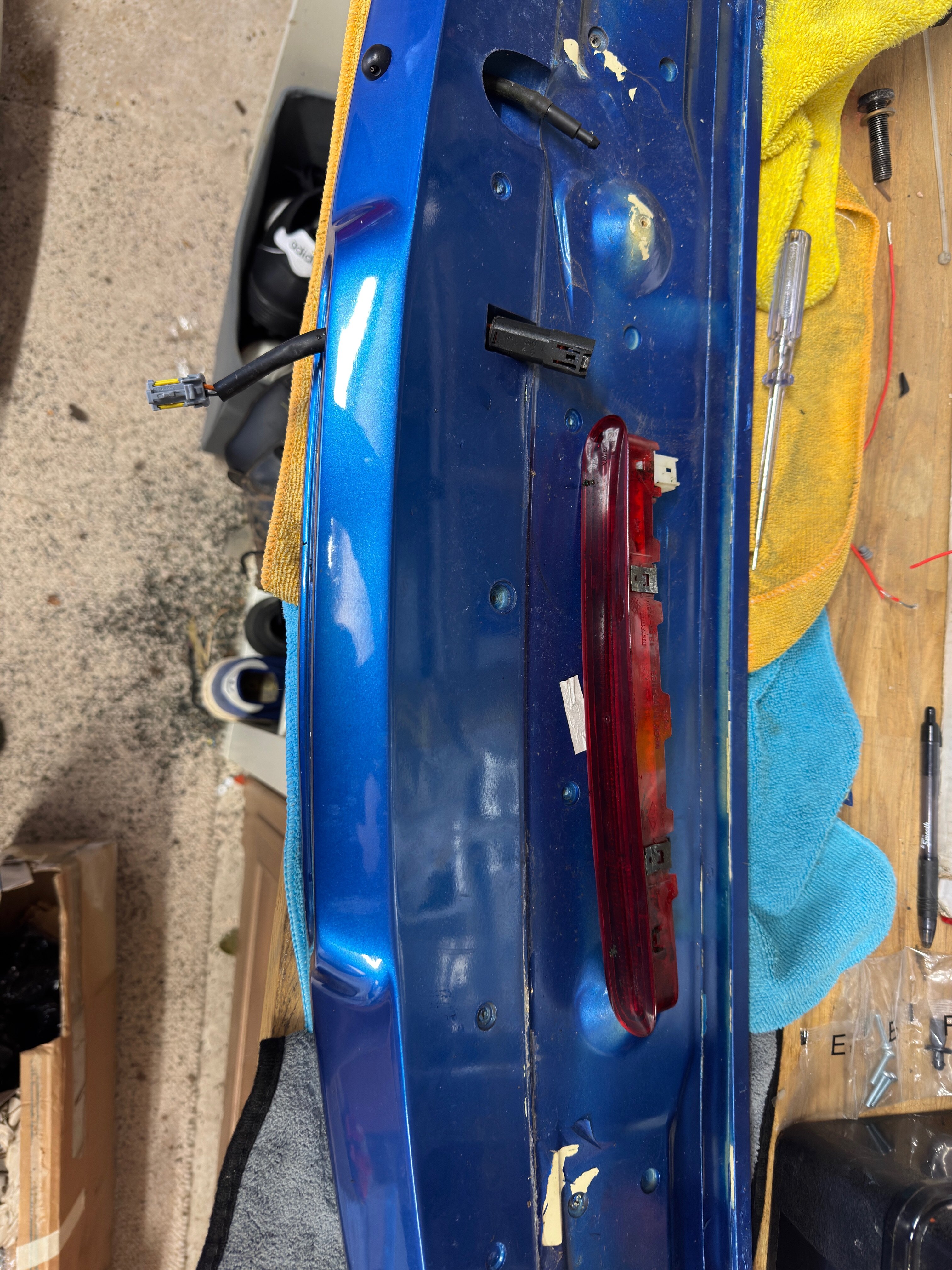

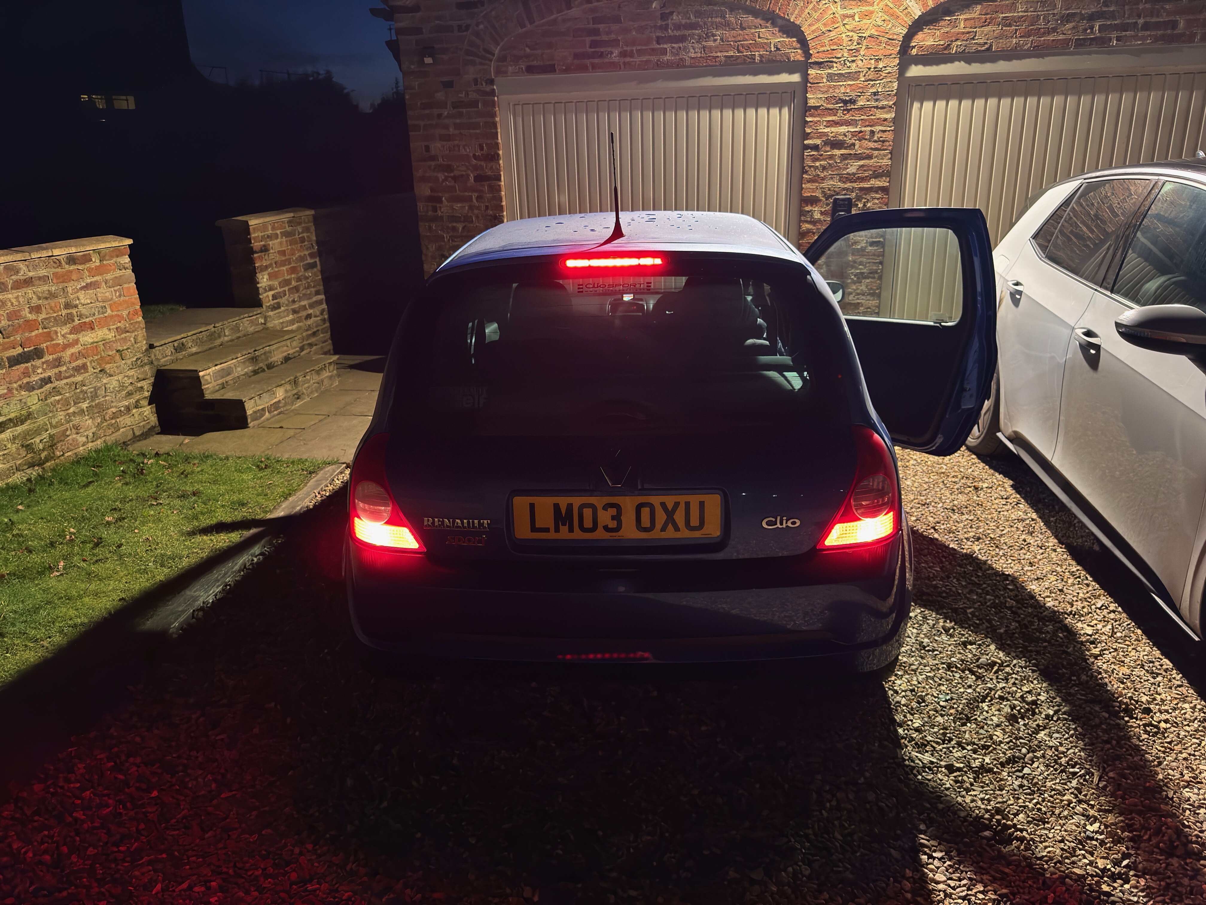

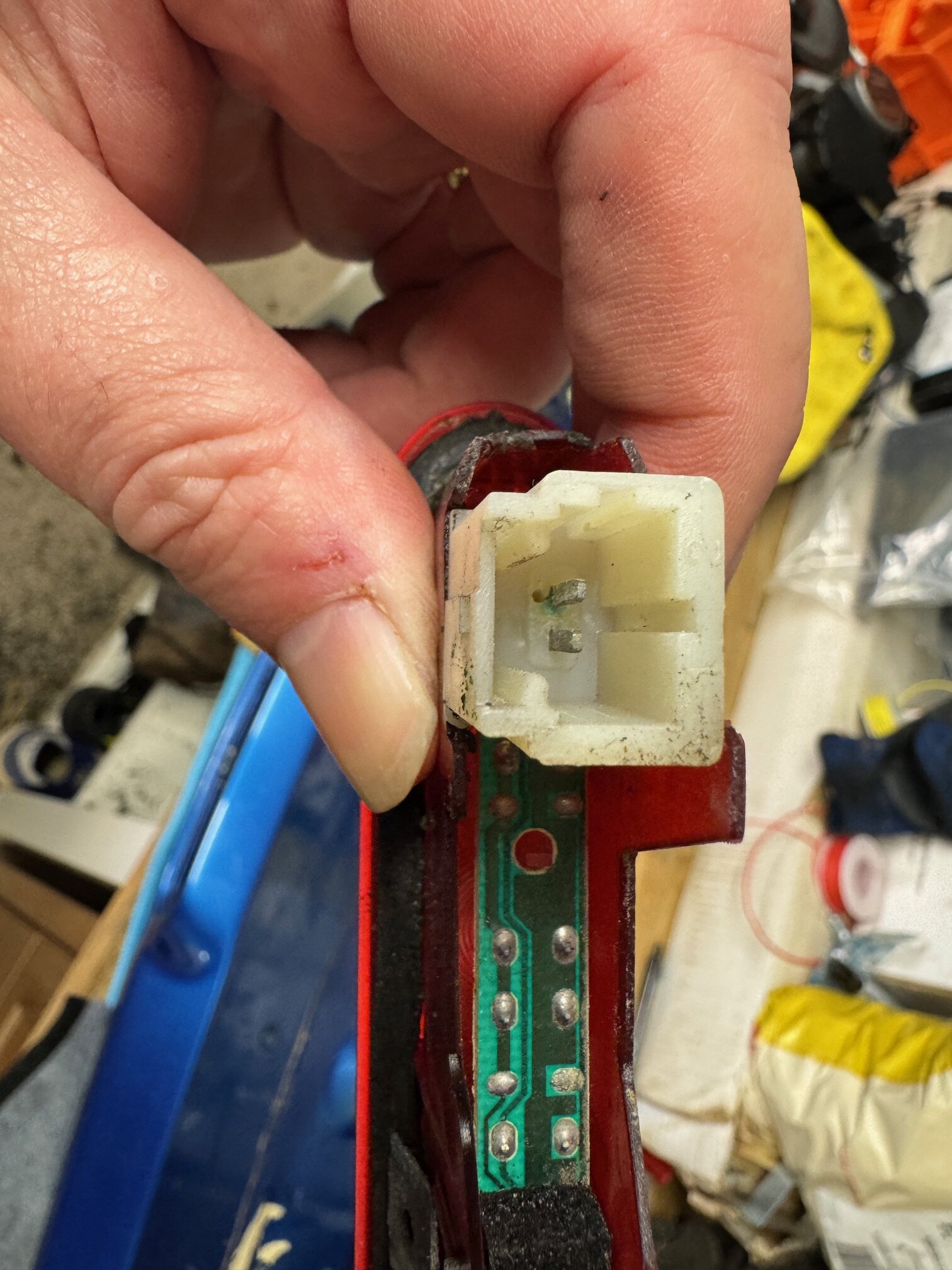

The third brake light didnt work and looking at previous MOT hadnt for some time
I removed the cup spoiler via the 6 torx screws and then measured with the multimeter across the now disconnected connector - 12V.
Must be the light then. Fortunately I had pre-empted this and bought a new LCD strip. I ever so carefully removed the top light and went about changing over the LCD strip. Fairly straightfoward TBH but I took extreme car not to crack the plastic light. These are NLA and I have seen upwards of £100 for them on ebay. Sod that!
Before
During
Some corrosion here but cleaned it up and it made absolutely zero difference
After. It didnt actually take me that long but I went out and forgot to get a pic!

View attachment 1737501View attachment 1737502View attachment 1737503
Where did you get the door check straps from?
I replaced the drivers side one a couple of years ago and that clunks really bad.
I changed the passenger side one a few weeks ago and now that clunks, even after smothering it in lithium grease.
They were both from ebay and none genuine parts.
MRBILLYUK
  FF Jeden Osiem Dwa
Maybe the 5dr Clio uses the same check straps front to back.
I guess that's probably the reason?
The part number for the front is different to the rear.
Front is 7700842857
Rear is 7700842859
If they work, they work and hopefully won't start clunking again after a few weeks 🤞

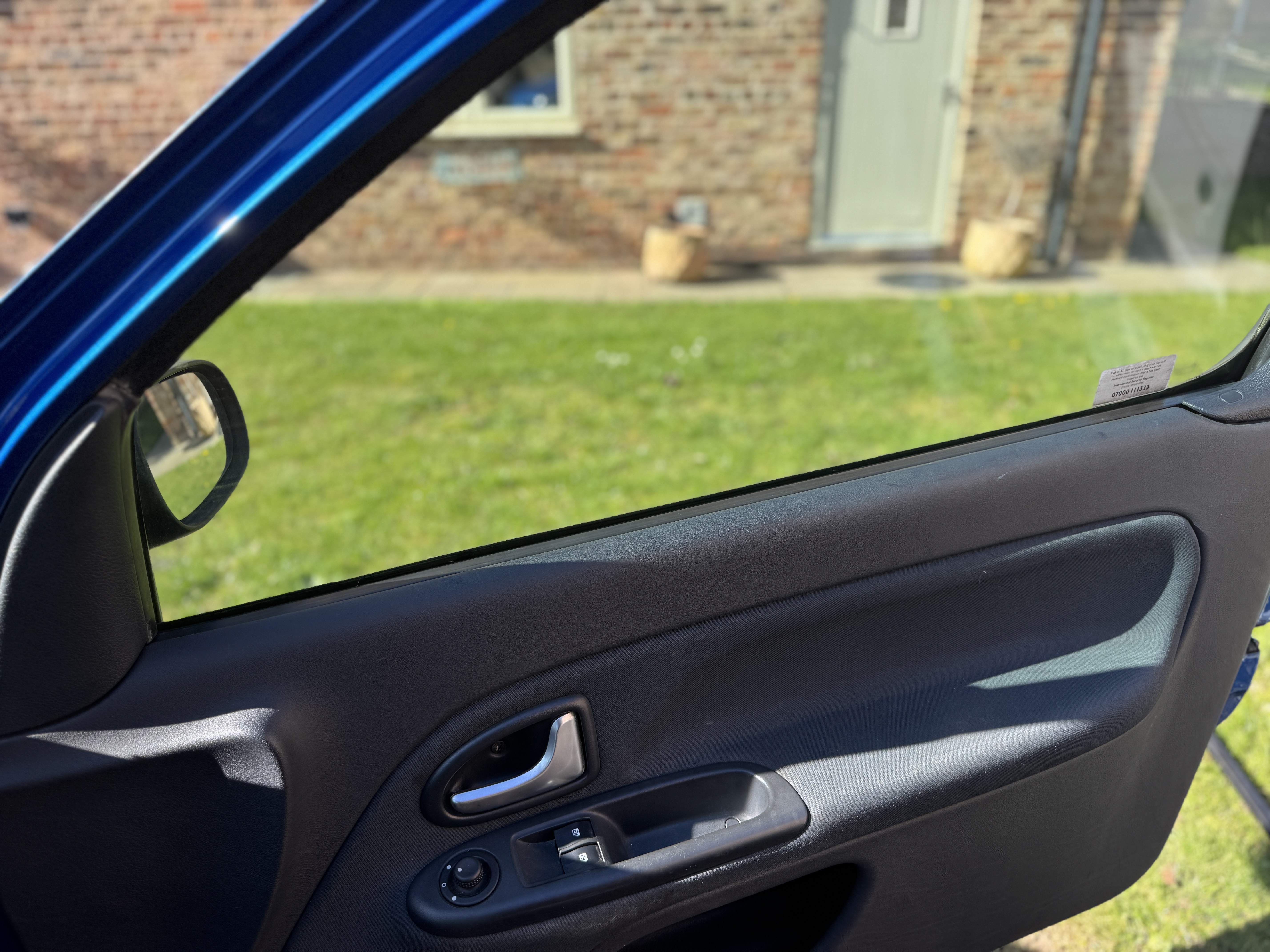

bowen86
Good effort.
You know the drivers weather strip seal at the top of the door you broke. I've done the same and found a replacement.
How does it come off? 😅
andybond
Good effort.
Door card needs to come off.
Pull the plastic quadrant off.
Pull the vertical plastic door pillar piece
Unscrew the door handle. Leave everything attached
Unscrew the electric window switch. Unclip the electric plug
Remove the speaker cover
Remove the 2 torx there
4 torx at the bottom of the door card
Get a separator trim tool and work your way around.
Lift the door card vertically.
Change over the bit your broke.
Refit …

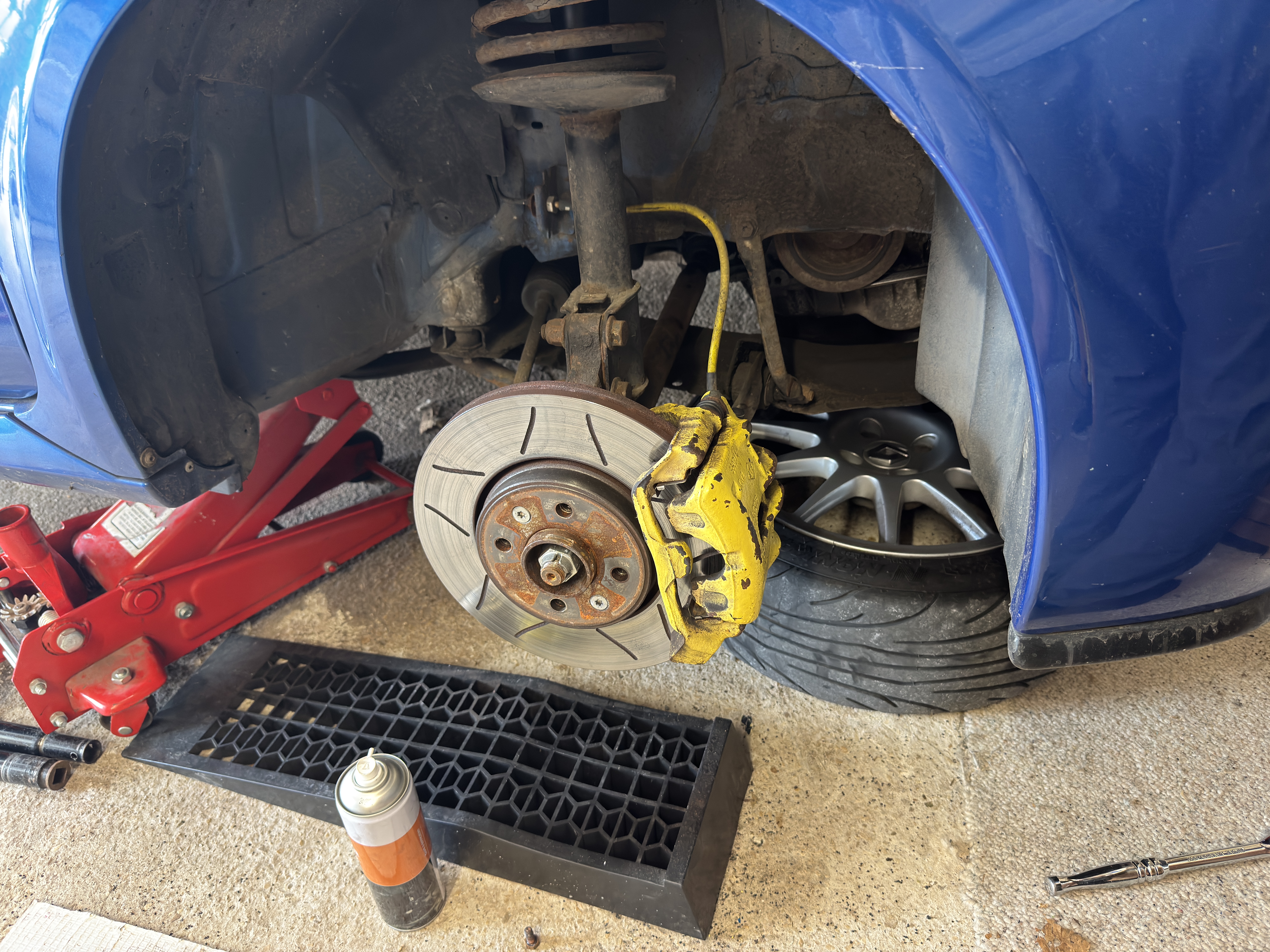

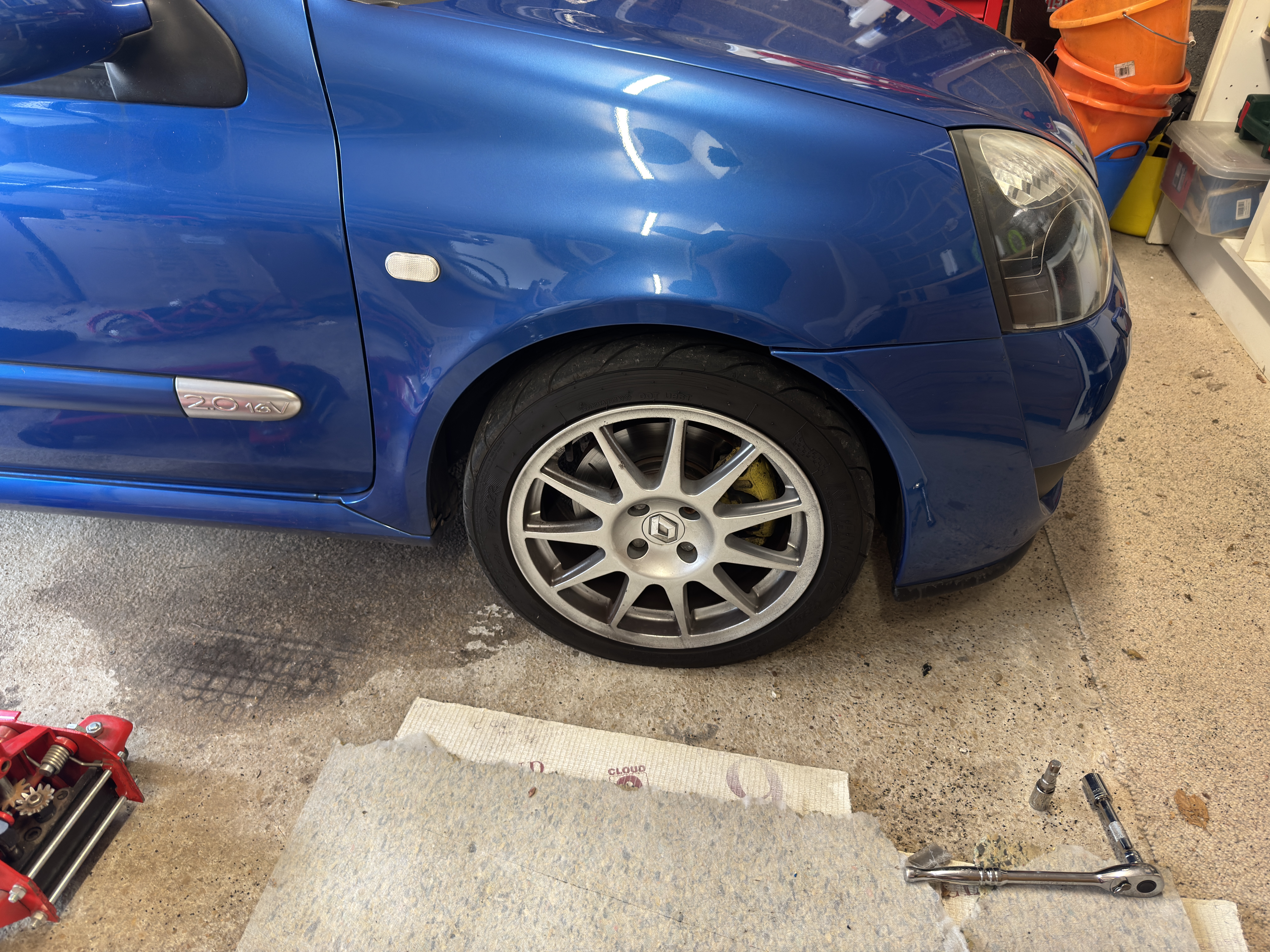

The offside front pads have been sticking. I noticed it , the MOT station noticed it too.
I have today had the wheel in the air, and removed the caliper, cleaned the piston up and noted the pads were seriously uneven in their wear. The outboard pad was wedged in and took some gentle persuasion to come out. The inboard fitted well.
I have filed a small amount off each “ear” on the sticking pad , and swapped it to inboard.
I have been out for a quick spin and it’s better, not perfect. I suspect I’ll have to check all 4 calipers to ensure they are clear of crud.
