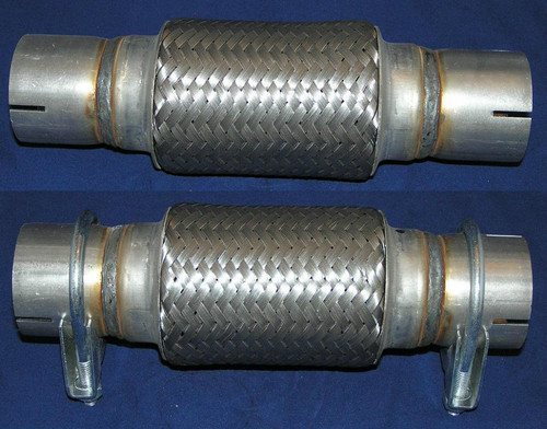

ok, this obvioulsy isnt my exhaust, but a good example :
If you imagine that the clamp was positioned on the end of the pipe and tightened so the slots have narrowed at the end of the pipe but left a hole at the other end. The guy at the exhasut place said that this was where it was blowing.
When I first fitted it, it was blowing, so I assumed the clamp wasnt tight enough. I get the feeling I was never gonna get a tight seal using the U clamp alone. I take it my mistake was the position of the clamp ?
