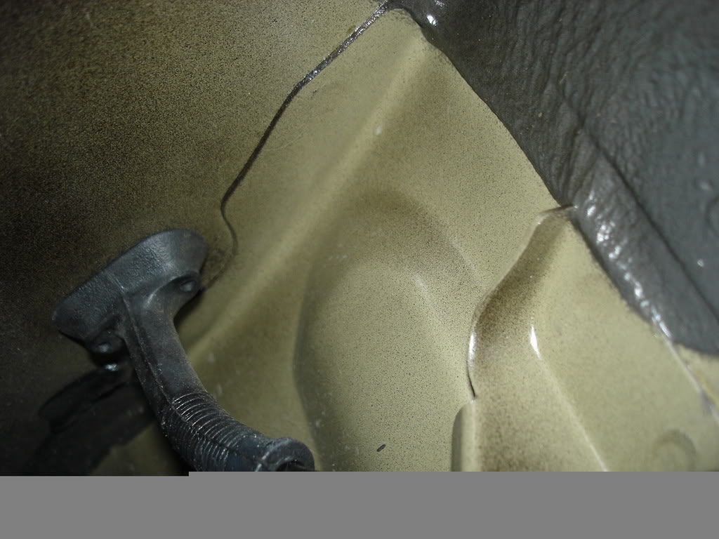

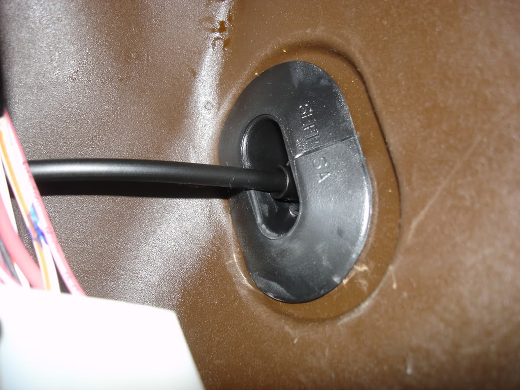

But if you look behind the glove box in the passenger side footwell, the cable for the bonnet pop goes through a rubber grommit into the bulkhead. You can feed the battery cable through there.
look for this gromet for bonnet release cable. pics below of inside footwell and outside firewall...
