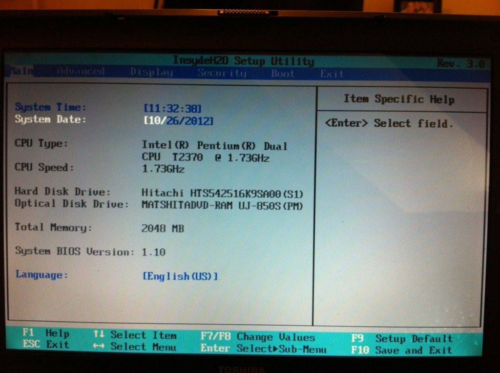

I've been messing about with the laptop this morning. I've got into Toshiba's set up utility and it's displaying the HDD as if its being recognised. I've taken a picture of the screen;

That is the BIOS btw.
i expect you will be able to retrieve data from it, but it may be a bit flakey and randomly drop out. Best thing to do is get a connector to plug it into a laptop usb port and see what happens.

On the screen shot, it shows I have 2050 something MB. Would that be some of the space on the hard drive?

Sounds promising, I'll have to wait until the transfer kit arrives to know for sure.

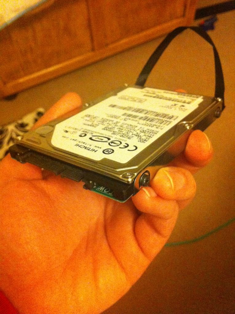

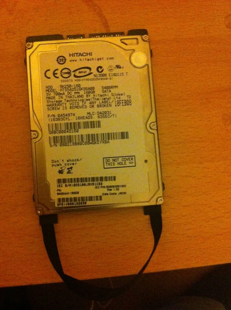

Some pictures of the removed HDD;
As far as I'm aware, this is a hitachi 2.5 inch SATA 160GB HDD.
Is that correct?
