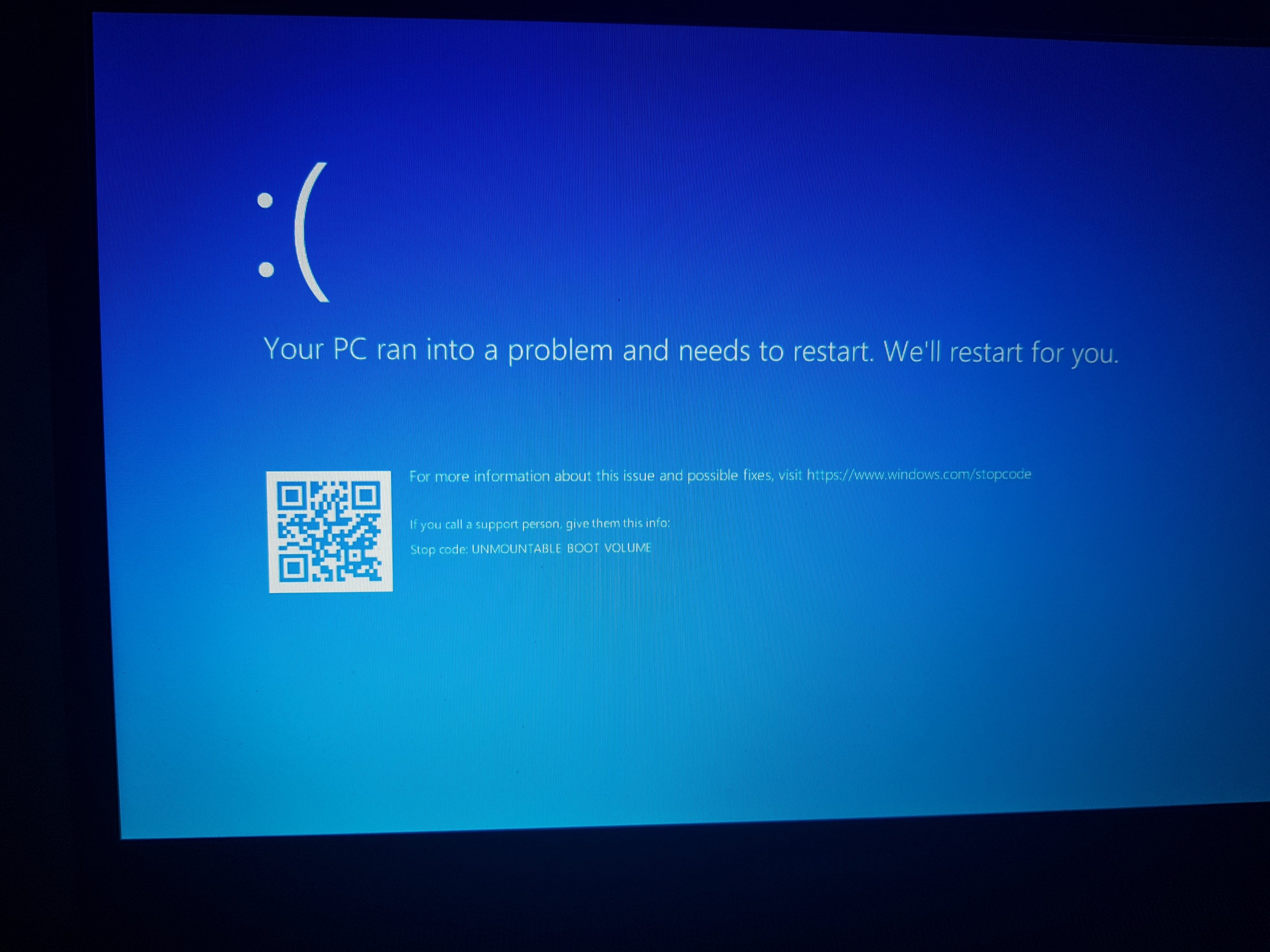

Having problems with my Laptop booting up.
Once power turned on & after a minute or 2 i get this blue screen come up.
Not great with PC's,Laptops etc so i have no idea on why its doing this,it then goes into restart on its own and just seems to be a blank screen.
Its running Windows 8 if thats any help,Thanks
Bugger.... that looks like the hard drive is failing or has become corrupted :(

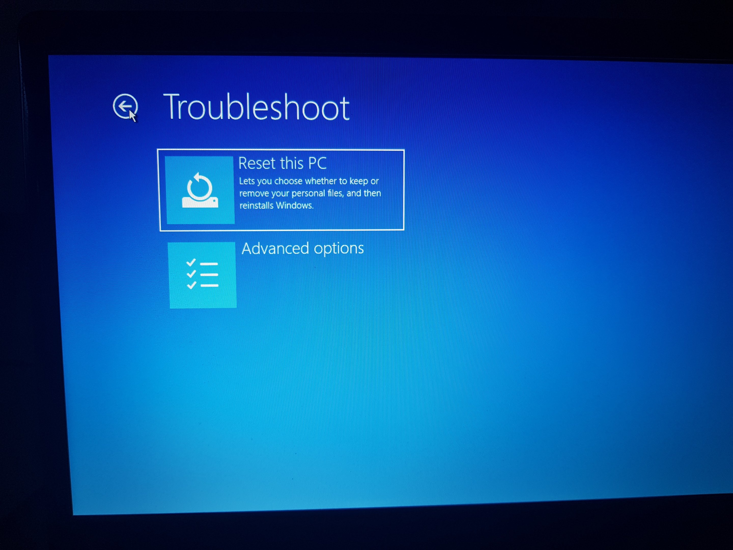

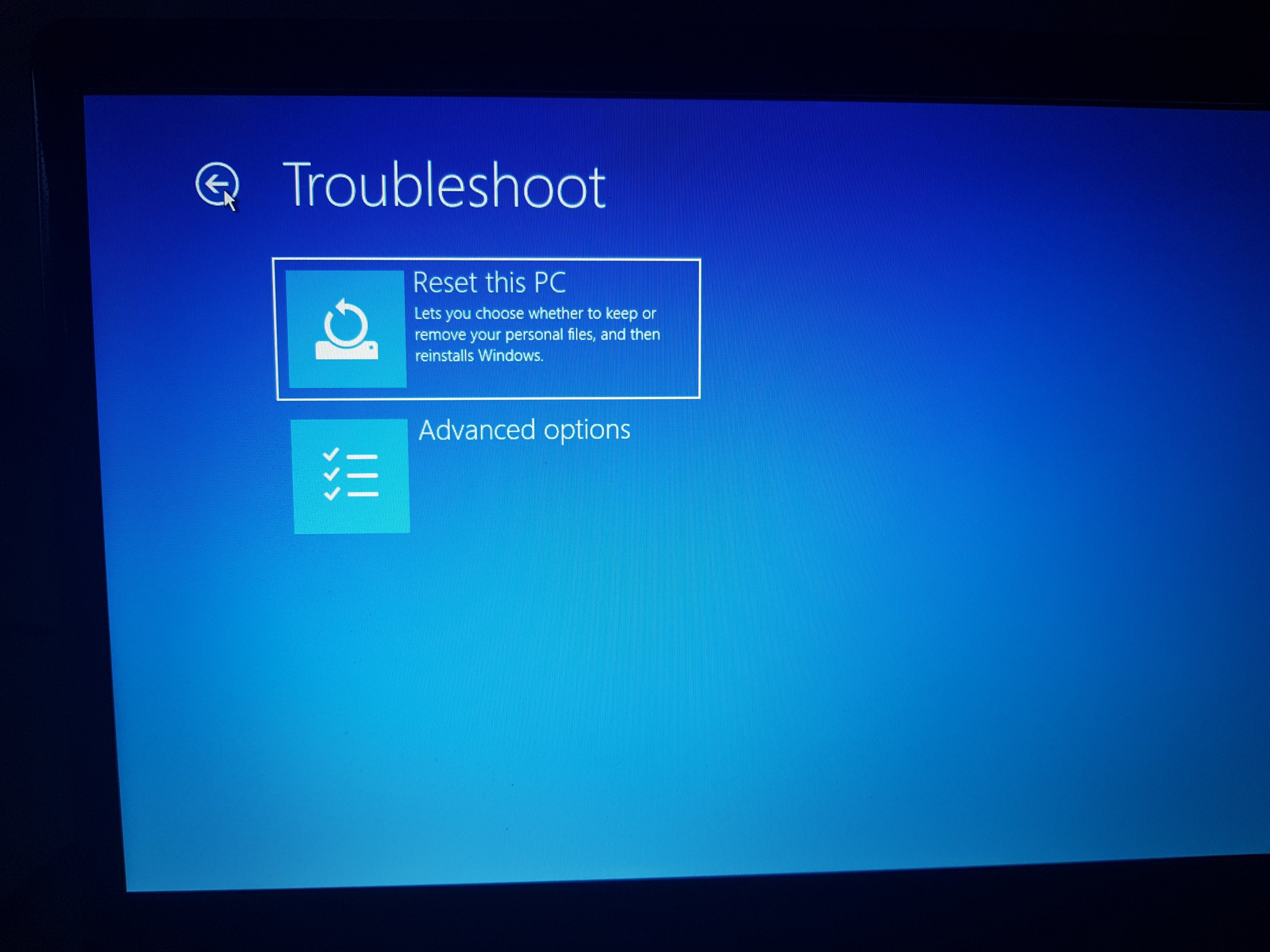

No luck with the F button mate,just goes straight to the blue screen then tells me going to restart and may take over an hour to fix.But it seems to still just be repeating itself,diagnosing Your PC blah blah.Prob have to take it into to get looked at
Buy a cheap ssd and a hdd caddy, swap the drive and reinstall windows, then stick your old drive in the caddy and recover your files. Easiest way imo if you want you files.
Or... if you have access to another computer download the latest Hiren’s boot disc, create a bootable usb, boot to that, recover your files and then choose the reset pc option to restore it

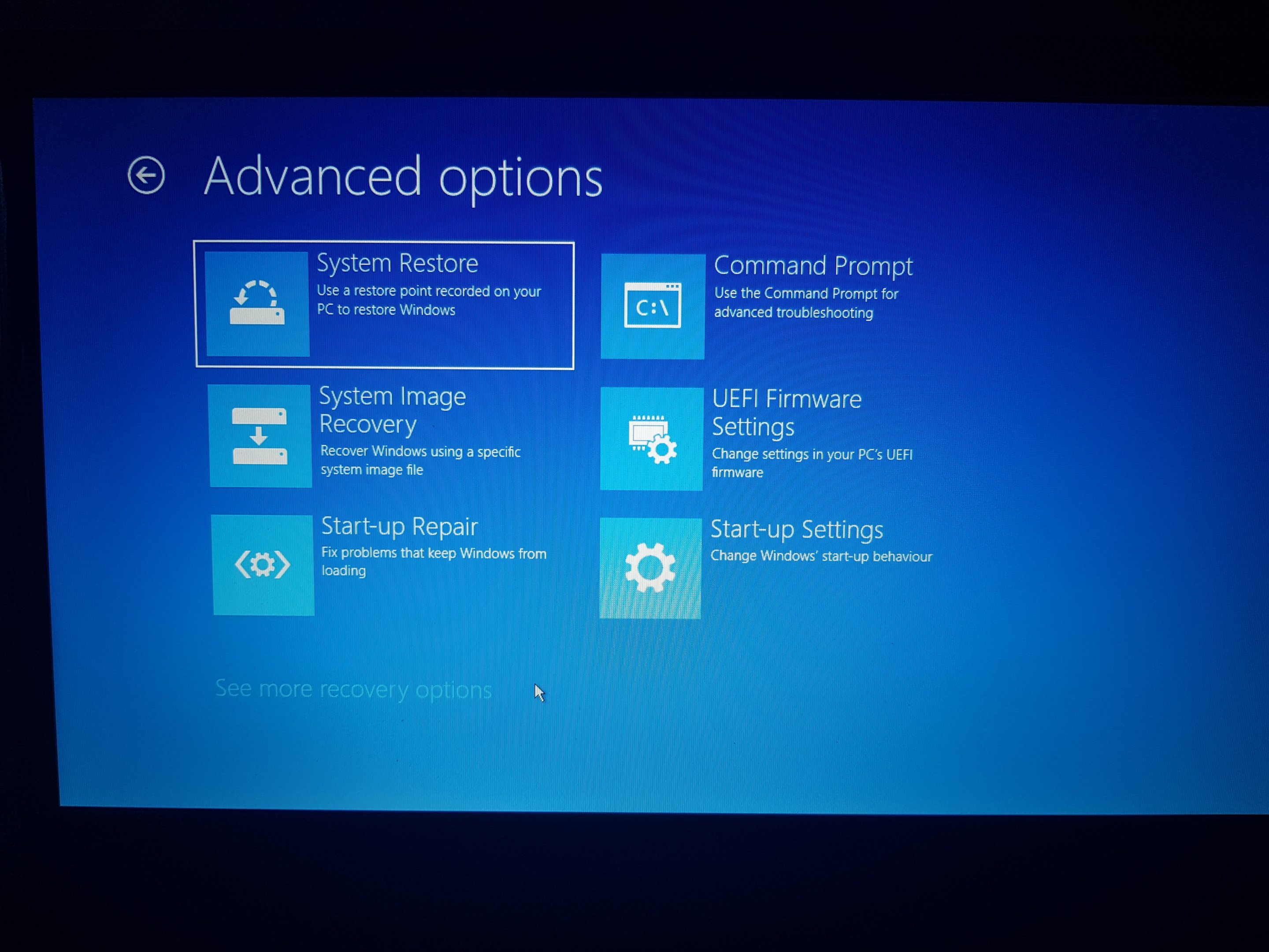

Sorry, was really busy yesterday so didn’t get a chance to reply. Try going to the command prompt option and then type this:
Chkdsk /f c:
That will scan the disk and try to fix errors. Will probably take a while. May not work as it sounds like the system may have already been trying to do it, but at least this will give you a clear indication. Snap a picture of the results and post it up.
F8 on boot doesn’t usually work with windows 8, but all it would have done is got you to where you are now.
Worst comes to worst you’ll need to buy an external disk and copy your files over to it and then replace the drive in the laptop - it’s genuinely not difficult to do, but if you can’t be arsed with the hassle taking it in to a repair place would certainly be the easier option. Let’s see how the disk check goes first.
