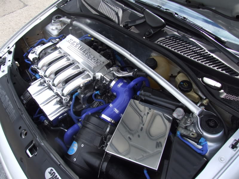

  PH2 172
I have this car...
And this week i'm going to clean it all up ready for the summer. What polish is best to use? I've briefly tried AG SRP but it did absolutely nothing.
Is there a specific product to use??
Moochas Grassy ass.
Is that a picture of your engine bay looks really nice who did all the chroming and how much did all that cost you cheers
  PH2 172
ow i must say it looks really smart wouldnt mind doin my cups engine bay like that anyone on here know where i could get that done and for how much?
